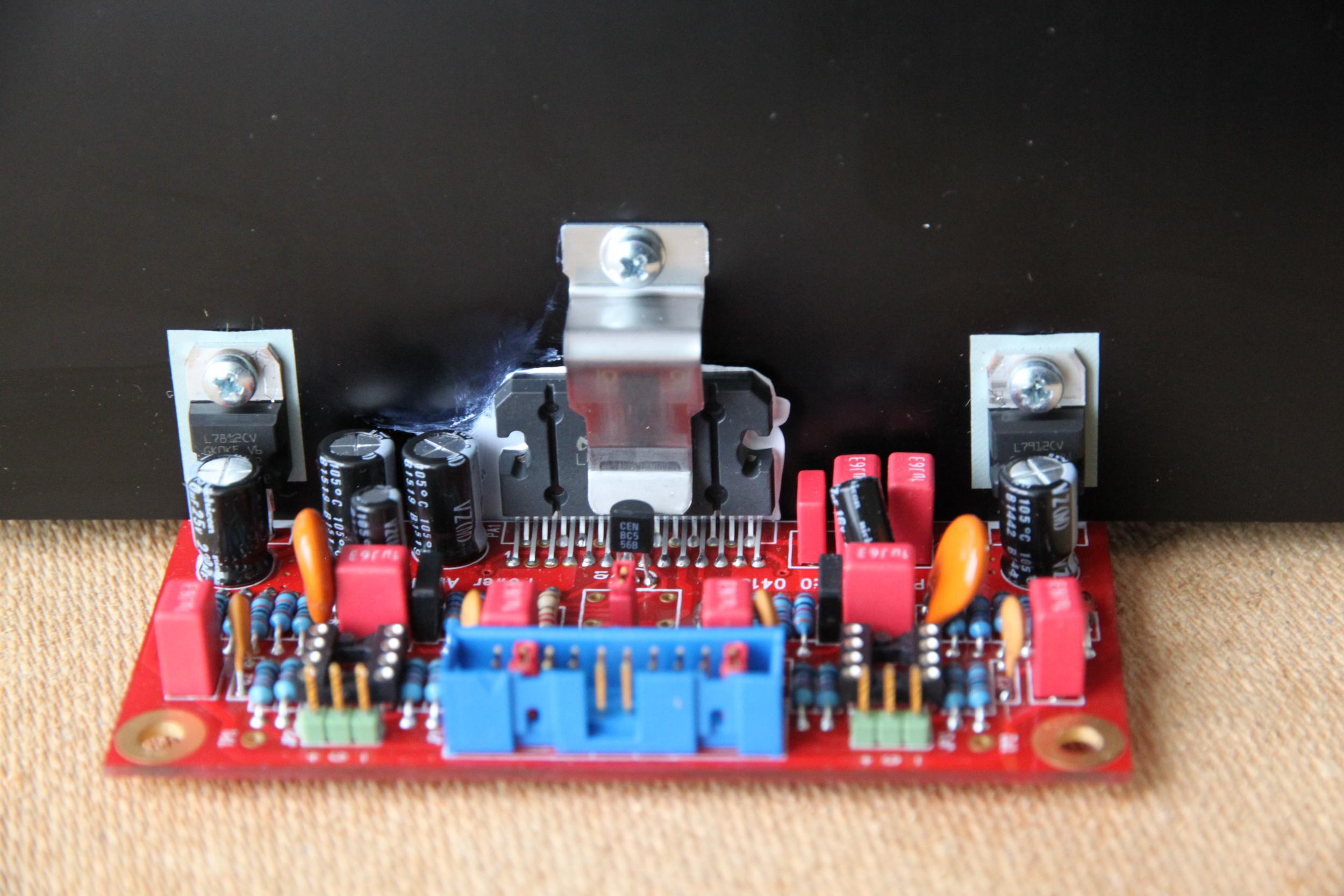

Okay So I joined the group buy and a few weeks later a beautifully designed board dropped on the doormat. Ok what now, First I needed a case for my build. Then I saw the case build by philbool (See the post "My first gainclone"). Wow what a beauty is that. As I have no access to CNC tools and a custom build would be too expensive I decided to look for a second hand amp case. I checked the local thrift shops and websites for second hand electronics. And then I bought this old Pioneer M10X power amp. It seemed suitable for my purpose. But now what ??? As a genuine newb I have no tools at all, no DMM no soldering iron, no nothing !!!!! Mmmmmmm, time to think about it.
To be continued ......
In the pictures the new home for the PA03 and the PA03 board.

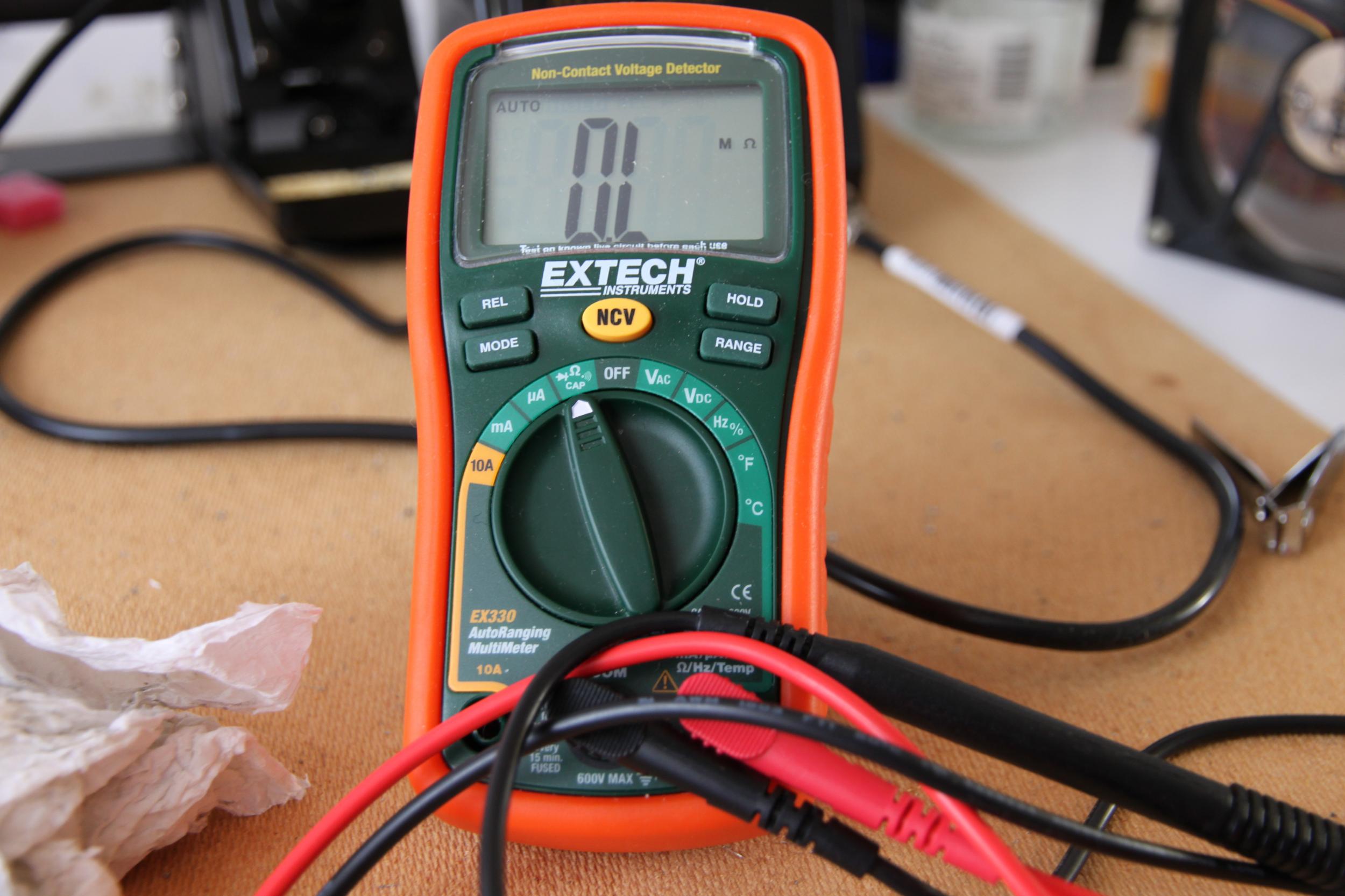

A digital multimeter seems to be a necessity. Experts told me Fluke is the way to go. They are accurate and will last a lifetime. But for me way too expensive. Then I saw on Youtube EEVblog #91 on which Dave Jones gave an interesting kind of lecture on multi-meters. He made a recommendation of the Extech EX330. So I bought it.

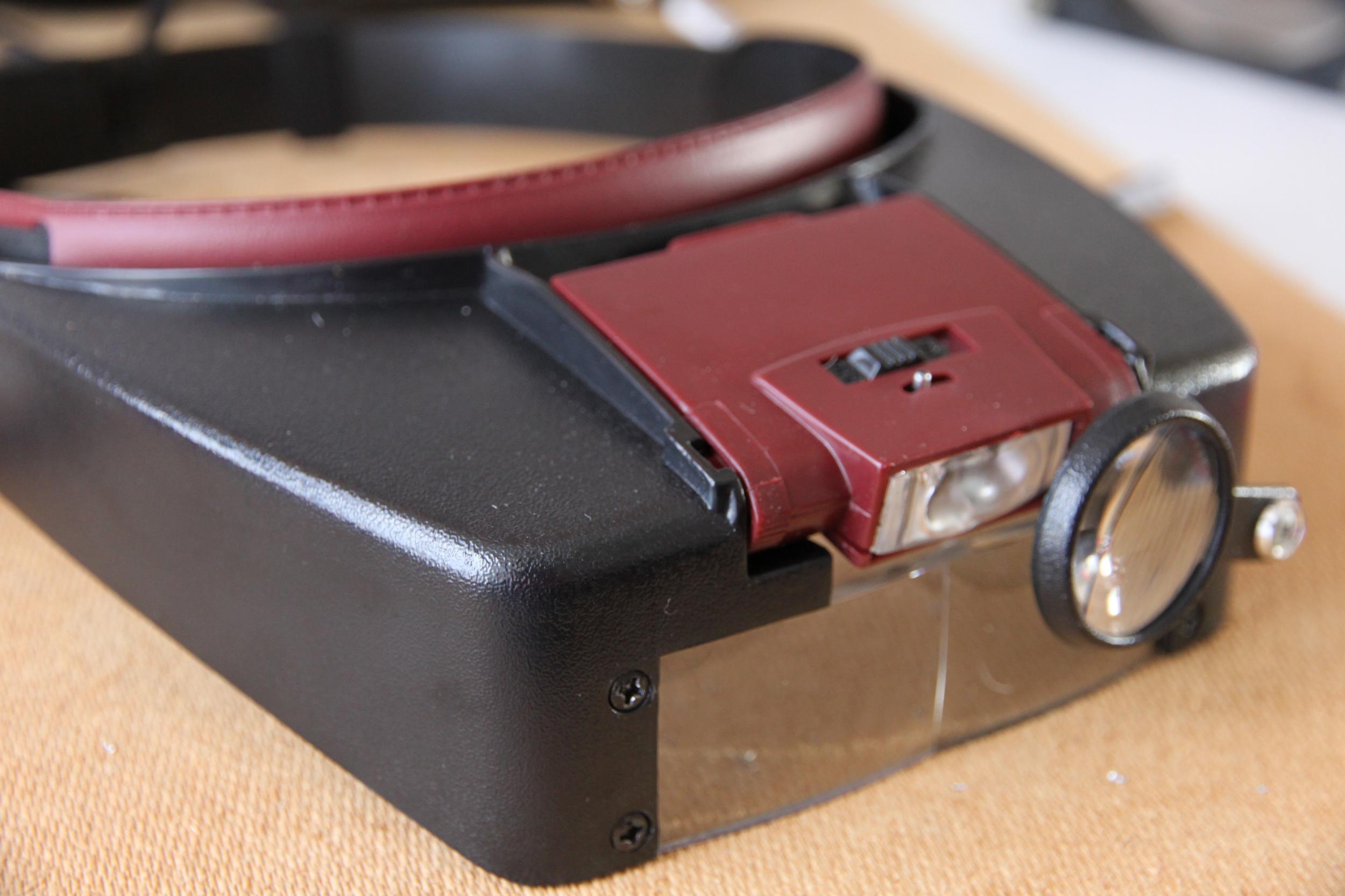

The parts on the pcb are very close to each other and it is easy to create unwanted solder bridges so I needed some magnifying loupe. For this I bought the Velleman VTMG13 headband loupe with integrated led light. Magnifying factor 0.375x - 0.75x - 2.125x - 2.5x.
For just 15 euros a very nice and handy product with a reasonable build quality.

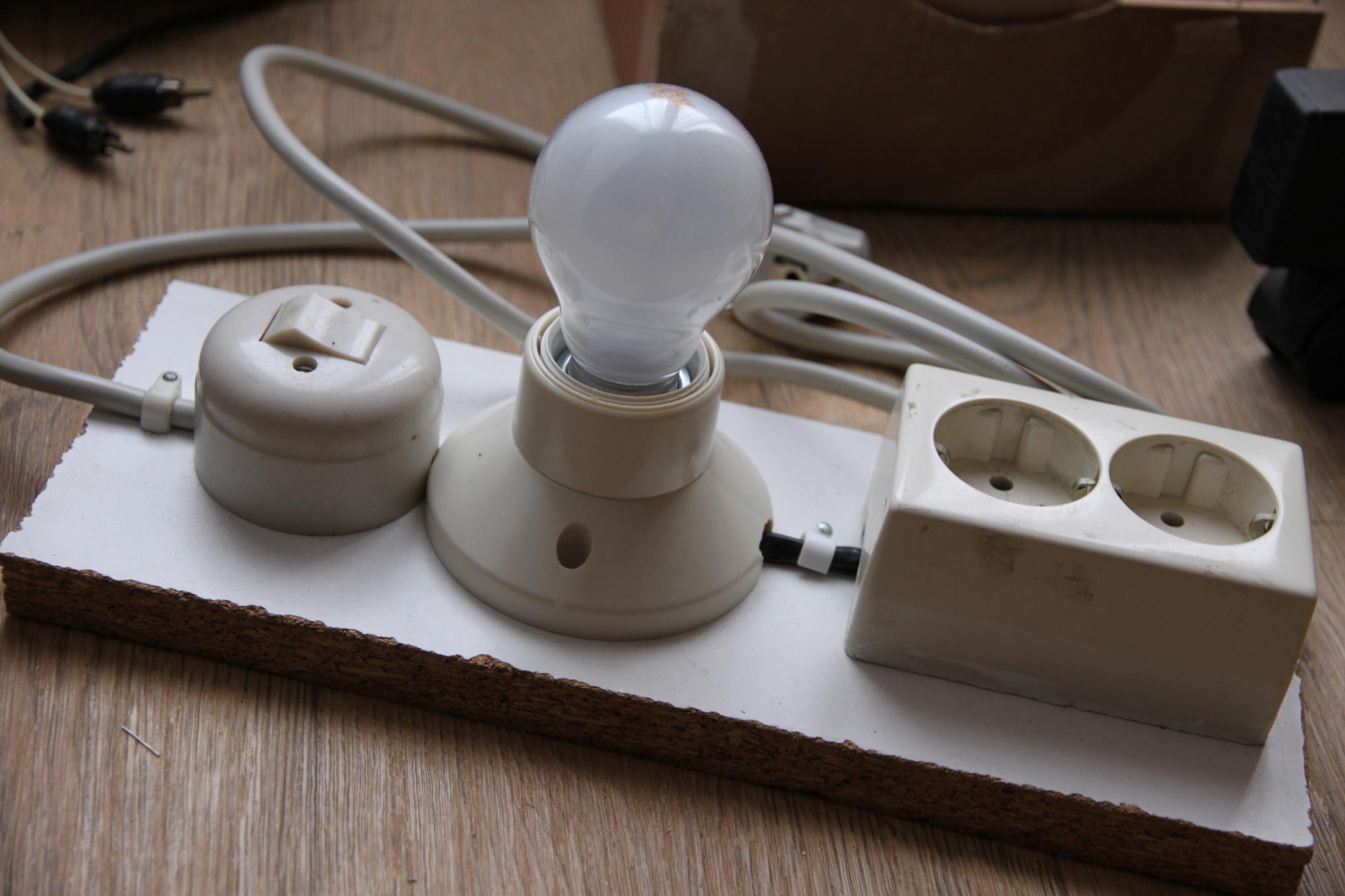

In reaction to my post AndrewT advised to build a Mains Bulb Tester. Google is your friend and on Dim Bulb Tester for your amps and other electrical equipment • www.cab1net.com I found the answer.
Old equipment as well as newly built ones can be tested with the Dim Bulb Tester. It can save you a lot of headaches from sparks or blowing up fuses and parts because once there is a short, the Dim Bulb Tester will absorb the current and light up brightly. If all is well, it will lit up dimly and you can actually power up your equipment while plugged into this tester.
Thanks a lot AndrewT I think this is just what I need. In the PA03 build guide Pavel advised to gradually increase the voltage for first startup. I think Pavel Dudek meant to use a variac which I don't have. I hope the Bulb Tester will do instead. Yesterday I had some spare time and I built one.

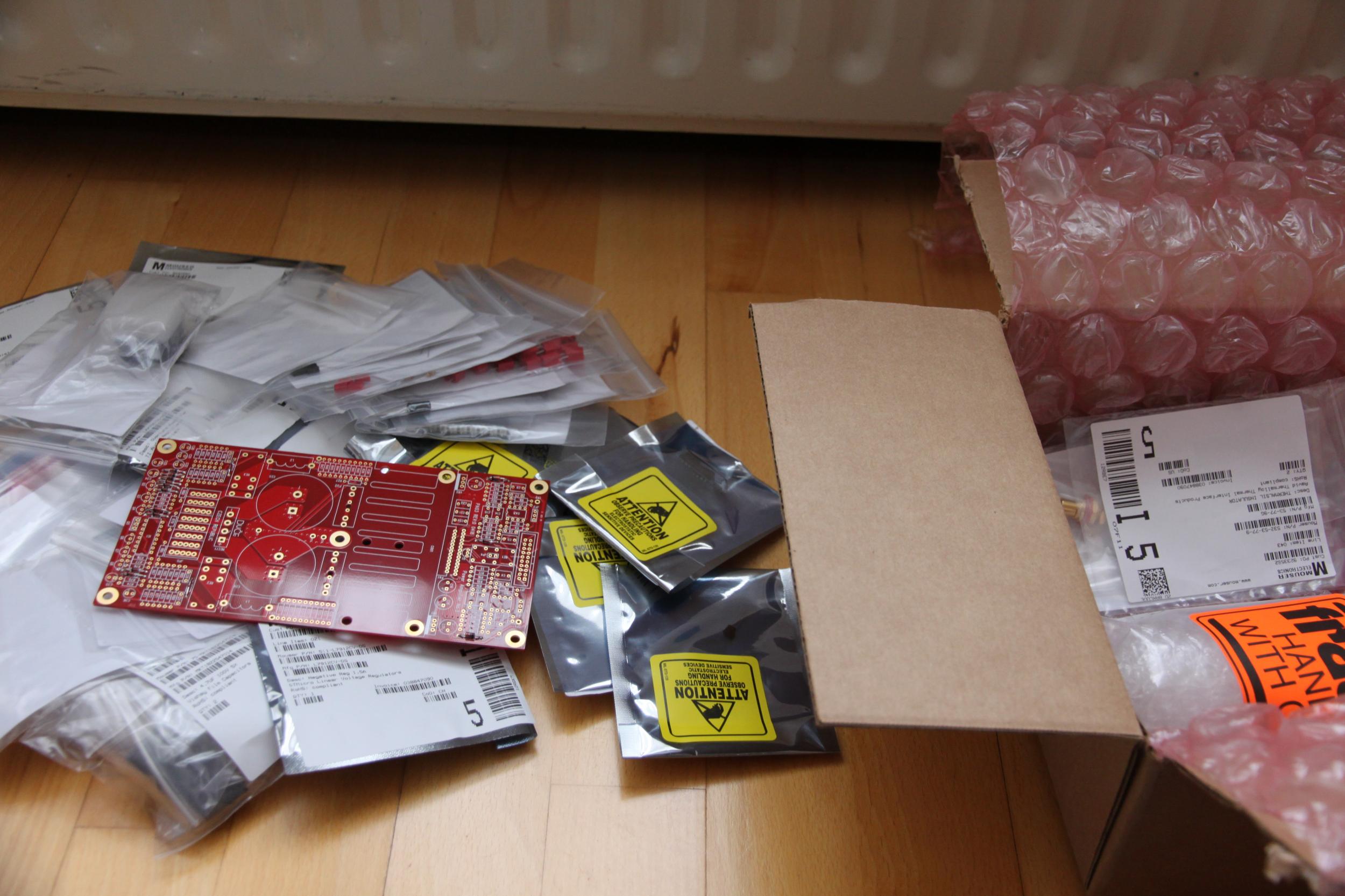

Okay A case is bought, soldering iron is warming up. Time to order the parts. Peranders offers a PA03 Bill Of Materials (BOM) for three suppliers, Elfa Distrelec, Mouser and Farnell. Mouser is the most to my liking. It has a huge collection of parts, a nice website. It's easy to get access to data sheets and what's more most components can be ordered in small quantities.
Mouser has BOM import tool. After some fiddling it is rather easy to import the provided BOM. Tip: It will not import unless you remove column G (Note). After import Mouser shows a long list with part numbers found, but also with several Parts Not Resolved. For instance Mouser part number 511-4020 described as “14-stage ripple carry binary counter” was designated “Obsolete”. Now for a newbee like me searching for compatible parts is a daunting task,. Happily Mouser makes suggestions for alternatives. Mmmmm, worry , worry. In this case I ordered part number 595-CD4020BE “TI Counter ICs 14-Bit Ripple-Carry”.
Right or wrong: Perhaps someone can help me out here ??
For future builders it's useful to know there is a small typo in the build guide. On page 3/9 chapter “Power Amplifier” Pavel mentions the value of capacitor C14. He has acknowledged that it is in fact C15 he is talking about. So for a normal stereo box the value of C15 (and not C14) has to be 47uF. AFAIK BOM and schematic are correct.
After a short while Mouser delivered my order. Nicely packed with a lot of small bags each labeled with information about the contents of the bag. Sensitive components packed in anti static bags. For all the experts here this is nothing new, but remember newbee here!!

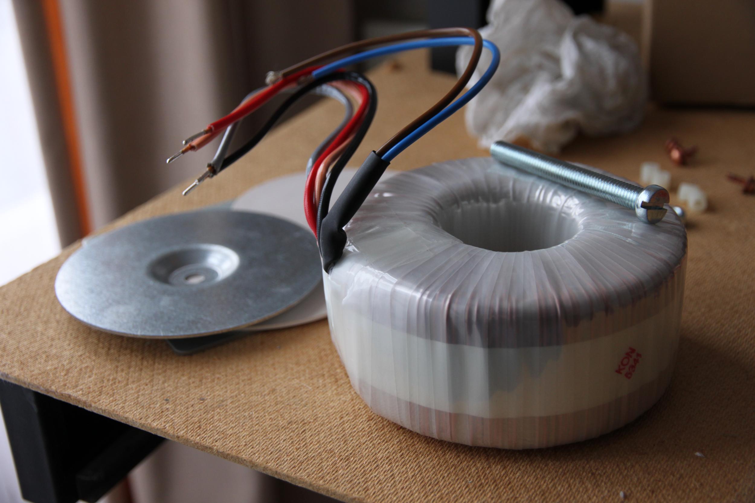

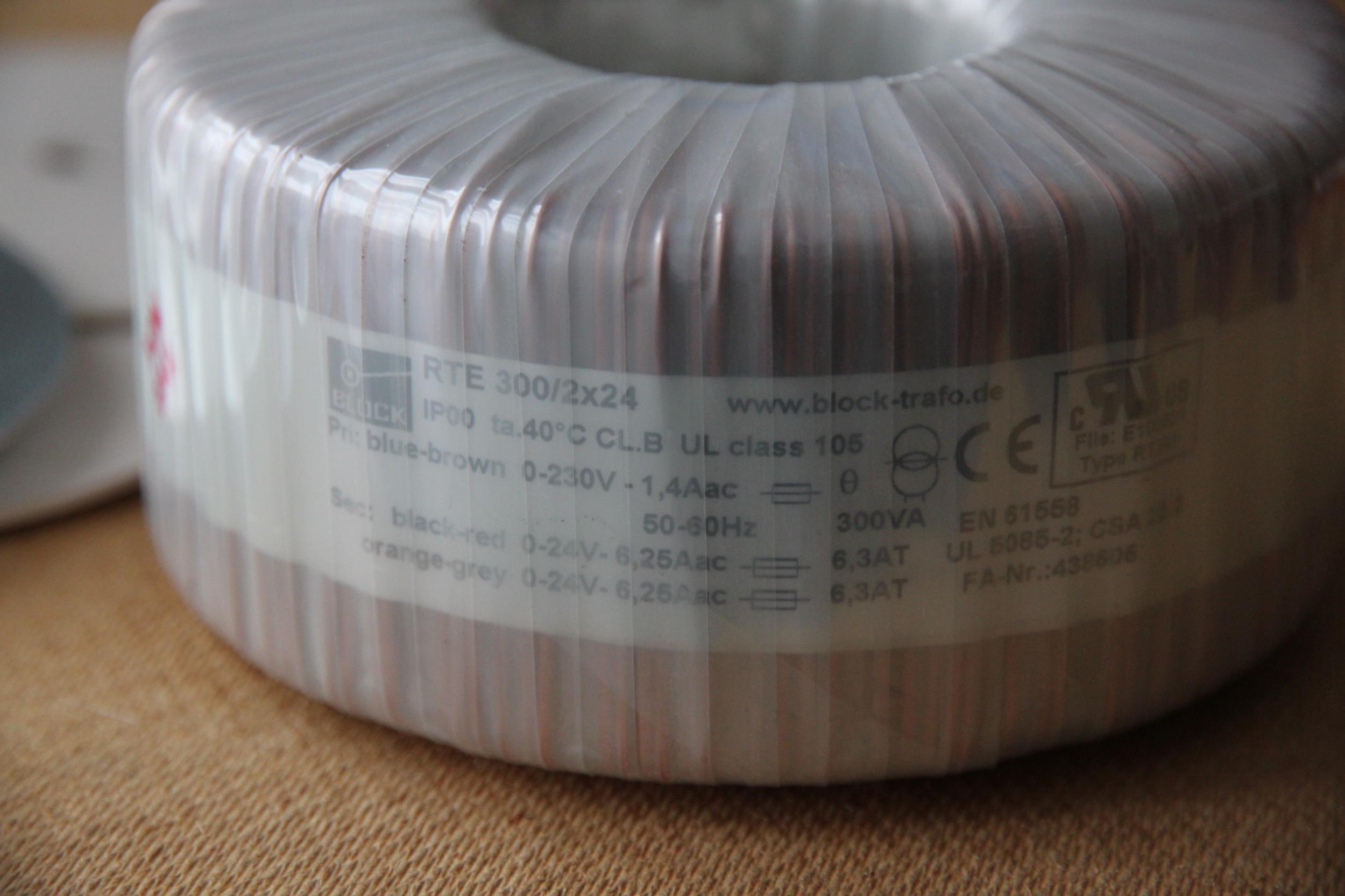

The transformer I have chosen is a toroidal German Block 2X24V 300VA. Perhaps more power than needed for this amp. But when I get the hang of building an amp perhaps there are other designs to try. BTW didn't know a transformer like this is so bulky and heavy.

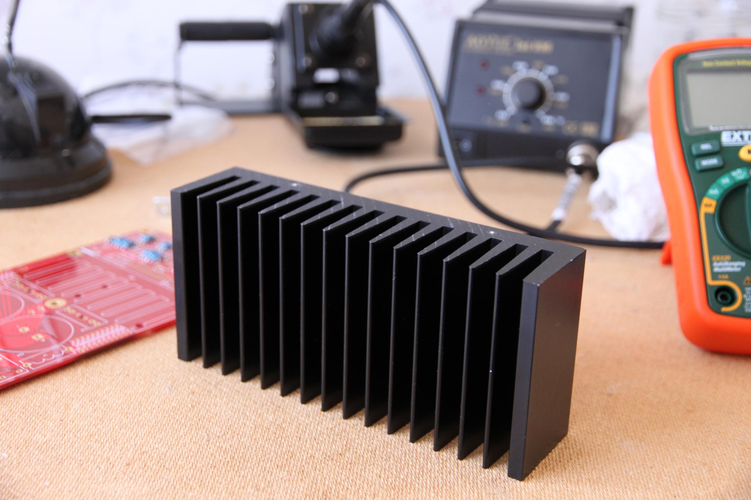

Pavel Dudek advises a Pada heatsink of 100x100 mm with 40 mm ribs and thermal resistance of 1,60 C/W. Unfortunately this sink will not fit in my case so I had to look for an alternative. I have chosen a Fischer heat sink type SK 85 75 SA. It measures 160x75 mm with 40 mm ribs. It is black anodized and has a 10 mm baseplate. According to Fischer the thermal resistance is between 1.35 – 0.6 K/W. I think the effectiveness of the heat sink will also depend on the way I mount the LM4780. Again a lot of things to ponder.

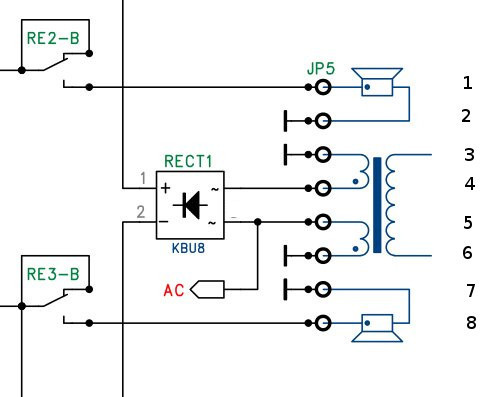

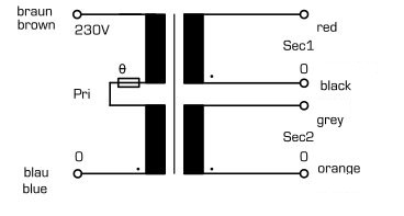

So I thought better be careful here. I checked the PA03 schematic in combination with my 2x24V transformer on how to wire. Attached are pictures of my transformer and the connectors on the board. As newbee it looks so simple to connect:
- red wire to point 3;
- black wire to point 4;
- grey wire to point 5;
- orange wire to point 6
But isn't that a short in 3 and 6 ??
or do I have to connect the center taps different ?
- grey wire to point 3
- orange wire to point 4
- red wire to point 5
- black wire to point 6
Dear experts please help me out here ?

That is a terrible way to show the wiring of the transformer secondaries to the rectifier and smoothing capacitors.
They are misusing the ground symbol and showing everything connected to some general "ground".
That is NOT the way one builds a Centre Tapped transformer into a dual polarity PSU.
The Centre tap must connect to the centre point junction between the two smoothing capacitors. CT DOES NOT go to ground.
Get some better PSU tutorials. Start with ESP and TNT.

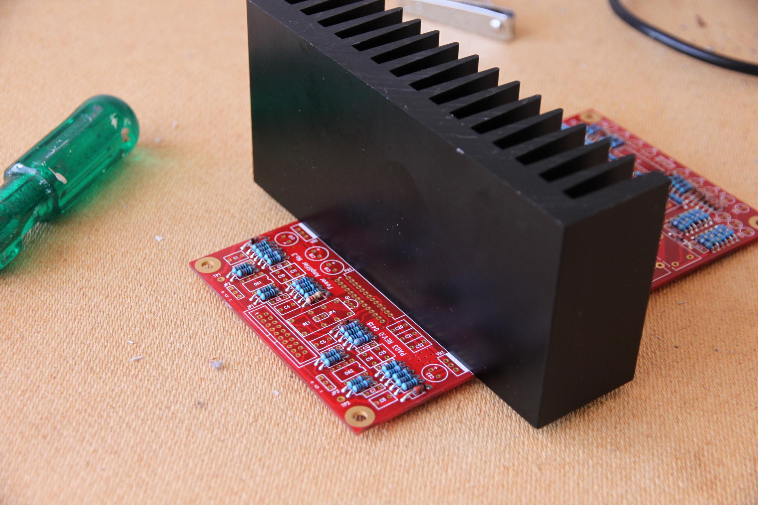

For me the build got tricky when I had to attach the heat sink to the board. The correct placement of the heat sink is important. A big help is that a profile of the sink is outlined on the board. If the base of the sink accurately follows the line on the board the 27 pins of the LM4780 are almost sliding into its mounting holes. And I tell you the pins are really tiny and you don't want to fiddle with them too much. The back of my LM4780 is not insulated so I had to choose to insulate or not. I choose not to in favor of a better heat transfer. As the LM4780 cooling surface is connected to the negative power supply you have to be careful when mounting the board in a case. When the two voltage regulators are also attached to the heat sink they have to be insulated.
I am a little bit of a control freak and a newb so I put a lot of thought in the way to attach the LM4780 to the sink. The standard way to mount the chip is with mounting screws. However I was afraid that a small mistake in drilling would give me a lot of problems getting the chip in place. Therefore I chose the spring clip from Fischer Elektronik (THFM 1) and this is really a recommendation. Very easy to fasten the chip.

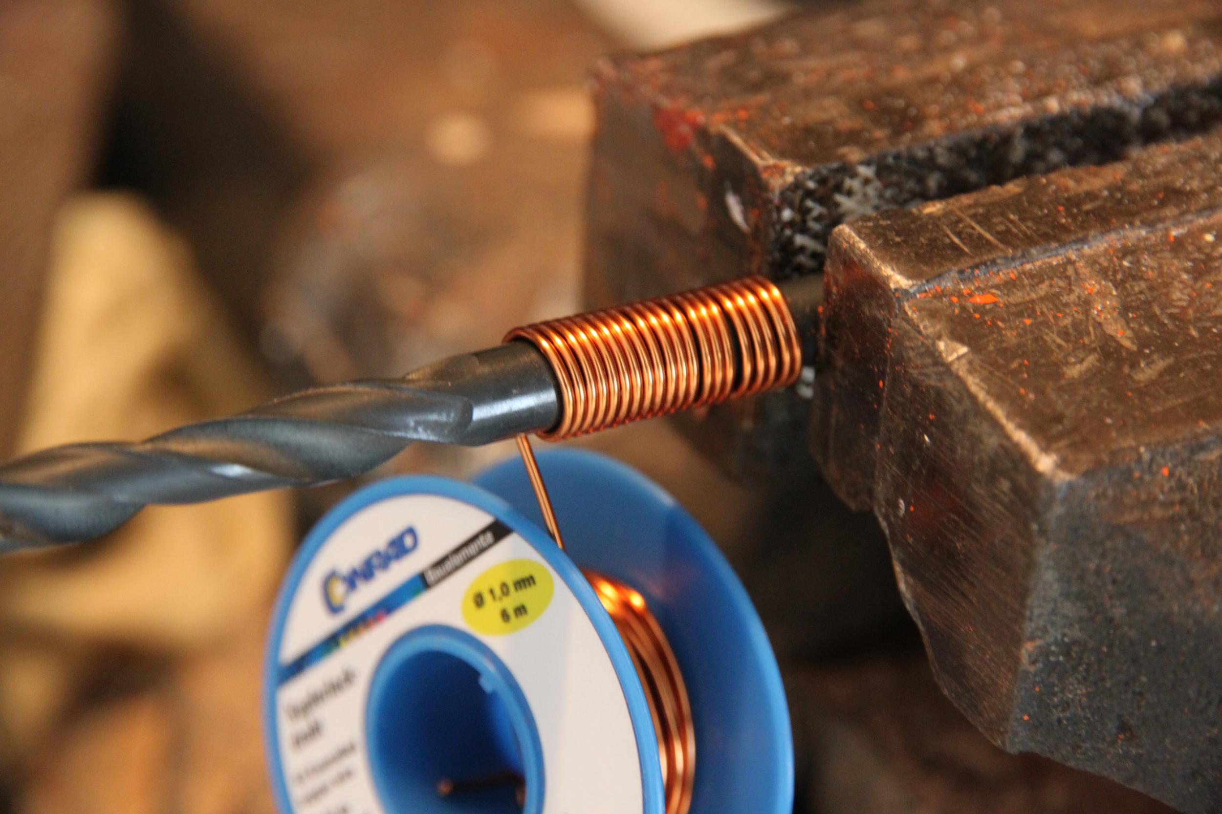

The two inductors on the board were wound by myself. For the parameters I used the Air Cored Inductor Calculator. Air Cored Inductor Calculator | M0UKD – Amateur Radio Blog About twenty turns of 1 mm enameled wire on an 8 mm drill. Don't forget to scrape of the enamel from both endpoints before soldering.
For me populating the board was really fun. When possible I measured every component before inserting it into the board.
in the pictures: Correct placement of the heat sink, Winding the inductor, spring clip on the LM4780
