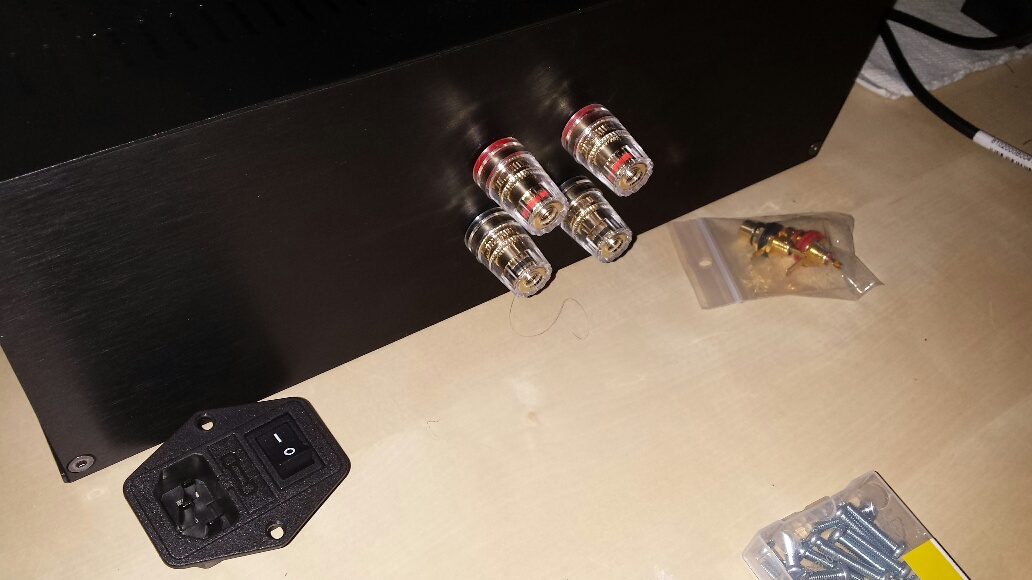

Daanm, you won't be disappointed on any of the modushop stuff. Even their lower priced stuff is really top notch, but the aluminum top and bottom plates are worth it. I spent too many hours searching for a good source for chassis and won't bother looking anymore.

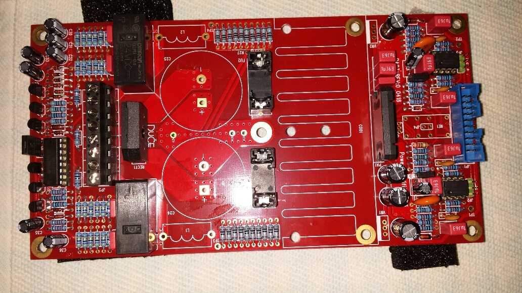

I think I am close to "finished". Finally got myself some 1 mm wire for the inductors.
Hi Clog: Can you please tel me how many windings I need?
After bolting down :) the heatsink, I am going to make the "bulb tester thingy".
Plan; did it work out? What is your conclusion/opinion?

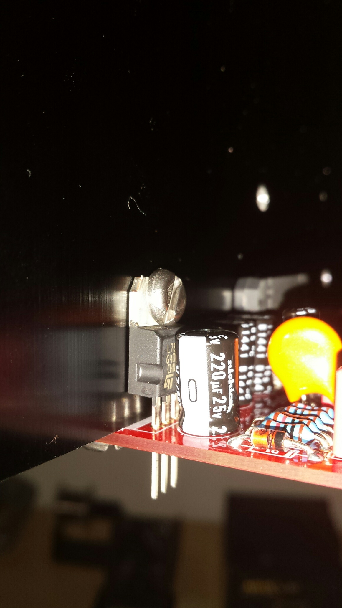

Hi Clog (and others), I just drilled some holes for the chip-clip and the two voltage regulators. But I was a little bit too much in a "hurry" (probably because I was so eager to get going again). So I also tapped m4 thread for the two voltage regulators and now the screw head is a little bit big and touches the regulator. Can that be a problem?

Can you attach a picture? Did you get a full package vreg or a bare one?
Cool. As discussed earlier in this thread, my OCD would drive me nuts and I'd probably want to find a screw with a smaller head. Buuuuuttt.... It *should* be fine I'd think.
Is it flush against the heatsink? You need to make sure its making contact and insulated against the heatsink.

Daanm that's DIY. Things go wrong sometimes. As far as I can see from the picture It seems to me that the size of the screw head isn't a problem here.
But you have to be absolutely sure that there is no electrical contact between the bolt head/shaft and the metal tab of the regulator. Check with your multimeter. Don't forget to mount the tiny shoulder washer and the insulator pad that came with your BOM. This washer insulates the head of the bolt from the tab of the regulator.
There is another option. If the legs of the regulators aren't clipped yet it seems to me that you have enough room to drill new and smaller holes and mount the regs somewhat higher on the sink. This option is especially for the OCD types here.
Thanks Clog, so that is what i did. (thanks for the advice) I made 2 new smaller holes a "somewhat" higher...... but I am really embarrassed to admit that my "somewhat higher" was a little too high. :( . The legs of the regulators barely peeked through the board. Not ideal. So thanks (again!!) for the pm as I am now going to use the initial large m4 holes and set in m3 screws + a tiny nut on the other side. Yes I am so "lucky" to have those holes in between the ribs....... I was sooooo very close to get myself a new heatsink :grumpy:
