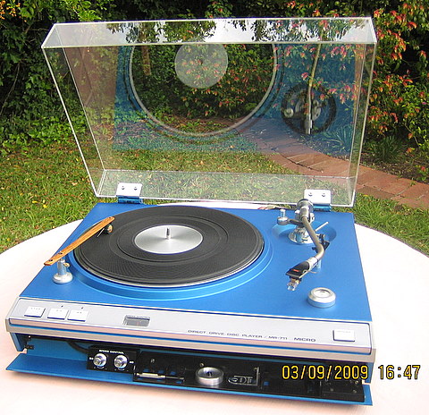

I've been following this fascinating thread as I'm totally new to DD technology. I have recently acquired my first dd turntable - a Micro MR-711 circa 1974. I have no speed or speed instability problems and would like to know (if you have the time), if there would be any major differences between the SP10 family of dd systems and that of my oldtimer Micro?
I got some translated blurb from Audio Database regarding the Micro's drive system"
"The direct-drive scheme using the DC servo motor by an electronic-circuitry control system is adopted as a drive system. The meter scheme of electronic circuitry adoption is adopted as 1/3 or 45rpm velocity checking. The zero point adjustment on this meter is proofread so that it may be in agreement with a constant-speed degree rotation of a motor using a frequency counter, and it is pursuing the accuracy more. Moreover, 33.3 speed control organisation in which 3 or 45rpm became independent, respectively is carried, and +-6% of fine tune is possible to a convention velocity".
What do you think of all this? Does the Technics system have any relevance here?

I think what they might be saying in the Japanese-English is that the speed setpoint is calibrated at manufacture with a frequency counter.
It seems the MR-711 has a drive system very like the SL1200 MARK 1, (not Mark2).
It uses velocity feedback, but no phase detection (no quartz reference) This is not always a bad thing - good wow & flutter figures can be maintained, BUT the absolute speed may drift with time & temperature.
The Technics SP10 system is similar, but for the crystal frequency reference. The Technics has a bigger motor and more heavy-duty electronics - that would be due to its aspirations for broadcast use where it has to be able to start & be up to speed within a fraction of a second.
That die cast chassis is certainly something to admire, and I love the door in the front that opens to store the extra pickup and tools!
Since it is old, it may be interesting to check the speed setpoints - there are two trimpots at the bottom of the motor, my guess is they are the 33 & 45 rpm setpoints. But unless you can hear a speed problem, that might be all for nought. Without an accurate reference (frequency counter) it will be impossible to get it aligned to the original spec.
If you were really keen on it, you could add a quartz lock to the Micro. A complete circuit diagram (schematic) would be a prerequite.

Thanks for the comprehensive explanation😀 Since re-commissioning the Micro, I have kept careful watch for speed issues and there's nothing serious except for the meter which shows no deviation from centre if the speed adjustment knobs are used. These, you have to push in and turn to increase or decrease by the stated 6%. I'm not sure if the meter should show a deviation to + or - from centre, if the speed is deliberately adjusted too fast or too slow.
It makes sense that the meter is wired to monitor the error signal in the feedback path. The error signal is mathematically given by:
Error(t) = Setpoint(t) - TachoMeasured(t)
If you change the pitch control knob, you are changing the setpoint. Once the feedback system has stabilized, the error should again be driven to zero.
Since this turntable has no quartz crystal, it wouldn't really be useful to have a meter that reads deviation from '33.333333...', since it doesn't really have an *absolute* reference. But reading the error signal is useful, in that it shows that the servo system is operating correctly, regardless of how accurate its reference setpoint is.
In non-quartz servos, the setpoint is in reality a voltage reference, so it's not that the control system is in any way inferior to a quartz system its just that the reference is less stable in regard to temperature fluctuations or power supply variation.
(An example of this is the ReVox B790. When you switch it to 'varispeed', all it does is switch the timing reference from the quartz crystal to a 555 timer oscillator. The PLL servo system is not modified or reconfigured at all.)
