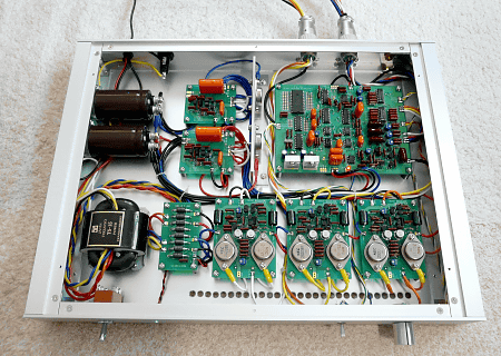

Has anyone got a good power supply schematic designed to produce the raw voltages needed to supply the control and drive sections? Such a design, using today's components should be more stable than the original and easy to build.
Many thanks
Thank you....I have a similar plinth concept, only somewhat larger....that way it can be reduced, but if it is to hide the electronics it may well remain large!
Many thanks
brianco said:Has anyone got a good power supply schematic designed to produce the raw voltages needed to supply the control and drive sections? Such a design, using today's components should be more stable than the original and easy to build.
Hi, Brian.
I'm new to this thread, but I thought it was time to jump in. I recently procured an SP-10MkII without the power supply. I designed a new supply that seems to make the platter spin properly (!) and the lights light. I won't have a plinth constructed for another week or 2, so I can't say how it sounds on an absolute basis. However, I will be able to compare it to my Teac TN-400 "MagneFloat" TT on a similar plinth, which I like better than my HW-19MkIV+.
Anyway, the supply is pretty straight-forward. The current demands aren't all that great (+32.5V @ 220ma, +5V @ 280ma, and +140V @ 5ma). However, I did observe that the motor current spikes up to around 1A for about a second at startup and for about 1/2 second at turnoff, so be advised.
The supply uses transformers I had on hand. The 30VAC transformer is probably a bit of overkill, but this is audio, right? The +140V supply is very sleazy. I've done this "reverse connection" thing for bias supplies in a tube amp and low current tube guitar preamps, which is what gave me the idea. There aren't a lot of 100-120V low current transformers around. I get about 85VAC out of the reverse-connected transformer, which I feed into a voltage doubler. Crude but effective. At some point, I'd like to remove the neon lamp in the strobe and replace it with an LED so I can run it off a low voltage.
Those are Fairchild "Stealth" diodes for rectifiers. I also use Panasonic FC's for the low voltage filtering and ED's for the HV. Can't wait to hear it.
JL
