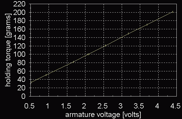

I've just finished measuring the torque/voltage characteristic of the motor. It's rather satisfying when you get such a straight line, directly from the measurements! No curve fitting required.

Yay! Finally all the electromechanical constants for the motor measured
Ra = 12.8 Ohm
La = 0.038 Henry
B = 0.0031468 Nm/rad/sec
J = 0.0457 kg.m^2
K1 = 0.02963 Nm/v
Kbe = 17.99 v/rad/sec
kt = 0.379264 Nm/amp
I doubt these were ever published, so no way to see how close my motor matches the expected manufacturing tolerance. It's not particularly important, since the feedback loop vastly reduces the impact of variabilty in the 'model' on the final performance.
