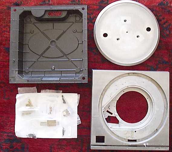

A great big thank you to Shaun O. for the SP10 platter & chassis which arrived today!
Apart from being wonderful for me, it's also going to make things much better for other DIYers, since now I can make PC boards that physically fit the SP10 chassis and its 'bathtub'.
That means the current PCB layout must be modified to fit the 'new' physical dimensions.
Now it is imperative that the PSU be a separate board & box, since it will not fit comfortably into the bathtub.
I'm curious to know Shaun, how did you come by this chassis without motor? Or did you take the motor & PCBs out for another SP10?

Great!
However, although I have the factory full obsidian plinth I have a gut feeling that others are better. The Kaneta plinth, but in natural slate coupled with Albert Porter's vibration damper (see here:

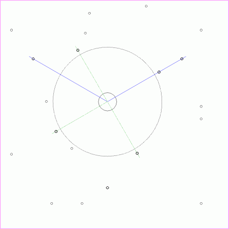

I've been mapping out all the threaded holes in the SP10 die-casting, so I can make the p.c. boards mounting holes match up. Its quite a tricky process, since they are at several different heights. Mostly done now though.
The SP10 mk-1 looks different, but mk-2 and mk-2a look as if they have the same casting (from the mediocre servive manual scans I have).
Dunno if you noticed that the holes are marked with the lengths of the respective standoffs...? Could perhaps be of some significance.
I did see that. Measuring between the stand-offs is easy enough: the mildly tricky part is getting the relative distances between the stand-offs and the 'other' holes, and the boundaries of the 'bathtub', since the whole thing is quite 'lumpy'! Oh, an figuring out how much clearance I'll have for heatsinks!

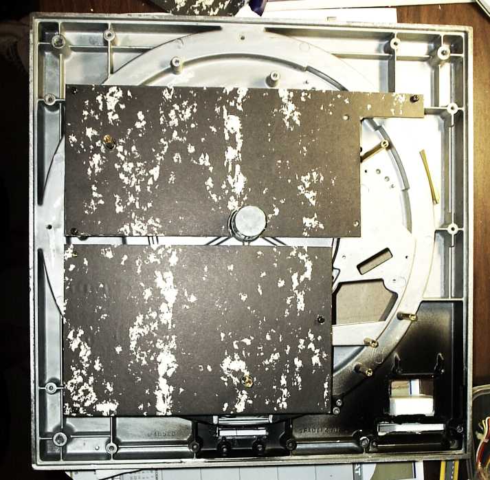

Meantime, here's a pic of some 'mock' boards, just cut to verify size/clearance and whether I mapped the mounting stand-offs in the right places.
I decided now the power supply should go completely 'outside' the turntable - a change from my original plan. Since there is physically no way to get the transformer into the SP10 'bathtub' chassis, the trafo HAS to be in its own box, so the regulators etc. may as well go there too.
