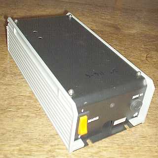

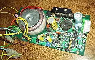

Long ago someone gave me this damaged 'generic' power supply (photos below). It's too complex to waste time reverse engineering it for repair. The transformer is still good, so it will make a neat box for the SP10 power supply, with a new PCB. It's 9" x 4".
The umbilicus between the PSU and the SP10 I'm thinking of terminating with 25pin "D" connectors (as used, though not so much recently, on desktop PC ports These plugs and sockets are inexpensive, easy to source, have lots of pins, and quite good current rating.

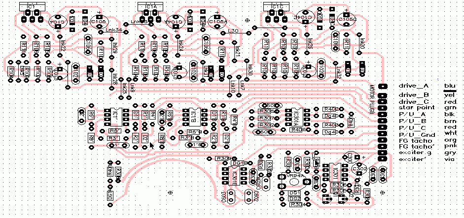

Its coming along nicely: slowly, but nicely.
A few important criteria for my layout, with a view to keeping it aimed at DIY and lowest possible cost:
single sided board; wide tracks and minimal tracks-between-IC-pads for easy etching, wide component spacing to allow substitute components of varying size, no surace-mount components.
This is a protoype board, so it contains component positions for all possible theoretical circuit arrangements. For instance, the op-amps can be configured as inverting, or non-inverting, by adding specific resistors and omitting others; filters can be 1st order, or 2nd order, depending on resistors & caps added, and so on.
If the board works OK, I will NOT redo the major layout to minimise size, or hole-count / component-position-count. Minor fixups, yes, but the board will remain like this so future experimentation and modifications can be tried.

This all sounds excellent to me. My plan was always to mount it external to the motor unit and a have a spare 19" rack case for it somewhere.

That's a very clean layout! If you don't mind me asking, what layout software are you using ?
I've been playing around with a couple of the free-bies (Eagle and 4pcb) and have had to do a huge amount of hand routing due to the difficulties of doing single layer boards with those tools.
Tango PCB. By software fashion trends, it's ancient. But nothing newer (in the affordable categories) has impressed me at all.
