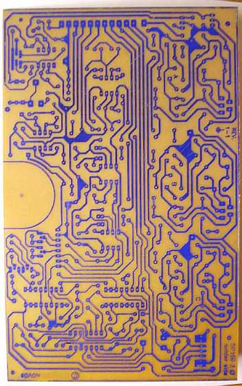

Those who've scrutinised my PC-board layout very closely, will see that I've changed the design slightly from the circuit which I posted a while back. Now LM317T and LM337T ICs on both supplies:
(i) the are better performing chips than the 78- and 79- fixed regulators.
(ii) I'm still not exactly certain what voltages I want. With the 317/337 chips the voltage can be set anywhere just by specifying 1 or 2 resistors, rather than swapping the IC itself.
I'm getting close to finishing up the printed circuit layout for the board which will contain these circuit blocks:
  • the 3-phase power stage,
  • the exciter oscillator,
  • the 3-phase AM phase detector,
  • the tacho preamp & wave shaper.
As always, when the board gets close to finished, squeezing in the last few components and tracks becomes annoyingly tricky. A few more days ought to suffice. I hope!

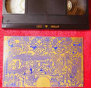

I just finished etching the PCB. Better not drill it now, it's 1:45am and the neighbours would complain!
