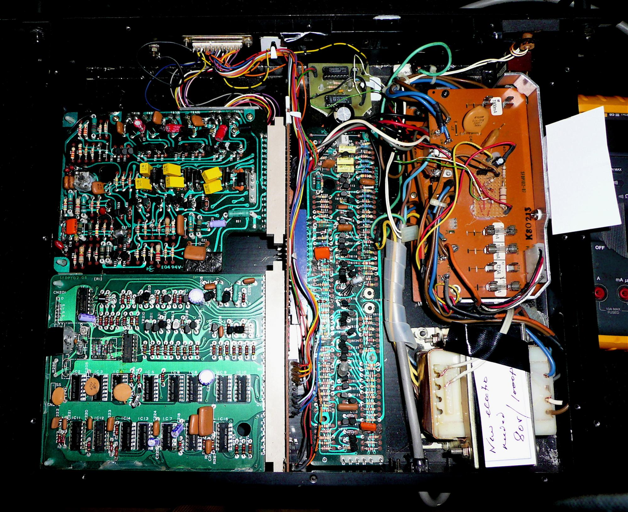

Well - there you go! Irish mind reading again. It just happens that I dug out my PS. tonight and poked around a bit to see if I could source the problem. No luck of course!
What is it doing or NOT doing ?
It simply died. No noise, smoke, fumes, heat. New electrolytics were fitted 3 years earlier. Regs seem to be normal, Diodes all work. But voltages unstable in the 32.5 section. They swing widly, yet as I said, regs appear to test OK and caps also.
It was working and then simply died without fuss or warning. This as you can see below is an off-plate/remote PS adaption.
That's sort of a contradiction. If the regs are working OK, the voltage can't swing wildly. Unless the drive circuitry is drawing a phenomenal current - but something must then get hot.
Does it ever exceed 32V, or always dip below 32V?
Does the Ac voltage entering the rectifier for that section remain fairly stable - should be around 25V AC I believe?

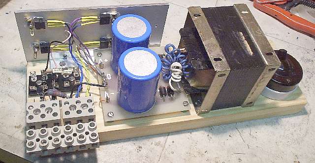

(my breadboard power supply has decided to go on the blink this weekend. The Fates must have pms)
My under-currented Heathkit testbench supply and an overly bulky and under-voltaged computer power supply have been thus far an annoying pair with which I have been doing my testing.
I decided I needed something more convenient to do the SP10 experiments with, so I put this together with parts lying around. It's not a great supply, but it will make things from now on less frustrating!
