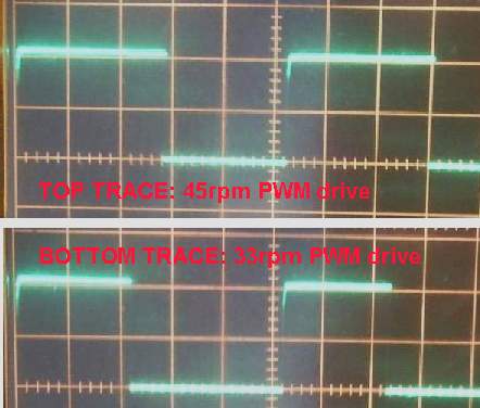

I've discovered now that this motor - unlike a 'normal' 3-phase motor - does not reverse direction just by swapping two phases.
Two ways I found to make it reverse: (1) invert each phase drive, and (2) advance the phase sequence by 120 degrees.
(1) is electrically complicated, (2) doesn't produce as much torque, and makes a faint droning noise.
I cannot think of any realistic need to run the motor in reverse - other than for a fraction of a second to bring it to standstill, so I'll be going with (2).
