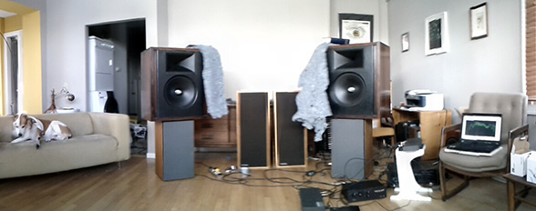

I wanted to give the "test" a try, but I'm in the process of moving out, so this is the best I can do. There's too much reflected sound going on here, so there's no great localization to start with when it comes to things like pink noise or mono complex music - just a big fuzzy cloud.
What I can report is this:
- In general, the pink noise pretty much holds in a fuzzy centered location. As I move beyond the area between the speakers, it eventually starts to collapse to the opposite side speaker as the direct sound from the near speaker becomes negligible.
- I did find an small area in front of the right speaker where I could stand and the sound would collapse into that speaker. I am guessing it's no coincidence that this was around where the side and floor first reflections are equal distance. The left speaker has more room on the side here, and I didn't find any such spot on that side.
P.S. The insulation is there because these speakers are supposed to have grill assemblies with absorption to knock down the edge diffraction.

Another detail, there is a door on each side opposite the speakers, and they were open to the rest of the house during the listening test, they are usually open unless the room is being used for recording.

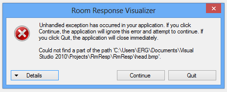

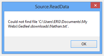

The reason that I have revived this one is that I have now posted the software (with a few remaining bugs). (You can use the link below and then go to "loudspeakers". Half way down is a link called "Room Response".) As with Polar_Map, it may or may not work for you. Web App is a Microsoft Wizard and if it does not work there is nothing that I can do because I did not write the wizard. It does work for me and many others, but it does not work for many others. One issue that I know is that the data files use a decimal point and not a comma as is common in the EU. This will cause the data to be misread and a likely crash if you try and run the software in a region that uses a comma as a decimal point. Changing the region on the computer often solves the problem. Microsoft .Net 3.5 is required and will be installed if you do not have it, but this may take some time. Once .Net is installed running the app is very fast.
Markus
Thanks, I found this error myself when I tried my laptop. I need to get the software to point to the web file locations and not my local files. This is easy for the data files, not so obvious for the bitmap. I am not sure how to embed that. So the second error will go away shortly, but the first one might take some time.
I'll post here when I get this corrected.
Its fixed now, I think. It works from both my desktop and my laptop. the screen real estate on the laptop is kind of limited. Works better with a bigger screen like on my desktop (dual screens are wonderful!)
