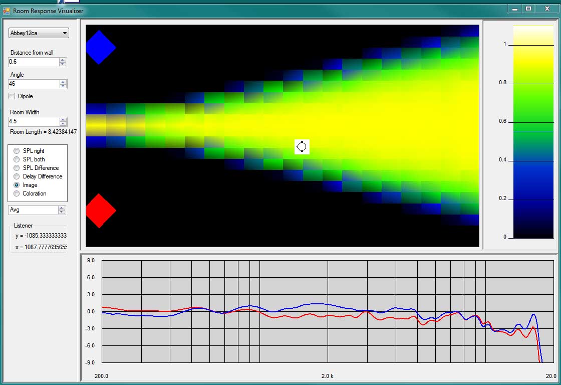

Post up some meaning results from real measurements that back your contentions instead of asserting that software simulator, that doesn't even support reflections, supports your position on wall reflection impact on phantom image formation.
Sorry I don't get the point you're trying to make. What exactly is my "position on wall reflection impact on phantom image formation" and where and how did I use Earl's software to make my point 😕
