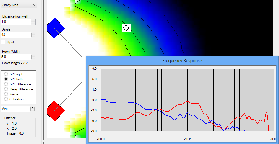

Why smaller than 50 degree opening angle? It works for me at anything above about 40 degrees.
Yes, I can change the range, but I have found that the "dipole" button, which normalizes the curves at a different frequency, usually works.

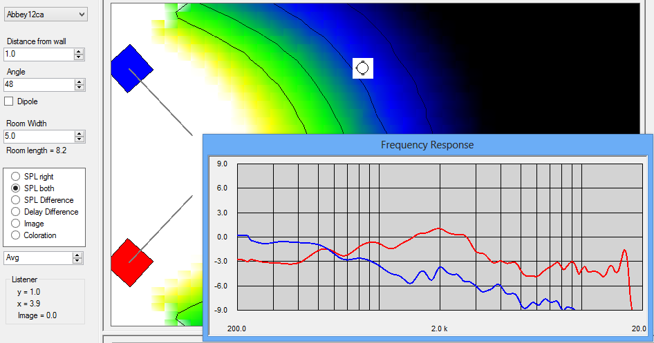

"Above" 40° degree? You mean "below"? Here's 60° opening angle:
This is 45° opening angle (typical home theater):
Only the latter gives a broadband level difference of about 3-6dB. I think that's not enough for proper trading. This suggests that speaker directivity should be higher.

I don't understand what you mean by "opening angle". The pointing angle is the same in those two plots - 48 degrees.
The listening grid is rather course which is why the listener is hard to place precisely it jumps to the nearest calculated location. Since the entire field must be recalculated for any change a finer grid slows things down very fast.
There is no "front wall", in this app there basically are no walls at all. The speakers are at x = 0.
You observations may be correct - you are at extreme off axis seating locations. The point is that no speaker does what you are looking for. Trading does occur for even small dB differences, just look at the Blauert data. But nothing is going to correct the seating locations that you are at in the above examples. And once again you are implying that what so many have noted does work for them will not work. The "image" plot corresponds well with my experience.
You will miss the entire point if you continue to look for the "ideal". There is no "ideal" only real speakers and all their flaws.
Angle between the left and right speaker viewed from the listening position.
Good to know. I had assumed they are at x=30.
Exactly why I'm saying "it doesn't work" because there's never enough level difference.

Why do you ignore what I say? It does work. Your example is at an extreme location and completely misses the fact that there is enough level difference when the delay differences are not extreme. But once the delay difference becomes extreme then only extreme level differences work. You just keep ignoring the Blauert data on which all of this is based. If you don't think that Blauert is right then say that - basically that is what you have been saying.Exactly why I'm saying "it doesn't work" because there's never enough level difference.
A matrix decoded center works better.
Also completely beside the point. There is no center channel is this study.
Why is your goal to negate everything that is being discussed by going to the extreme position? That is all too common of the "esoteric audiophiles" around here, but not what I would expect from you. Sound reproduction is a series of tradeoffs - nothing is ever ideal. The goal is to find the best tradeoffs, not to be shackled by seeking a perfection that can never happen.
I don't ignore what you say. Your definition of "it works" is "there is some effect". My definition of "it works" is "there is 1:1 trading".
Markus - precisely!! You take the extreme position and I look at the realities of tradeoffs in the real world.
