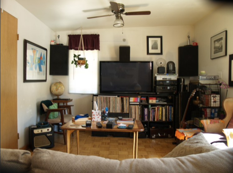

Just in case anyone wants more subjective reports than two, here's mine:
With any speaker reasonably close to constant directivity behavior, it seems pretty easy to get a phantom center-panned image like my little sketch here, where the lines point to listener location and the ellipses indicate the perceived locations of various centered sounds.
It gets more fussy when it comes to sounds that are panned pretty hard to one side and the listener is closer to that side. Those tend to want to collapse onto the speaker-to-listener axis. The more edge diffraction and early reflections are eliminated, the less this seems to happen, so I'm not sure if those things might be the only cause of the problem, or if there is more to it.
In any case, it's an understatement to say that I find the overall effect of an image that stays relatively stable while moving around very pleasing, even when it's far from perfect.

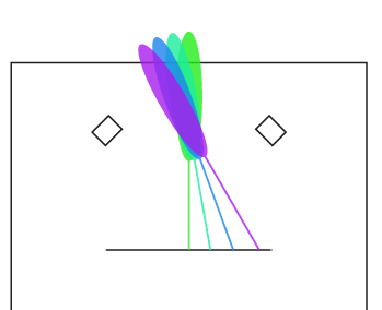

My Pluto Clone are extremely omnidirectional <3kHz. As angle of listening triangle gets wider, by speaker placement or getting head closer to speaker plane, image gets wider and shallower. When I set the speakers up midway in my 25' x 17' living room ( 50% of wall surfaces are brick and glass with no treatment, rest of wall surfaces are wood), placed 3' from long walls with tweeters pointing directly at each other, the image is identical listening from either end of the room.
With speakers placed closer together the image rolls down into floor with head in vertical plane of speakers, and above horizontal plane of speakers. Laying on floor between speakers, image is up in the ceiling.

There is a lot of talk about phantom center and phantom image here. I'd like to know, what happens to more than one image between your speakers, if you move to one side - let's say the left.
This would be the scene if you sit in the middle between the speakers:
Now you move to the left. Do the musicians stay in their place? Or do they move as an entity towards the left speaker:
Are they compressed:
Are they blurred in any way:
Are they compressed and moved towards the left speaker:
Or are they even progressively compressed:
Or does it happen in a completely different way?

The answer to any and all of your questions depend on the dispersion pattern of your speakers, their location in the room, toe in angle, room size, shape and reflectivity.
Art

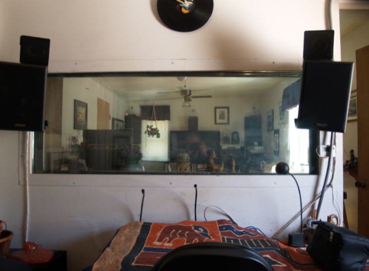

I tried listening to mono pink noise at a level of about 78 dBC and shuffling my feet with my eyes closed across my room just in front of my couch listening location which puts one's head in the center of the room.
The speakers are corner wall mounted, toed in to point at the opposing room corner, room dimensions are 11 foot wide x 20 long x 8 & 7.5 high, 3.38 meters x 6.15 x 2.46 x 2.3.
No subjective off center "snapping" of the phantom image with this set up.
That said, what "snaps" to your ears might be a brush to mine..
When the speaker levels are balanced, the general "phantom location" of the noise appears to be directly in front of the listening location from left to right across the room.
The sense of location is not very identifiable other than being centered in front over the middle 1/3 of the left to right listening location.
When going left or right from the middle 1/3 the image appears to be more a vector sum, L/R locatable points "averaging" as one in between when outside the center 1/3 listening location.
This effect changes to a direct in front location when shouldered up to the side wall.
Reducing level of the right speaker 10 dB the only "balance point" was about 2 feet (.6 meter) in front of that speaker, any other position the left speaker was the obvious location of the noise.
Reducing level of the right speaker 5 dB the "balance point" moved to in front of that speaker at the original listening distance, about 8.5 feet (2.6 meters) back from the speakers, all the way to the wall.
Subjectively, listening to a mono spoken voice, same general perceptions.
Listening to stereo classical music, the general locations of recorded placements seem to stay relatively placed while moving across the center of the room in front of or sitting on the couch.
Towards the back of the room the sound is too diffuse to specifically locate recorded sources that are not hard panned left or right.

Rudolf - my impression is that there is some compression of the stage width as one move laterally and that the center of this image moves slightly with the location. As above, I don't know how to represent this mathematically so I used the best that I could find which was the Blauert curves.
