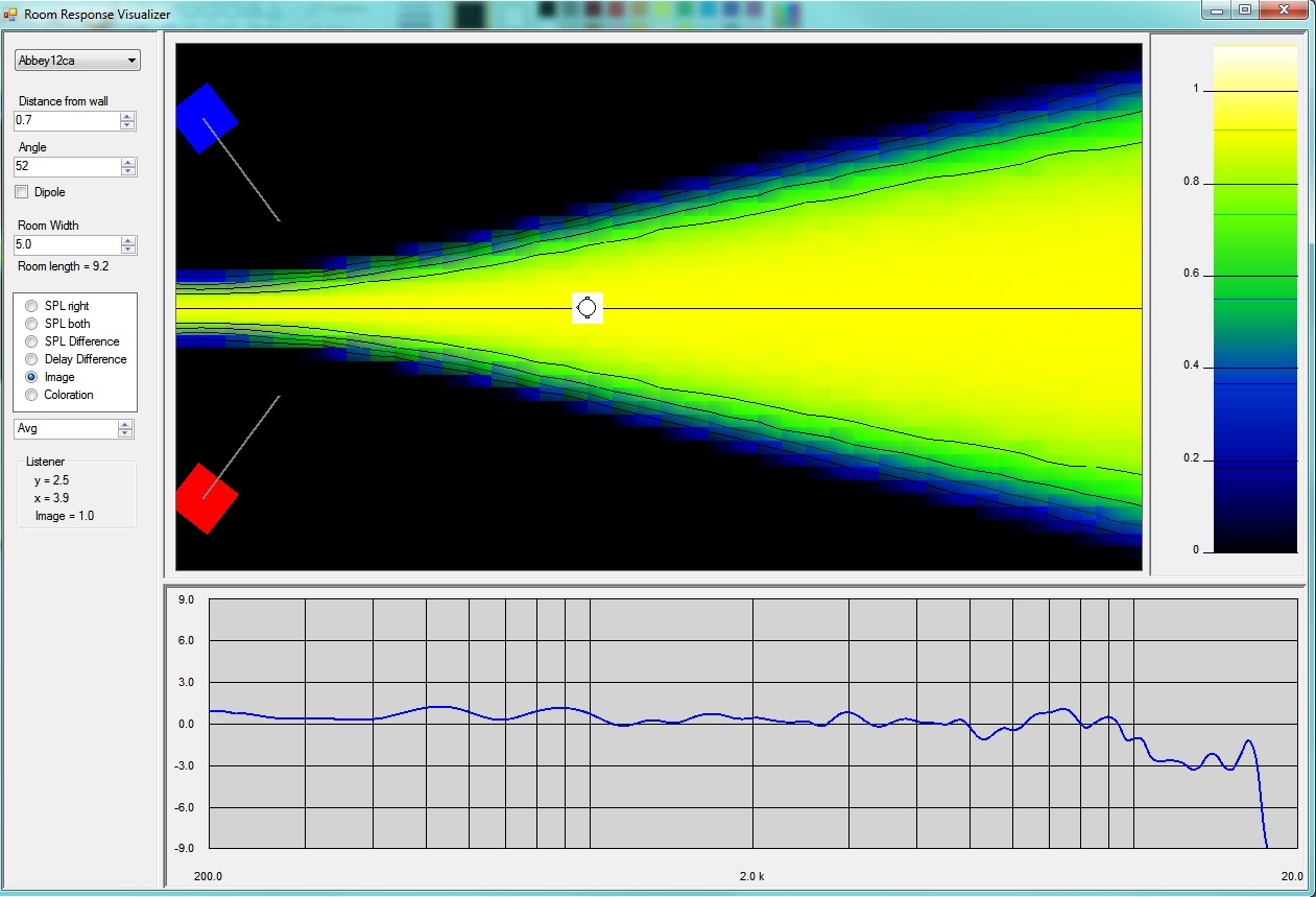

Here is an interesting comparison. The Abbeys can be pointed straight ahead and achieve the same frequecny response as toe-in, but with a much smaller field of good imaging. The non-toe-in would have strong early reflections and an enhanced spaciousness, but a degraded image. But you can have it either way if you want. Or put them on a turntable!
These plots have much higher grid resolution. It was only a minor hit to the real time updating. The gradient algorithm still has trouble with a very steep gradient.
