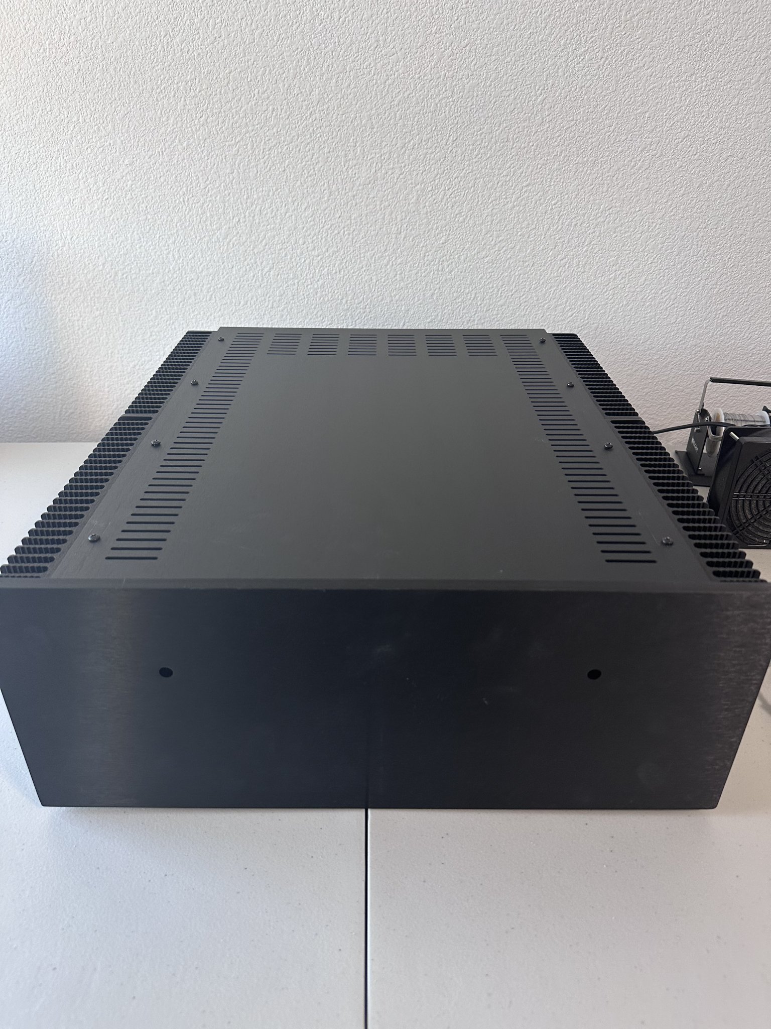

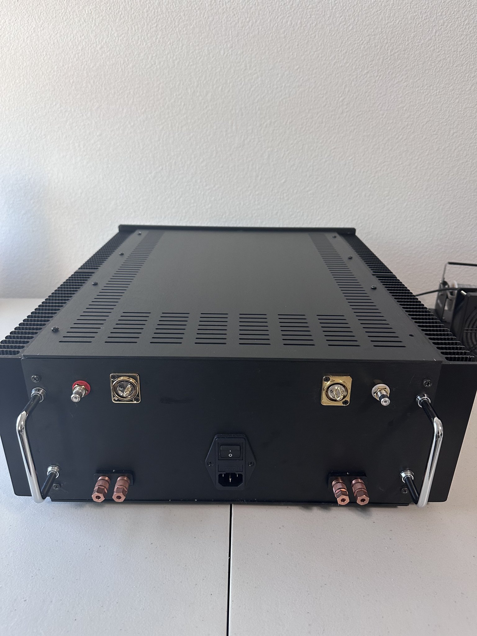

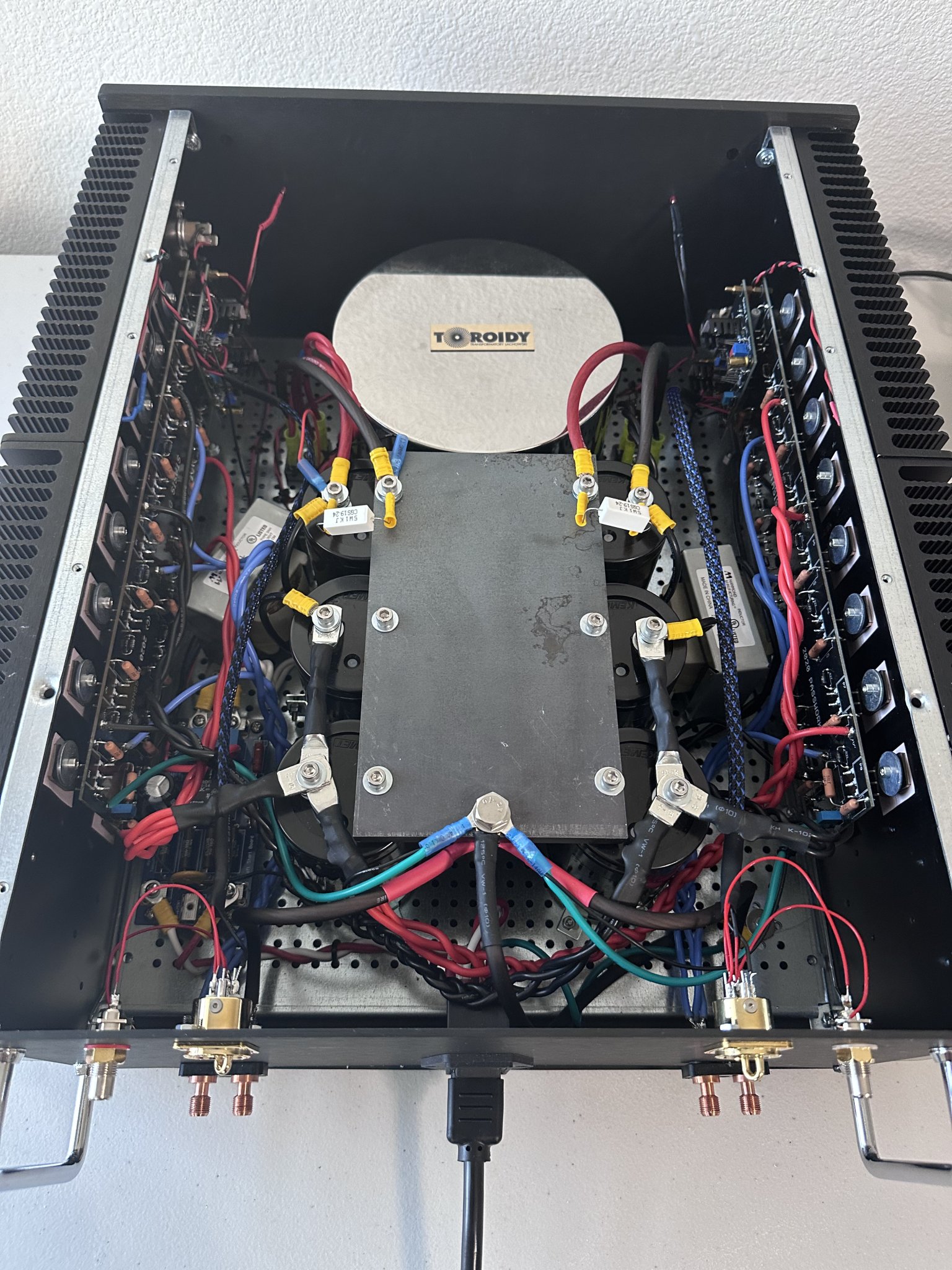

Finally got this thing up and running. Used Pico’s chassis, 8 deep boards. Started off at 44.5 unloaded volts and after biasing, came out to 41 volts so guessing im getting a little over 100 watts if my math is right. It’s biased to 150ma which is getting me a little over 50c
