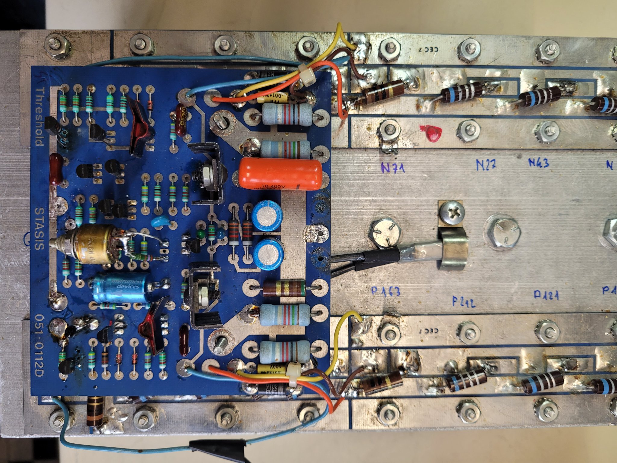

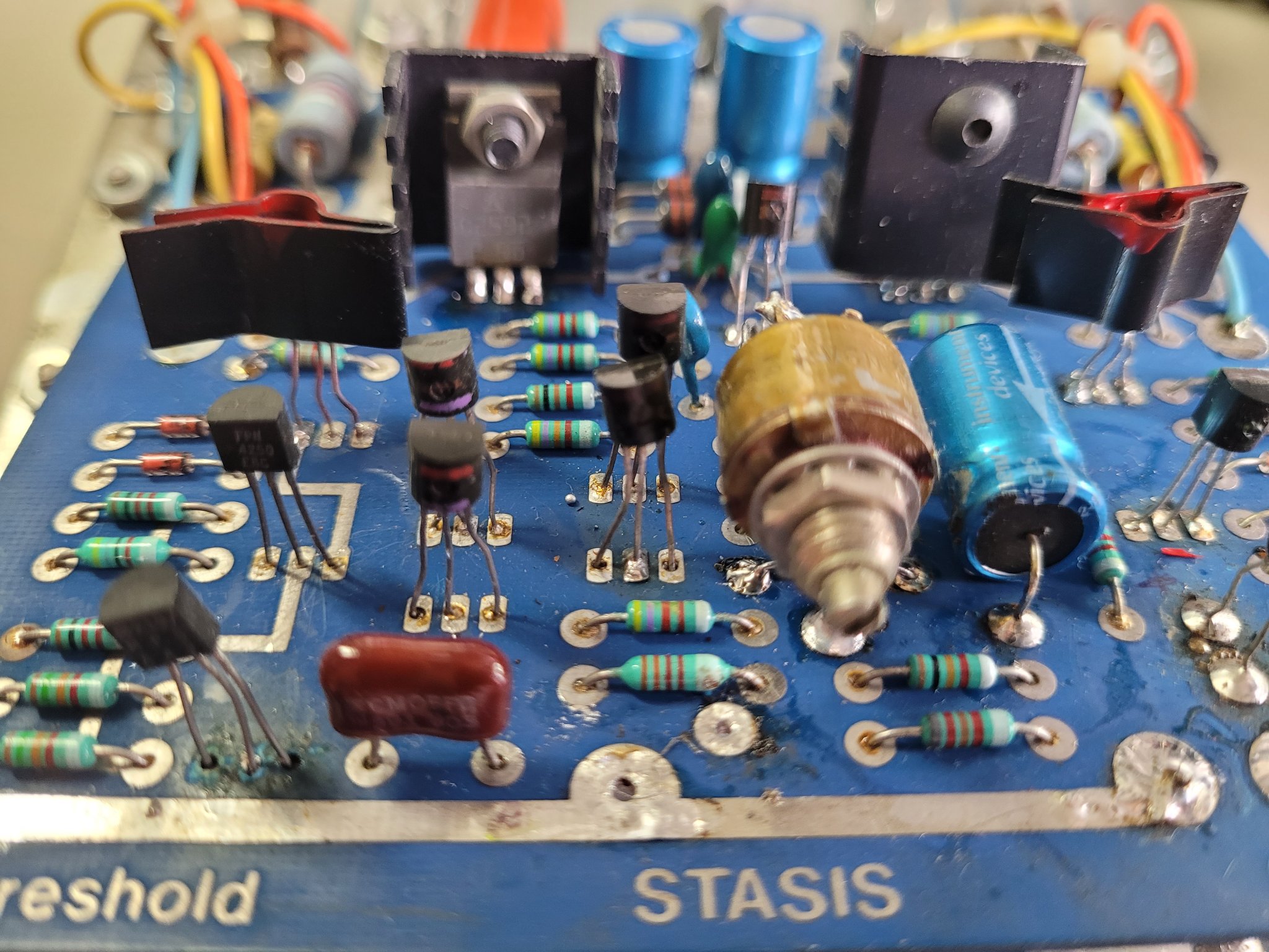

Hello
My Stasis 3 amp has been repaired, and the circuit boards are in very poor condition.
I would like to salvage most of the original components and reassemble them on new PCBs.
I'm going to order PCBs, but I don't know which ones to choose. I'm thinking of getting the larger ones, those made by Mr. Pass.
Can you tell me the dimensions of this PCB?
On one channel, four TO3s were replaced, and only one on the other channel.All the other TO3s are original.
I'll have to redo some of the wiring, because the repairer also burned the wires in addition to damaging the PCBs.
Here are some photos to illustrate.
if speaking about FE pcbs, do not
use all new parts, cost is trivial
Thank you, yes, I'm talking about the FE PCB.
I would like to use the NP FE PCB.
Is it possible to have the complete part list for this PCB ?

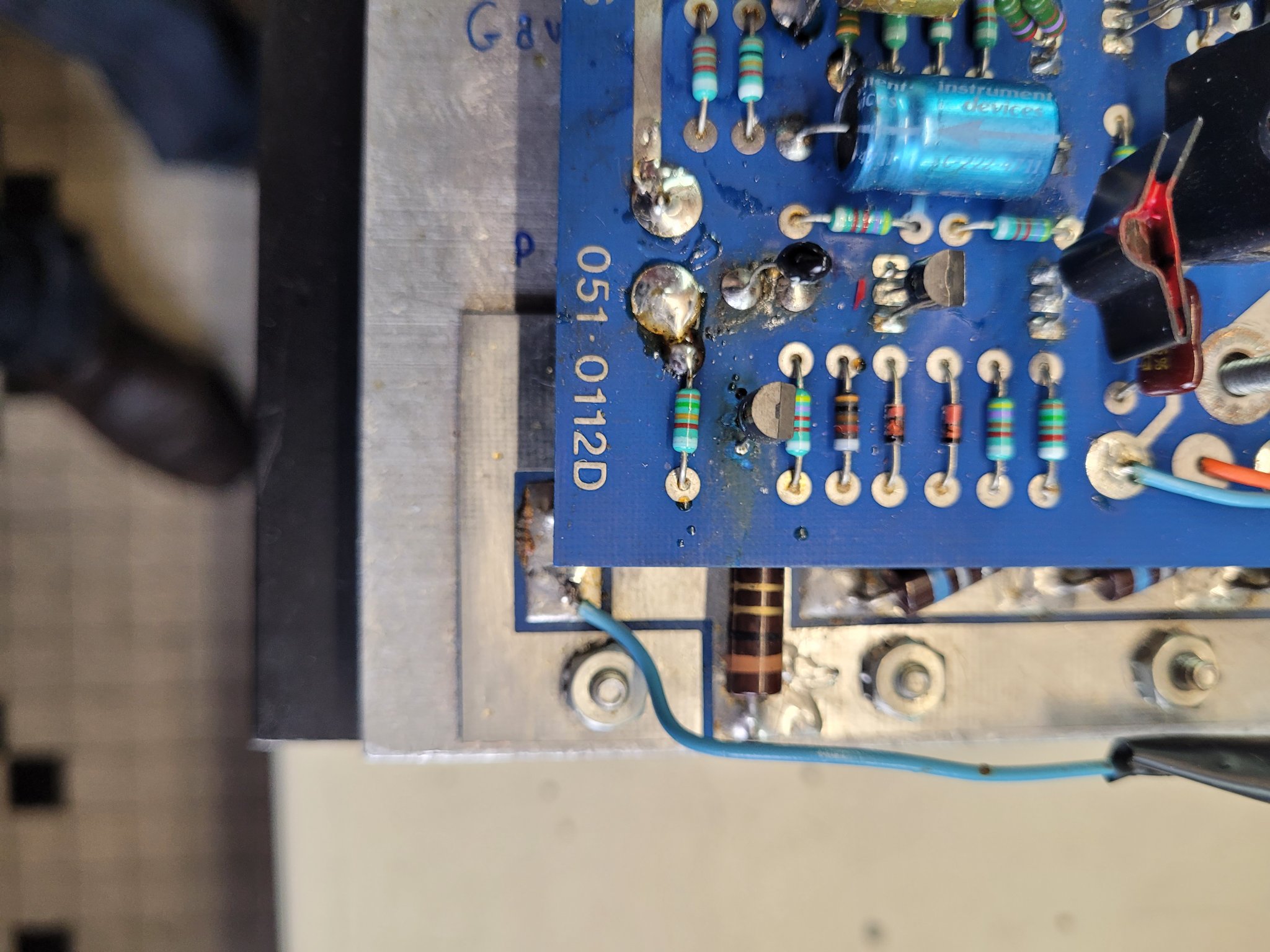

Hi Gents.
Recently bought this Stasis 2 as faulty ( the only way I could ever afford one )
Symptoms were : slowly over time was brought up to 240v using a variac , then used for a week until smoke was seen and then the left channel went down.
I’m no engineer but I can replace parts so I’m hoping someone can steer me in the right direction.
Any idea which component(s) have failed and caused the burn ? ( see photo also )
Any assistance would be greatly appreciated.

Okay, I'll make a list of what I need.By the time I receive the boards, I'll have time to look.few Boyz made it, maybe they can help
though, best to make your own list from schmtc
if in doubt about any of parts, just ask
there are Gerbers for all pcbs, and maybe someone is having few surplus ones
For the board dimensions, should I request 140 mm (4.5") x 104 mm (4.2")?
I made a shopping cart for 5 boards on this site: https://www.smart-prototyping.com/PCB-Prototyping.html
I don't know which is best, this will be my first time ordering blank PCBs.
I helped The Finisher with his Stasis 2 rebuild in the thread referenced at post #1514, we used the NP FE board and it worked fine and fitted in well. As part of that rebuild, we installed all new TO3 outputs, new emitter 3watt resistors, new PSU caps and new PSU diode bridge at the same time. Any questions just ask here.
