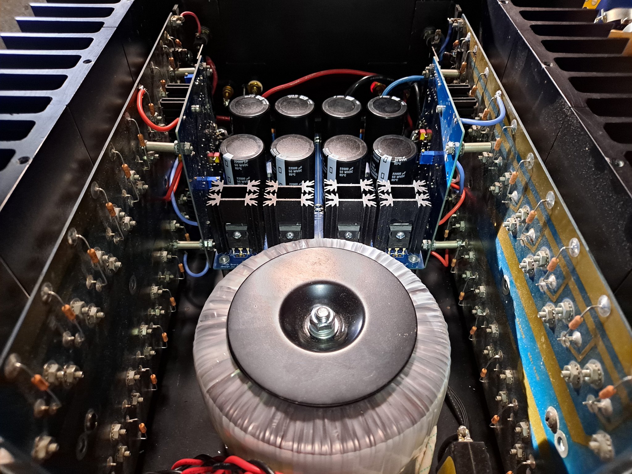

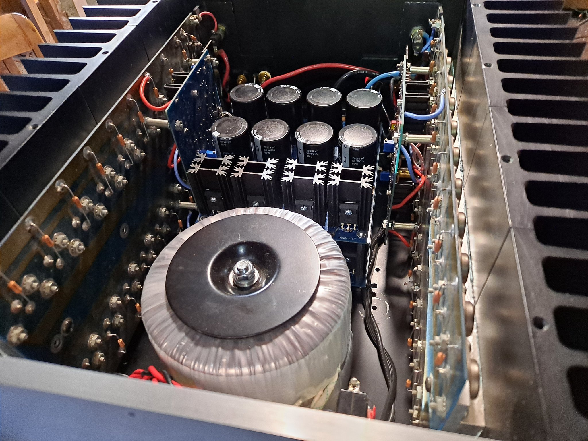

Okay, so I have the amp back together. I have a few things to touch up but I brought the bias up and watched how things behaved. both channels are good. Cover on to cover off bias doesn't shift as it did before so that is a big improvement. I haven't even played with C5 yet. That will come soon. However, I got impatient and hooked it up to my speakers. My initial impressions are that the bass has so much more control now which you wouldn't think considering I reduced the wattage by quite a bit. Also, more detail and the highs are better now.
Here is a pic of it put together. I will let it burn-in for a while then I can take some time to sit with it and see how she sounds. So far so good 🙂

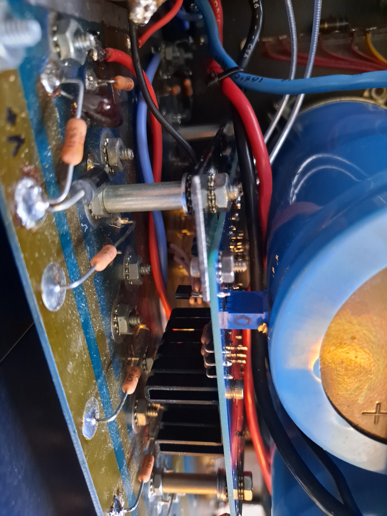

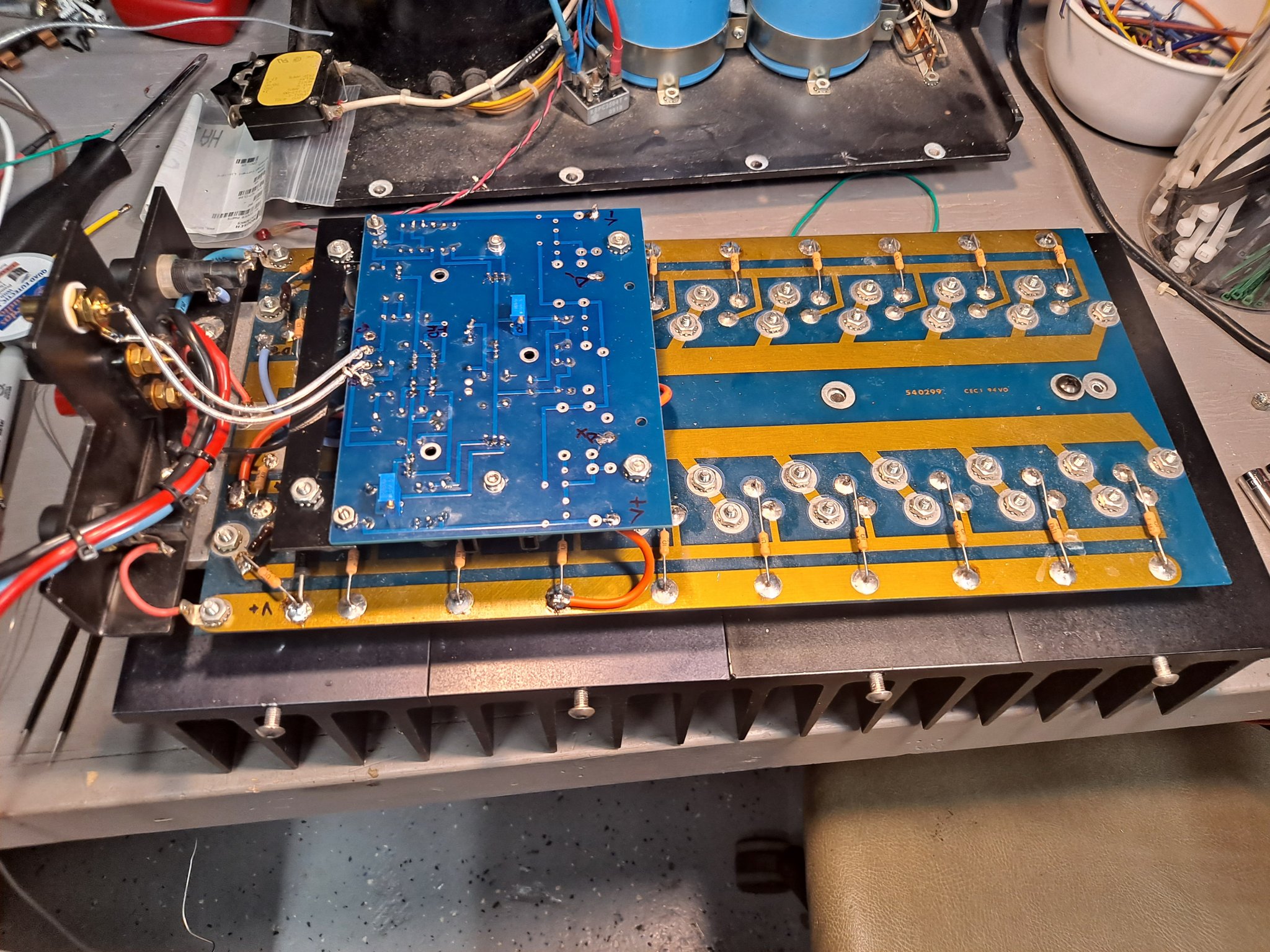

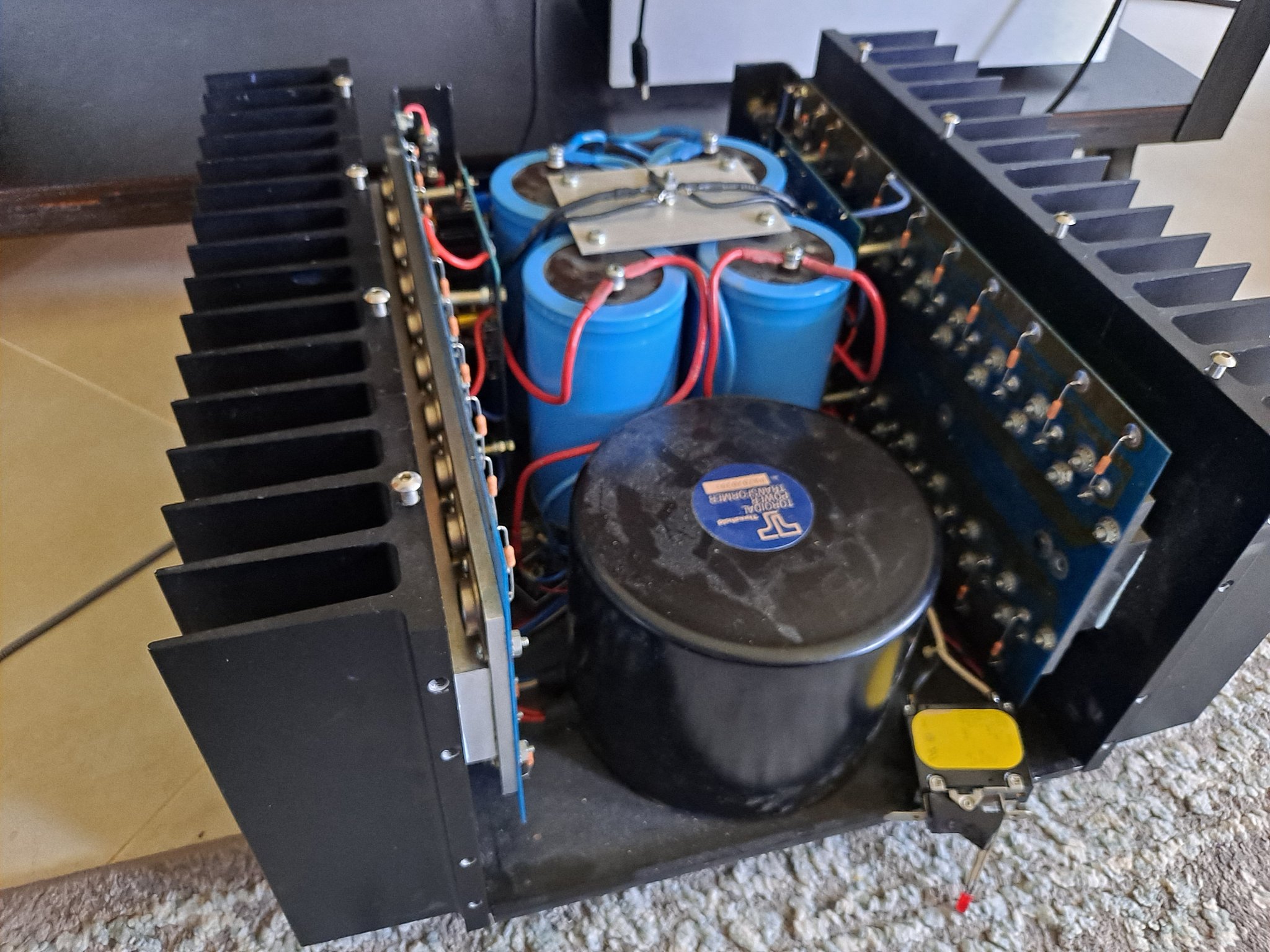

Attached are a few pictures:
-One of the output stage
-The clearance to the front end heatsink to the source resistors
-A shot of the channel with the new front end attached
-The amp stock
On the outside, it just looks like a stock S/500. It is a big amp and only 70-80 or so watts, I will have to test people to see how many watts it is after hearing it...
If you guys want any pictures in particular, I will be happy to take them. The only thing that I replaced on the outside are the RCA jacks for a new pair.
