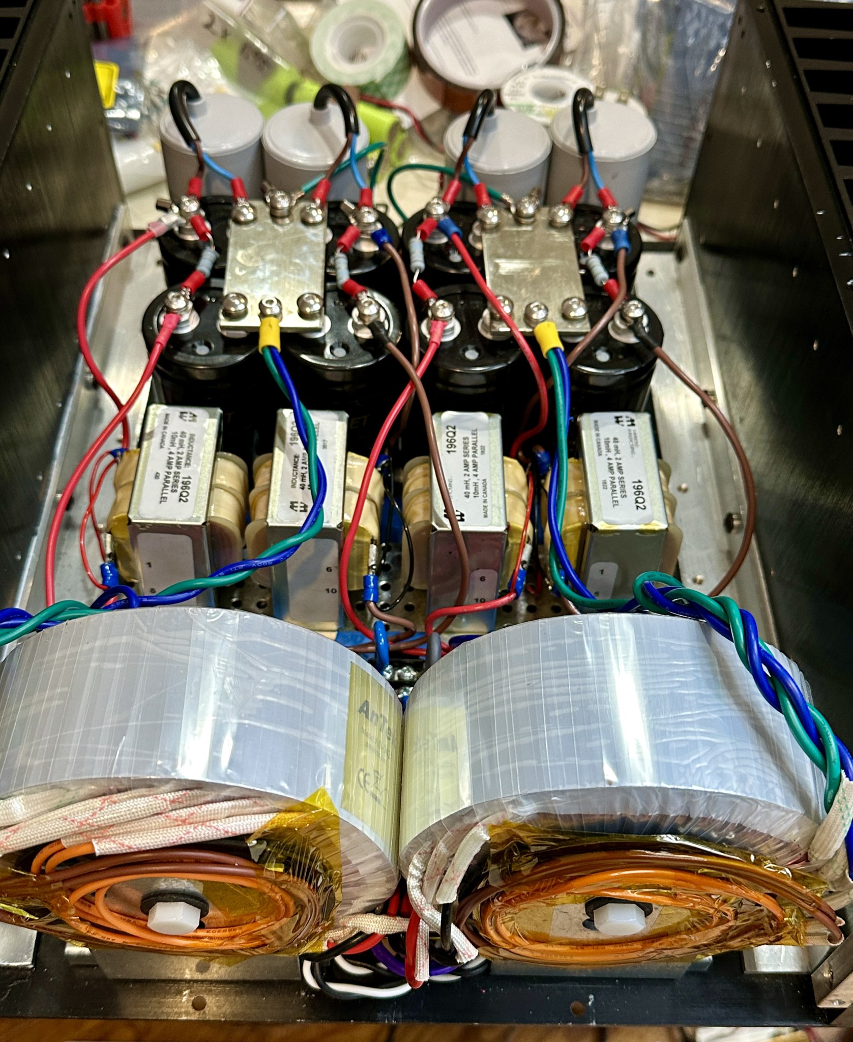

Impressive, what DC rail voltage are you running?
Looks like a CLCRC psu, with added motor run caps. looks like a 500va toroid or so per channel.
DC rail voltage will be +/- 36V.
It is actually CLCc with the resistors in parallel with the chokes to control the Q factor. Toroids are 300VA with 28V secondaries.
The interior of the chassis is relatively narrow due to the size of the fins. I have the 8 deep OS boards and will set final bias current based on temperature.
That is the rail voltage I have chosen as well, boards are loaded and will use the 6 transistor OS from ZM. Power supply is still to be resolved.
