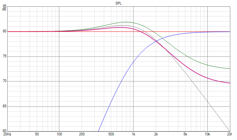

I see. Is the principle not the same? For example, here I'm showing a high passed and inverted, correlated signal along with the resultant partially cancelled response for three cases.. same level, +3dB and -3dB. The level variations also show frequency based variations for the same reason as above...
You didn't factor in the delay here... plus there would be another roll off on the top end of the inverted signal.
Ideally I would have made the cancellation signal a flat phase corrected (though DSP) solution. Such a signal could
quickly be made with RePhase to test in a dry run like this. I've used 270 uS as well as 540 uS of delay in my setup...
So the signals aren't in time with each other at the ear? (Only speaking of the signal components in question)
No, the inverted opposite channel signal is added with delay.
Look at the graph I posted of the measurement at the ear position (in this case with a dummy head in place).
We're trying to correct the leak of the right channel to the left ear and vice versa.

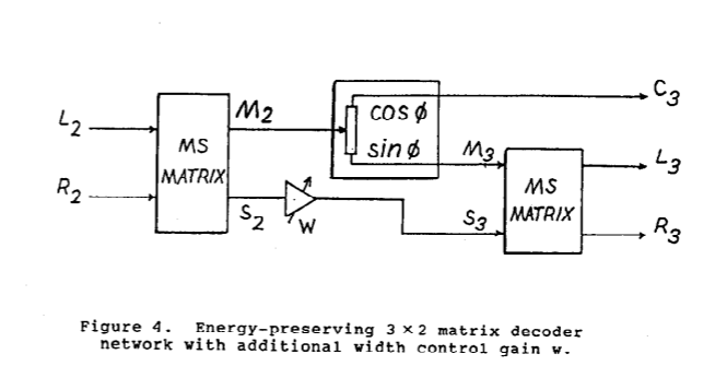

Hey Ronald, I looked that up here https://www.izotope.com/en/learn/what-is-midside-processing.html
is that the same as the matrix that jaddie mentioned?
Well, Jaddie used those basic principles to come up with the matrix components.
Mid/side EQ is often used in Studio work. The Mid component (which still has some Side information!) is Left + Right channel.
The Side component is Left minus Right channel (the opposite of that is Right minus Left, which is the same as the Left minus Right inverted).
You'd have to be careful with mid/side EQ and manipulation, as it will change the channel separation negatively.
As mentioned in that Phantom Center thread, one can achieve a more equal tonal balance across the left phantom right stage with some mid/side EQ.
Boosting the side channels just a little bit, also works as a cross-talk cancellation effect for the side channels, making them appear a bit wider.

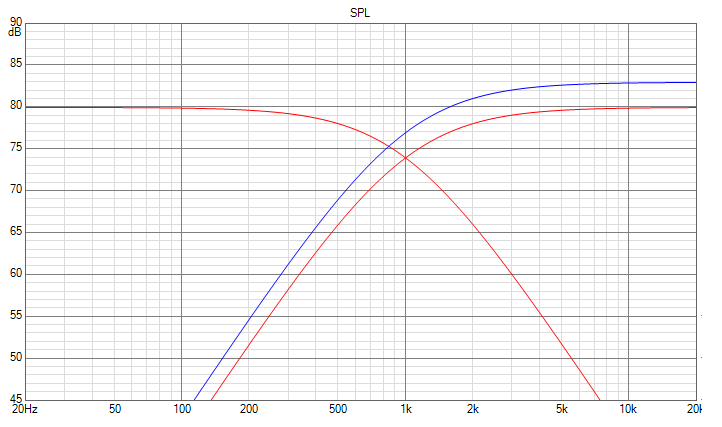

What exaction is being adjusted? And what speaker is this?Three factors are linked.. the response, level and crossover frequency. All three curves shown here are LR2 @ 1kHz...
No. Mid/side is essentially using two signals, a L+R sum and a L-R difference, to re-process. The matrix used for developing the cancellation signal doesn't use the mid, a L+R sum.Hey Ronald, I looked that up here https://www.izotope.com/en/learn/what-is-midside-processing.html

Currently Implementing this from Gerzon's paper http://decoy.iki.fi/dsound/ambisoni...for Multispeaker Stereo (TRIFIELD)_Gerzon.pdf.....
Need to hurry up and finish 3rd speaker for center, to start testing it and listening.
