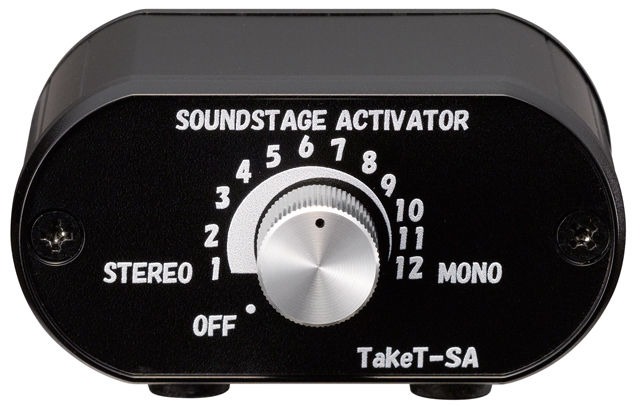

OK, it's not as big as a change of room or speakers, but I saw some exaggeration to say "x1000 or more".
The electronics in an amplifier can modify the phases, this gadget works with that premise.
https://exclusive-audio.jp/en/products/sa-u
