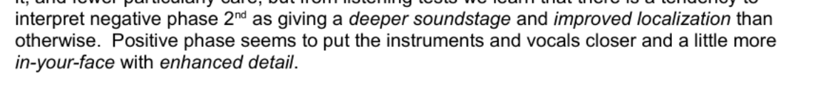

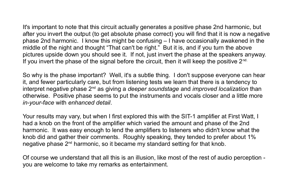

Yes. Inverted polarity. However, polarity is random anyway, not possible to determine what is "correct" throughout the entire chain, mic to speaker.
start here https://firstwatt.com/pdf/art_h2.pdf
The above presumes that the phase of a harmonic is known. This is not true. Harmonic phase is not fixed, and is a function of the nature of the instument generating the sound. Harmonic phase affects timbre, and will not necessarily maintain a fixed polarity relationship with frequency. Those involved in sound systhesis know about this in detail.
As to the variable control that supposedly controlled the phase of the second harmonic...this is simply not possible. The second harmonic is not fixed in frequency or phase. An all-pass network can change harmonic phase, but has a fixed frequency break point. There simply is no way a simple control can change the phase of only the second harmonic without affecting all other harmonics (with other amounts of phase shift) and affecting the fundamental too as it crosses the all-pas filter break point.
There is either a LOT of missing information here, or it's simply "story".
Edit: To reiterate, there is absolutely no way to know what "positive phase" is in a recording played through a system. There are many opportunities in the entire signal chain for polarity inversion, but also phase change with frequency. Analog tape recorders have phase shift within the audio band! And not a little bit, also affected by bias and EQ settings, quite significantly. It is a major presumption to assume we know what the oritinal polarity, or phase response is/was. And if that's true, than the only means of compesation is to listen to what we think sounds better. That doesn't mean it is "as original", it means we like it better.

READ THe article ...pleaseThe above presumes that the phase of a harmonic is known. This is not true. Harmonic phase is not fixed, and is a function of the nature of the instument generating the sound. Harmonic phase affects timbre, and will not necessarily maintain a fixed polarity relationship with frequency. Those involved in sound systhesis know about this in detail.

Yeah. Deliberately adding 2nd...not my thing, not matter what phase they are.READ THe article ...please
Edit: A while ago I experimented extensively with the delibrate addition of second, and other even-order harmonics. Varying amounts, phases, etc. Comparied to the original it never worked for me in a positive way, and it took an astounding amount of distortion to create an audible change. Its another philosophy, but it doesn't make sense when the goal is to create as nearly as possible an acoustic representation of the original electrical signal.
From the article, the device can also be used to null 2nd harmonic as well, which would make for an interesting A/B comparison on a single-ended circuit. Though as a design element to null the even harmonics of a single-ended circuit, we already have that device; it’s called building a push-pull circuit.

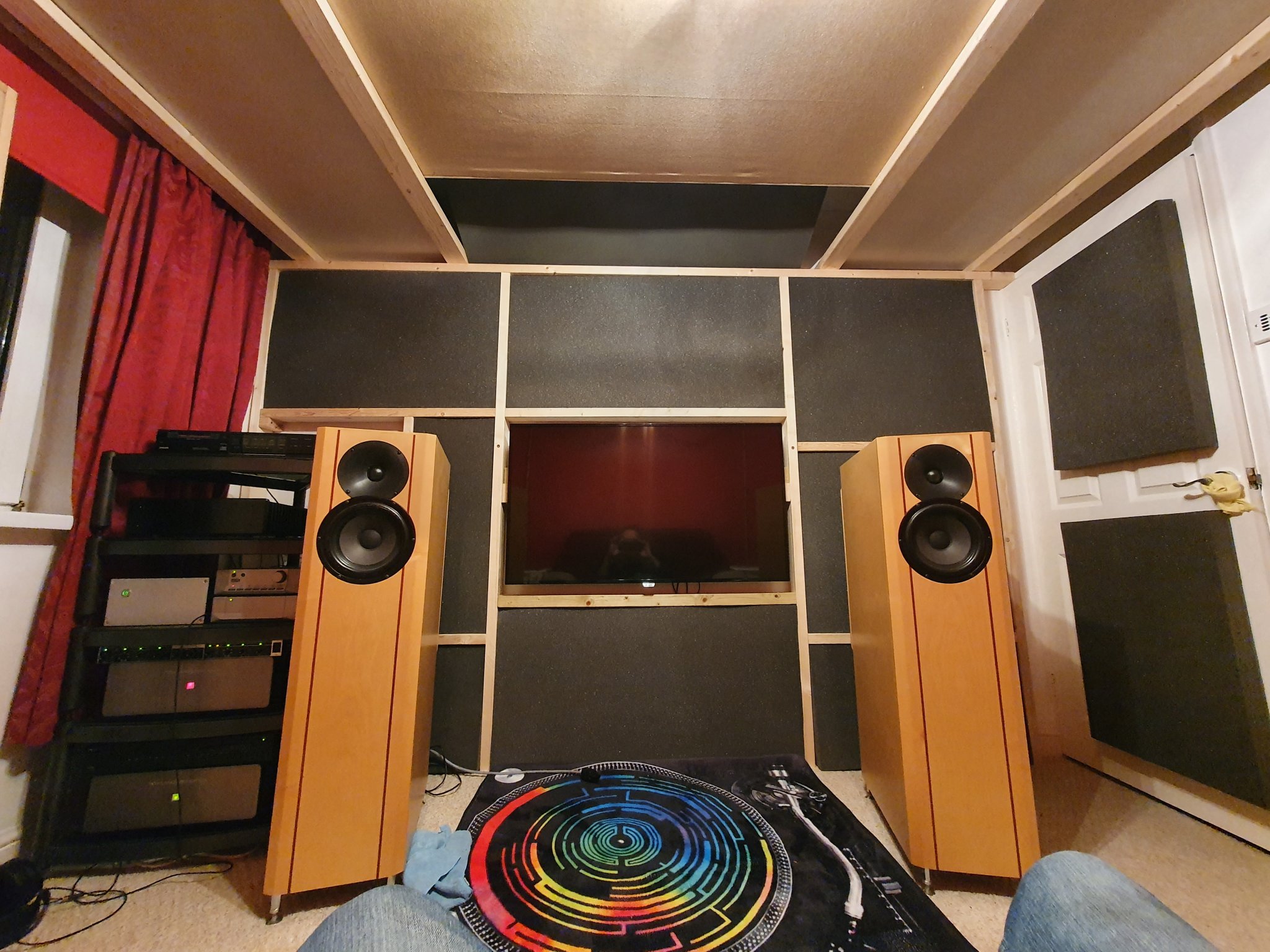

"More complicated than I want to deal with." That is a small room. The best improvements I have heard in my small room was room treatment. Nothing expensive, but it will take time, for a diy solution. The ceiling treatment really brought lots of sound stage improvements.Thanks, but all of that is much more complicated than I want to deal with. Plus, the room is very small and adding panels or making the baffle sizes a lot larger are not things I want to do. Just want to keep it simple with either new speakers or a new amplifier. Question is which of those is more likely to provide an increase in the sound stage.
How the sound waves bounce around in a small room, has more effect than equipment imho. Buy new speakers, buy another amp you will still have the same room. Same reverb, same cancelation, same echo, same mess. Maybe not the answer you want to read.

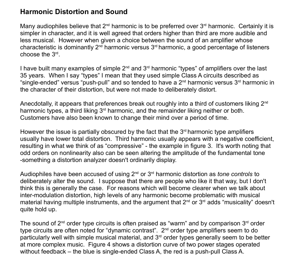

No, I got your point and fully disagree with it. Your quote doesn't support anything either other than a subjective opinion.View attachment 1025135
you still miss the point ! is the HD profile that can ,,,,all amp have
The "conclusion" contains this: "In fact, apart from assuming the preference for low amounts of simple forms of distortion, we haven't discussed the listener at all. Nevertheless, I am trying to make a point that relates strongly to the apparent disconnect between subjective experience and simple measurements of distortion.
<snip>
The resulting complexity creates distortion which is unlike the simple harmonics associated with musical instruments, and we see that these complex waves can gather to create the occasional tsunami of distortion, peaking at values far above those imagined by the distortion specifications.
And finally, this:
If you want the peak distortion of the circuit of figure 13 to remain below .1% with a complex signal, then you need to reduce it by a factor of about 3000. 70 dB of feedback would do it, but that does seems like a lot. By contrast, it appears that if you can make a single stage operate at .01% 2nd harmonic with a single tone without feedback, you could also achieve the .1% peak in the complex IM test.
And at last:
I like to think the latter would sound better.
No testing, no evidence, none at all. Nelson knows better!
Here's the really silly bit: any speaker...ANY speaker...introduces far, far more distortion of all kinds. Complex music tends to mask distortion to the point of inaudibility, particularly even order.
From "High-Resolution Subjective Testing Using a Double-Blind Comparator" by David L. Clark, JAES, May 1982.
"To find out what amount of distortion was audible, a distortion generator was developed (Fig. 8). Nicknamed the "Grunge box," it generates even-order harmonic components that are independent of level. The rms out- put also remains nearly constant as percent total har- monic distortion is varied. Distortion can be heard on high- or low-level music passages, and there are no level-set problems. No two real-world nonlinearities are the same, and the "Grunge box" is yet another one, but its sound is somehow typical and useful. The best done so far is 3%, but with carefully selected material (such as a flute solo) 2% or 1% might be possible. 1% is easy with sine waves. "
What he means by the "best done" is the minimum audible level of even order distortion that was reliably audible.
So...Nelson wants it reduced by a factor of 3000 below .1%. OK. How is that audible in a controlled test? Sorry, no data, but indications from Clark are that it wasn't audible at .1%.
