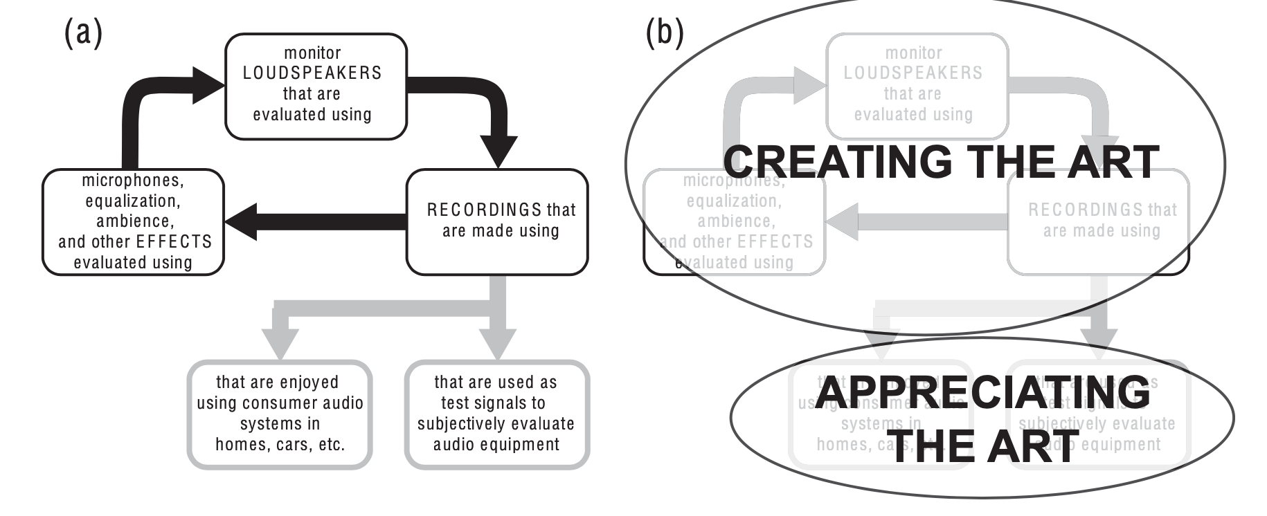

Ha ha! I was once commissioned to re-align the monitoring in a prolific local advertising jingle studio. The owner of the studio, also writer and composer, could tell that his control room monitors were not doing a good job of representing what was going down, i.e. the playback didn't capture the natural timbre of the instruments being recorded. He was right, they didn't!See "Sound Reproduction - Loudspeakers in Rooms", Toole, Ch2, re: Circle of Confusion.
I spent some time with room placement and toe-in to get the sound at the mix position better behaved (engineers work along the length of the console, not just the sweet spot), and then created an EQ preference curve with suitable acoustic analysis hardware and techniques.
When all was completed, the owner played back some of the recordings he had previously made and proclaimed he didn't like the sound of them (doh!). Even today around 35 years later I instantly recognise his jingles on the radio because of the unnatural frequency characteristics caused by the mix being filtered to sound natural in the control room, which means when played back on a balanced system the inverse curve of his monitoring EQ is revealed - LOL.
The same applied of course to some degree in studios around the world in the early days, with the inverse response curve of the JBL, Tannoy, Urie, etc, monitors superimposed on recordings.
