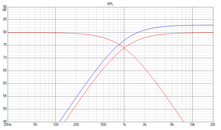

so bell curve peaking @ 2k 6db slope…….my heils can cross at 800 12db so that should be able to work the way you explain. 2x4hd should be able to handle all involved with the basics…..not too sure about the matrix setup.
actually 500uS is roughly 6” in distance so just setting the heil back that far from the baffle on the top of the mains should do it…….might just need to throw a series cap and inductor on the heils dialed @ 2k for the bell curve, wired l/r r/l and inverted polarity like I mentioned, level could be adjusted with amp gain (they have their own 60w x2).
Would that give a rough idea? Or is the matrix absolutely necessary?

Just a couple of cautions. 12dB/Oct crossover without the woofer will have a different phase response, and generally the composite of both drivers and the crossover is optimized to minimize this. If you just kill the woofer, will may not get the same phase response. Don't forget the top of the bell curve too.Thanks jaddie, I screen shot that and saved to my file for that project.
Yes, the series cap would be a better way to go. Amp gain is your level control.actually 500uS is roughly 6” in distance so just setting the heil back that far from the baffle on the top of the mains should do it…….might just need to throw a series cap and inductor on the heils dialed @ 2k for the bell curve, wired l/r r/l and inverted polarity like I mentioned, level could be adjusted with amp gain (they have their own 60w x2).
500uS is definitiely about 6", but the key is knowing where the radiation centers of the speakers are, the 0 time point, of both speakers. Normally you'd get that with measurement unless the additional speakers are identical models to the mains. But you have the right idea, there just might be some inaccuracy in the method. Getting the delay wrong will have an effect on how well this works because we're working with phase cancellation, and just a little difference in phase (time in this case) moves you away from the null pretty fast. So you can do the cut-and-try method of moving the new pair forward or back an inch at a time and see what happens. There should be a sweet spot. Use some highly separated material to test this.
The matrix is a different way to get the cancellation siganl, not technically more precise, in fact much more general beause it doesn't address the crosstalk that happens for center-panned instruments or sounds. They still present a crosstalk problem, and a resulting response null. What the matrix difference signal does do is create a more general correction, with some collateral ambience "recovery". It's another method, it will expand the soundstage too, and will be more clearly audible outside of the critical listening position.Would that give a rough idea? Or is the matrix absolutely necessary?
If the matrix is beyond what you can do, go for the simple method first. It technically is more precise anyway.

In addition, when setting gain this way the crossover frequency changes with level.Amp gain is your level control.
Um...I don't think so. The crossover is fixed at the speaker. The amp gain changes level only because it's at the amp input.In addition, when setting gain this way the crossover frequency changes with level.
Three factors are linked.. the response, level and crossover frequency. All three curves shown here are LR2 @ 1kHz...
Allen, not if you're using one extra tweeter (per channel) for cross talk cancellation. It isn't in need of a complimenting woofer.
It's a separate bell shaped signal shaped around 2 Khz that can be changed by the amplifier gain to adjust the level of compensation.
Moving it backward/forward in position with regards to speaker placements adjusts it's delay.
