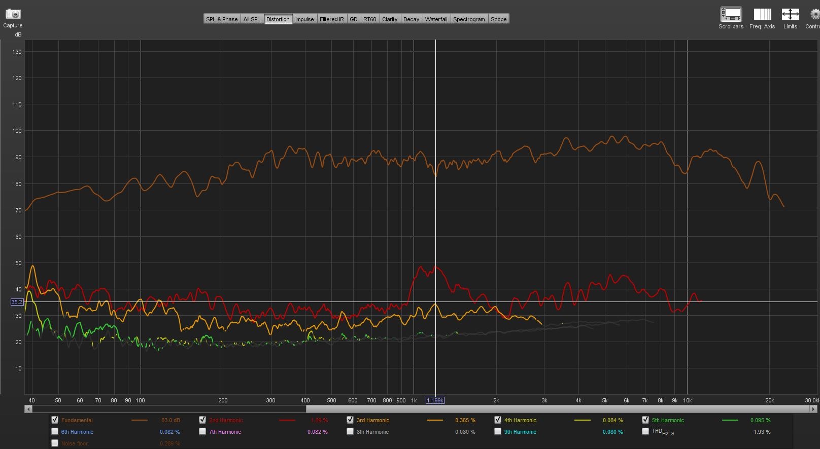

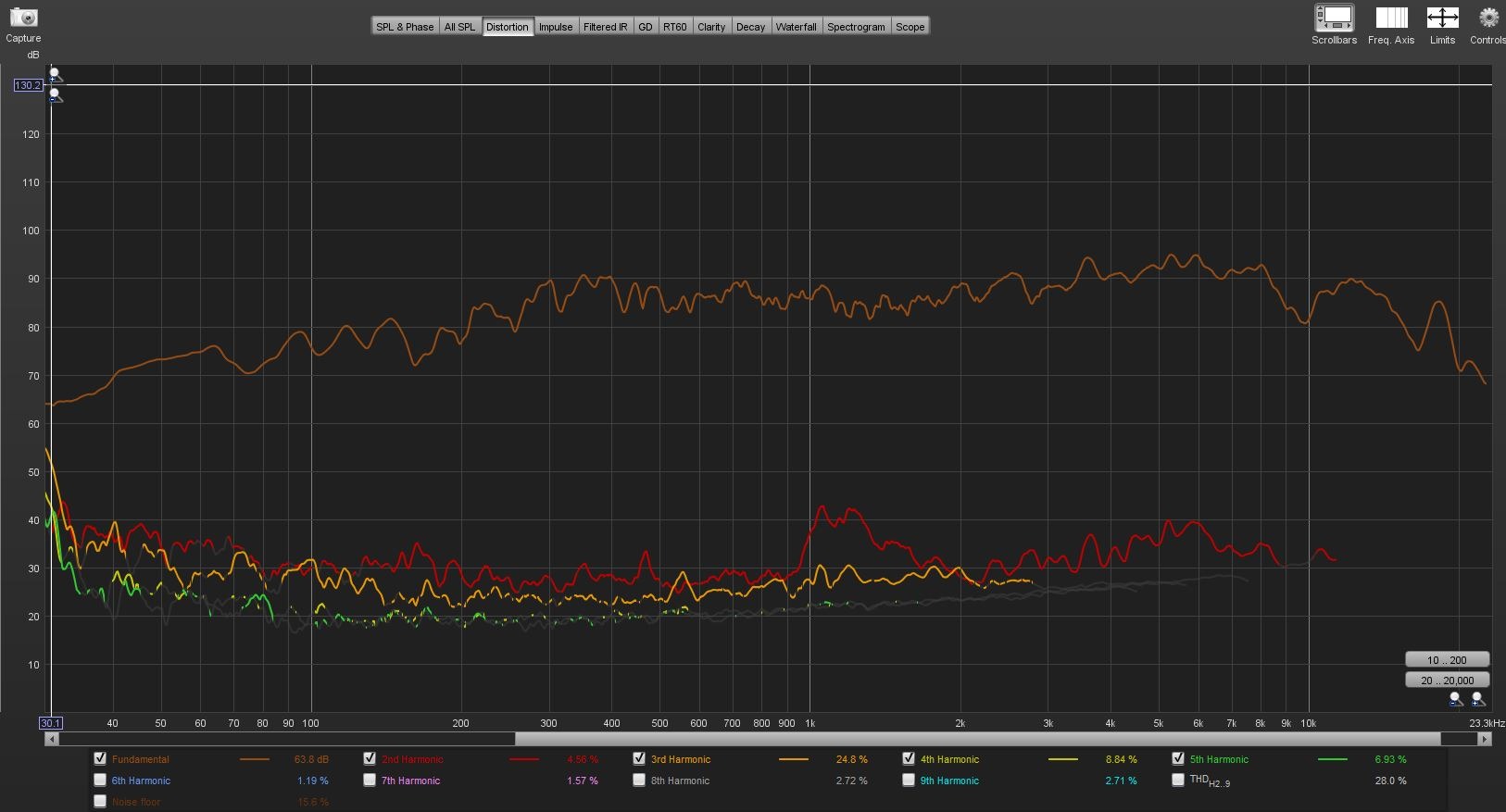

OK so I made a quick measurement of the driver on baffle. Please keep in mind that I have no idea what I am doing here so measurements are in room with no gating. Baffle is 35cm wide and driver is 85cm from floor.

Sounds really good. Especially for a recording out in a room. Maybe with direct comparison to the original track the FR driver seems to miss some bass weight and some vocals lack body. Sounds like <300Hz might be rolled off and it might sound good with a woofer filling in. If a woofer is wanted then OB could be nice. Maybe with a good 15" OB woofer eg https://www.sbaudience.com/index.php/products/various-drivers/bianco-15ob350/ ?
