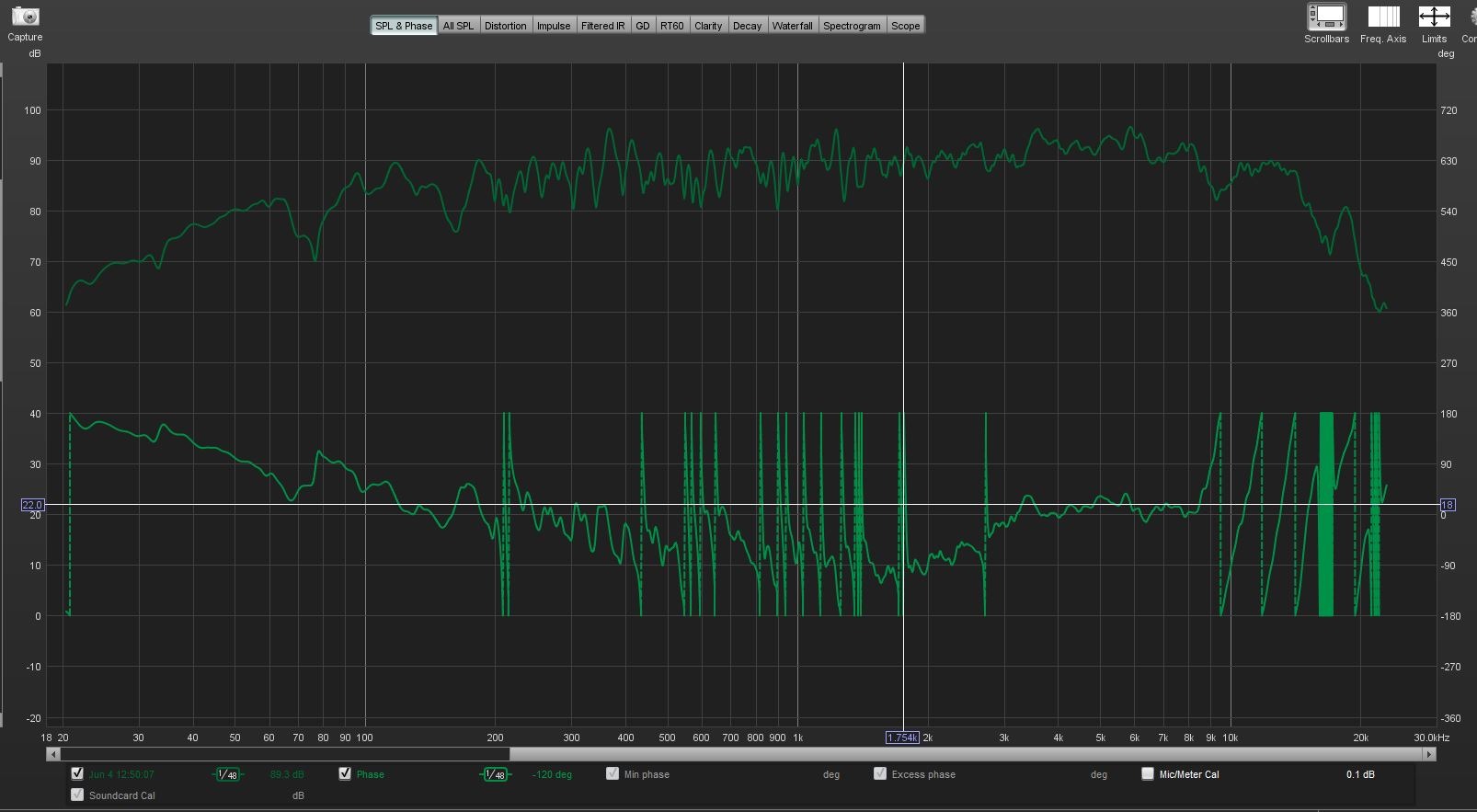

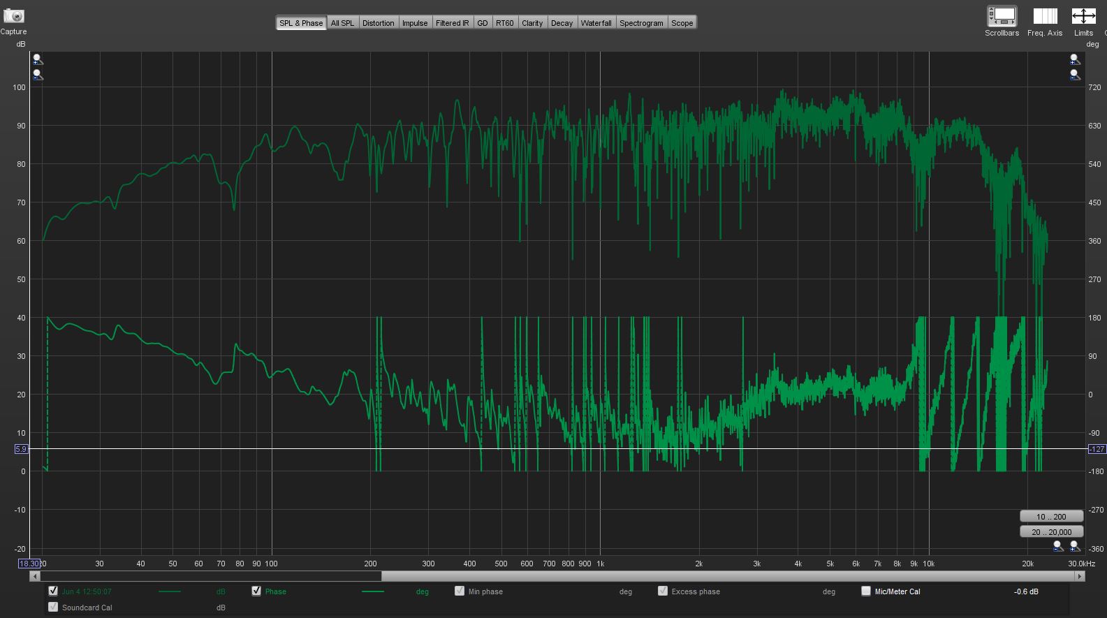

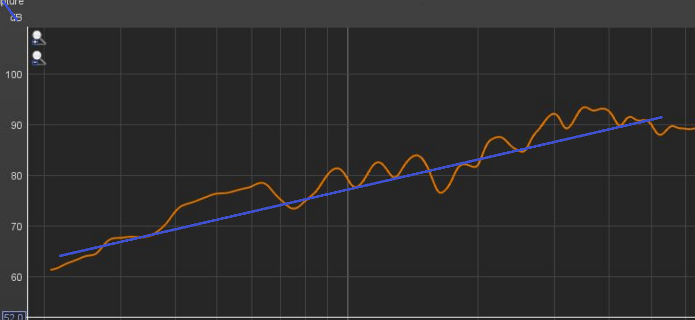

If I apply 1/12 smoothing to my measurement above it appears to be a fairly close match to the preliminary data graph (above 300hz at least). Not sure why I have such a large discrepancy below 300hz though, maybe room related?I have two data, but my driver doesn't know which one.

This is no smoothing data in my room(14.5m2).

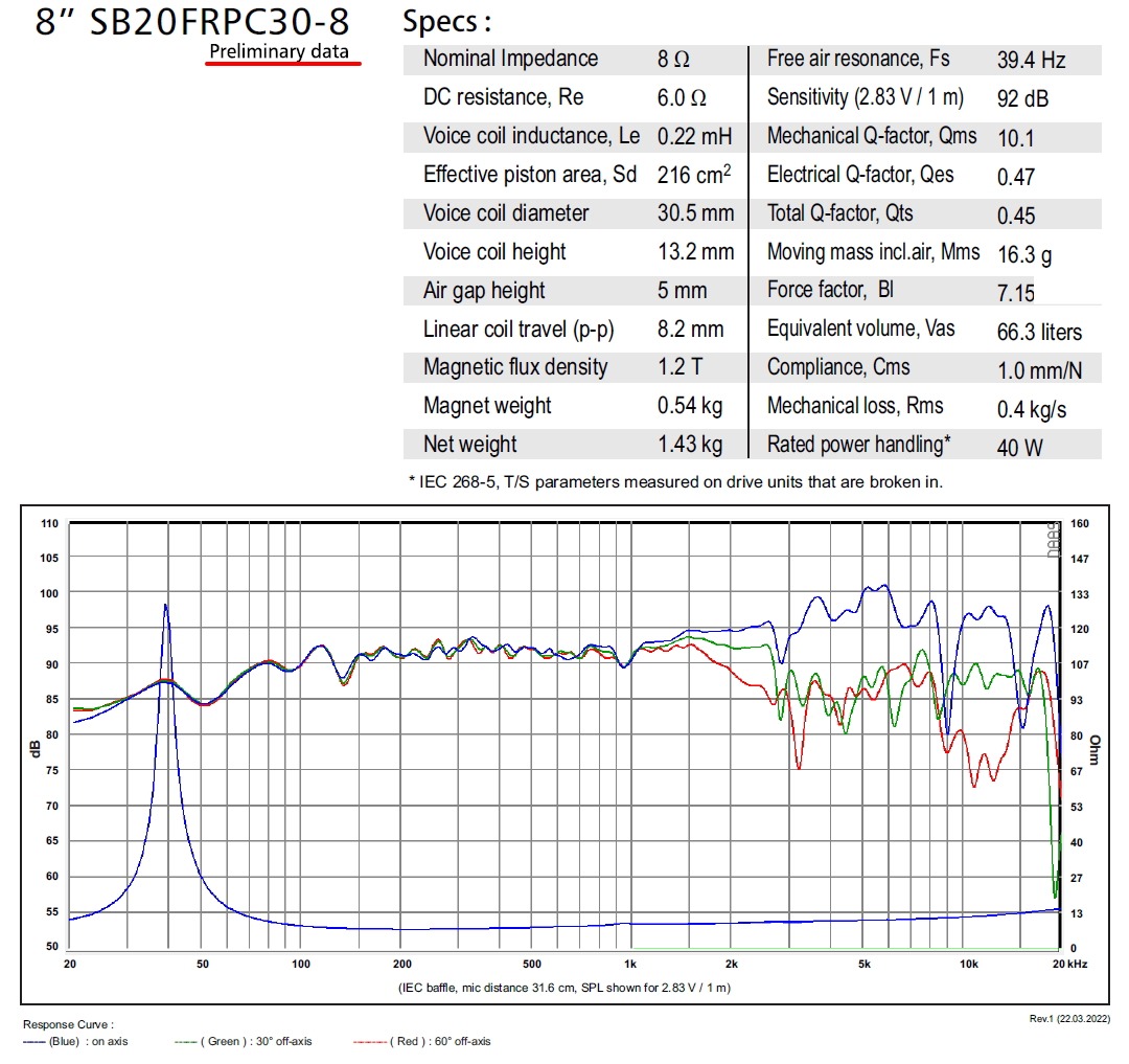

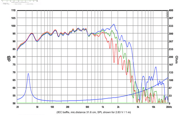

The voice coil of the old one should be a little longer/higher.I have two data, but my driver doesn't know which one.

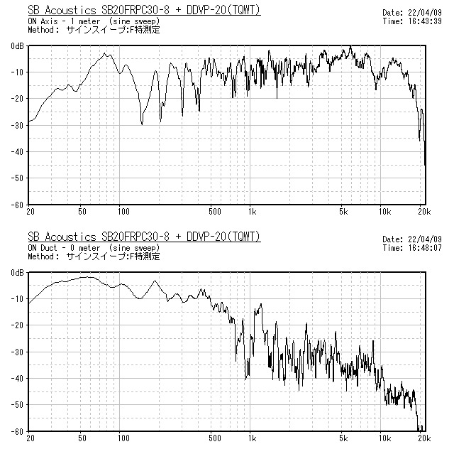

SB20FRPC30-8 / Prototype Data(11.07.2019) and Preliminary Data(22.03.2022)
The old datasheet looked a little better, slightly more xmax (5.6mm) as well as a Qt that's a bit better to manage.
The old one needed a BR box volume or around 67 liter tuned @ 39Hz.
The new one doesn't give such a nice alignment and has only 4.1mm xmax.
Nice flat impedance though

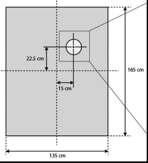

Looks like dipole roll off? Your baffle is likely much narrower and then the factory IEC baffle.
Dipole rolls off at 6 dB/oct.

Makes sense. Might try adding "wings" to the current baffle and re-measure over the weekend.Looks like dipole roll off? Your baffle is likely much narrower and then the factory IEC baffle.

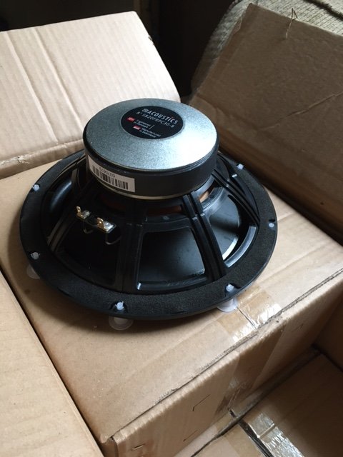

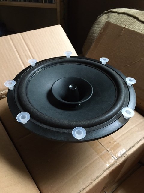

Just ordered a pair. Planning to give them to my sister with family, as my brother in law was interested in making something together.
