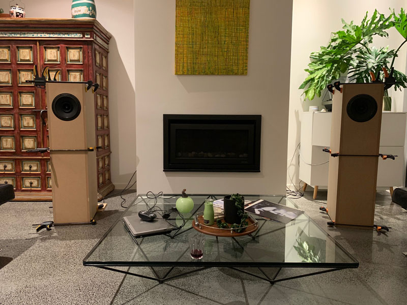

Working well in TQWT. Haven't found them overly sibilant, especially after some digital room correction. Would recommend, especially for the price. Will try them in a bass reflex enclosure as well. I know, glass table between speakers and listener not good. Also, excuse a 60+ year old man listening to George Michael on vinyl, and drinking red wine out of a duralex coffee glass. What a great hobby we have. Stay safe all!

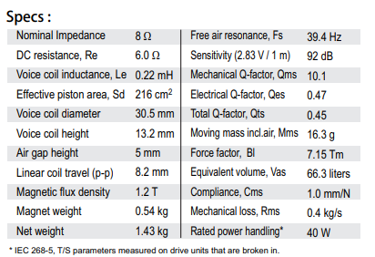

Would these have any hope in a bookshelf at about 20-30L?
I'd be aiming for 50hz tuning if possible.
My personal opinion would be that if the size constraints require such a small volume, it would be better to use a closed box and add some subs.
Vented seems allright from about 50 litres to 70 liters, no deep bass but you can use a nice controlled roll off to get a bit of 40hz.

You need BR 40l to get a 50hz-3db.I'm still trying to learn about modelling etc and will try and model these drivers when I get some spare time.
BR 30l 60hz-3db
Closed 30l 70hz-3db

The only problem is the Vas.Thanks for the responses guys.
Does it need as much volume as it does, due to it's own size? I ask as I've seen smaller drivers (4-5") being tuned to 50hz in things like the XRK Karlsonators and Dave's Monkens.
Would a different alignment like a TL cut down the volume?
Still in the very newbie stage and I was hoping these guys would be a good budget experiment point.
It is to big.
Small parameters problems.
Needs a bigger box.
Ideal box is 86 litre 30hz-3db
Combination of Vas and Qts. Vas alone gives an indication, but Qts is also very influential.The only problem is the Vas
@Mitch311 it's a 8"driver, it will always require more volume than any compareable 4-5", there are some benefits to a slightly bigger box though, for instance efficiency.
If you choose Alpair 11MS you will get 50hz in a 12 litre box!!Combination of Vas and Qts. Vas alone gives an indication, but Qts is also very influential.

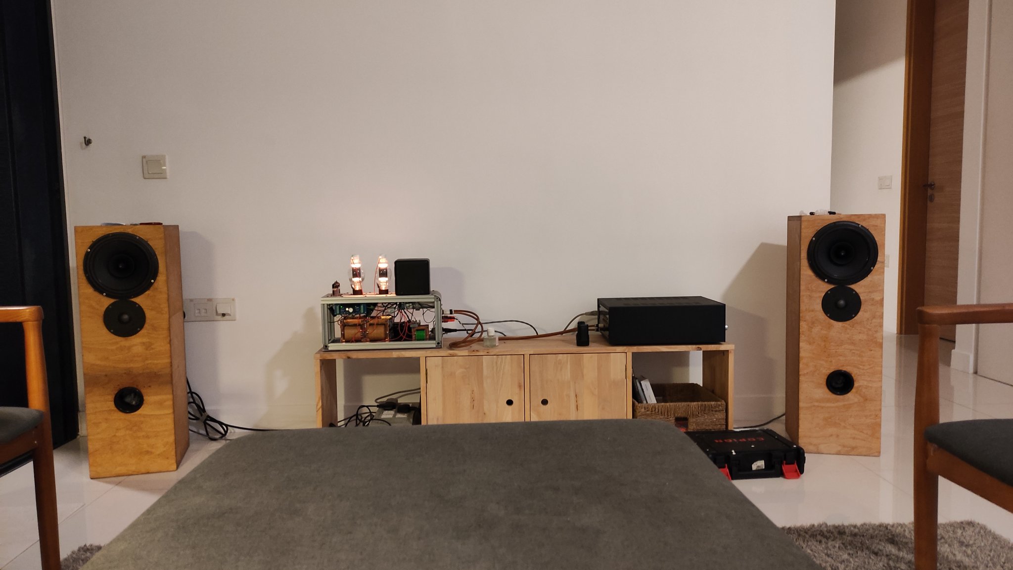

Cool design Freddi,hey X - here's two cubic foot of airspace and a cabinet which might get around BSC (? 🙂)
I like the idea of having horn loading where there is a lot of music power in the upper bass. But what will happen to the high frequencies in a design like this?
