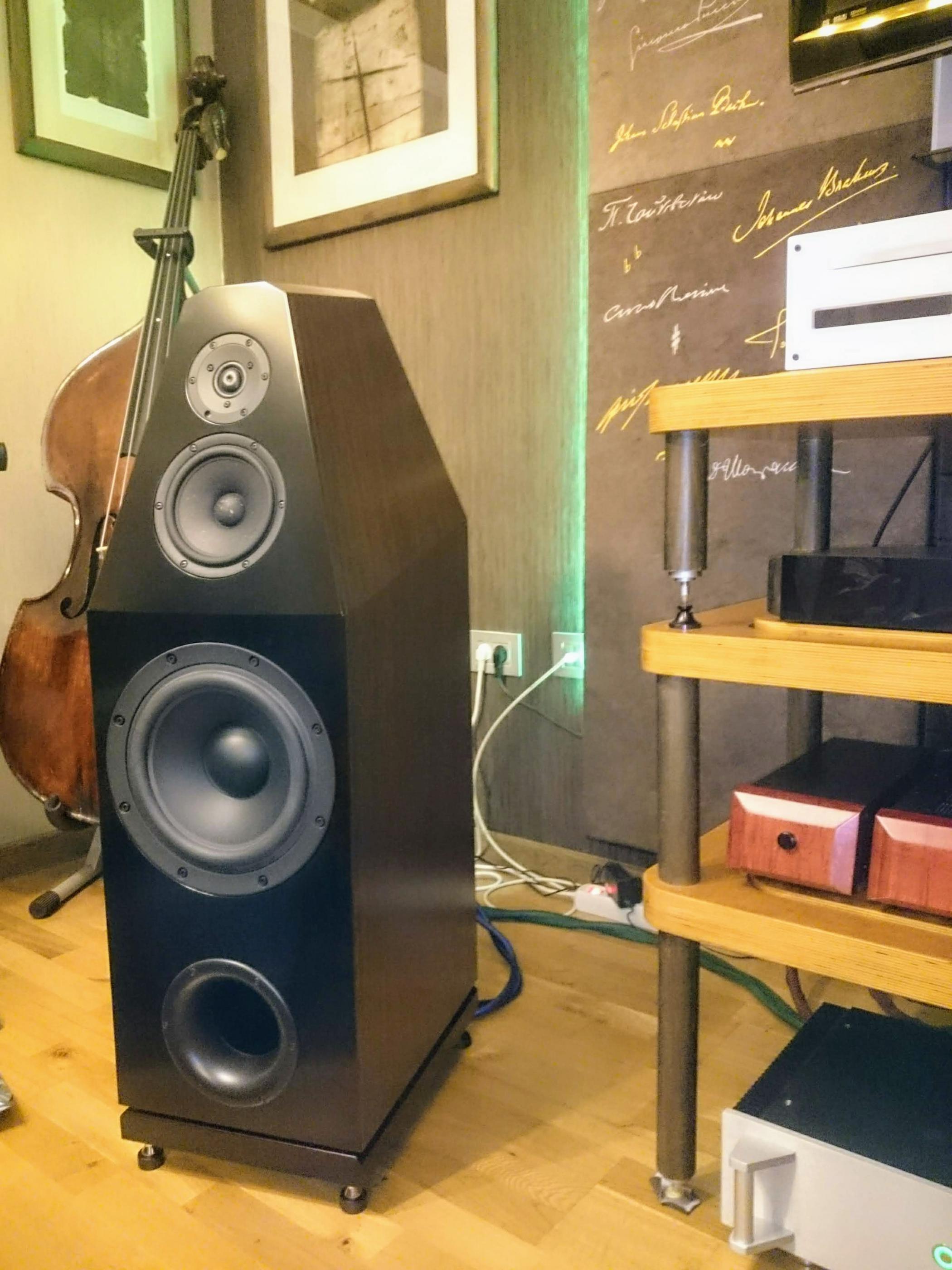

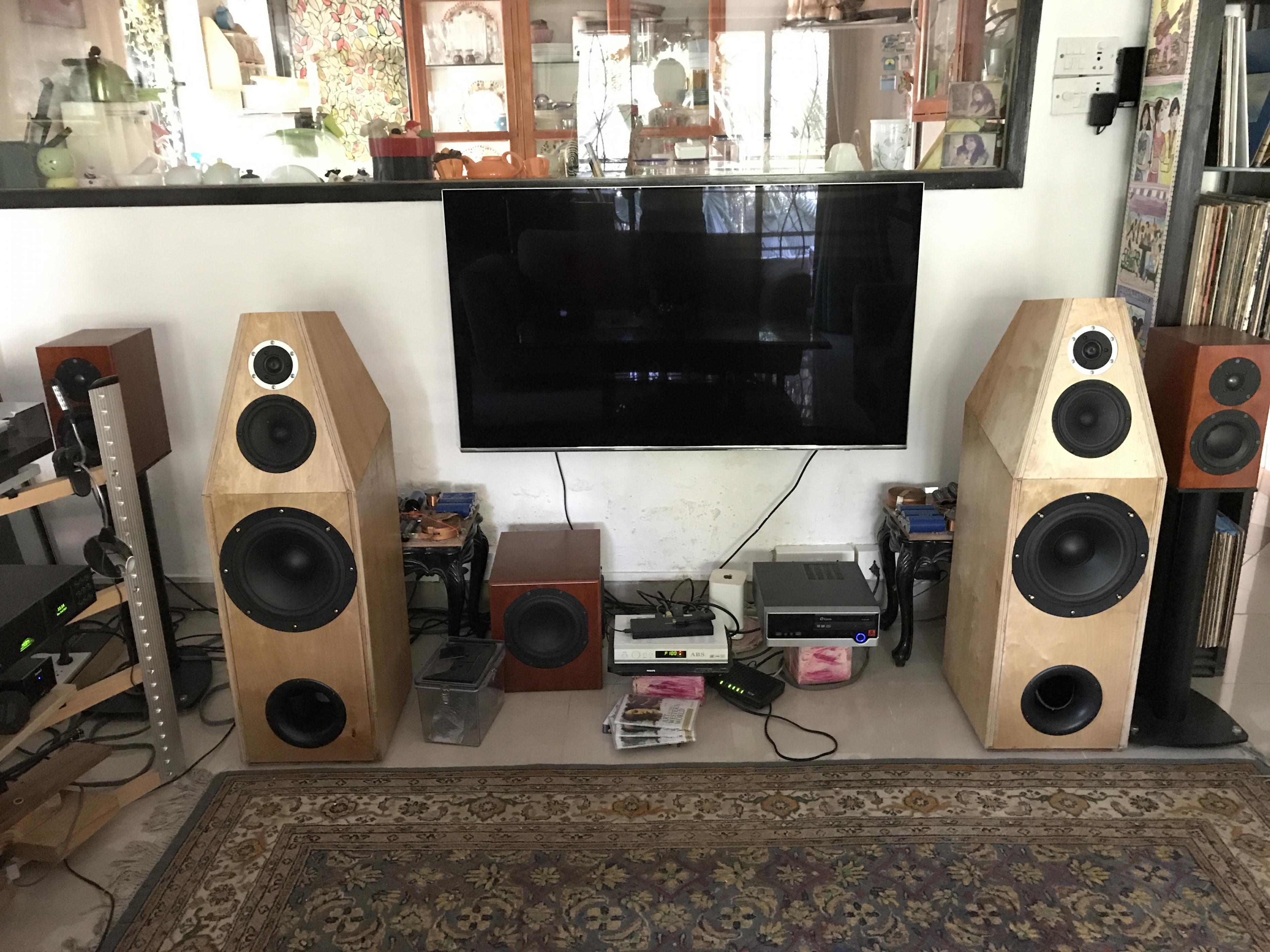

The (almost) complete cab, and they work - beyond expectation!

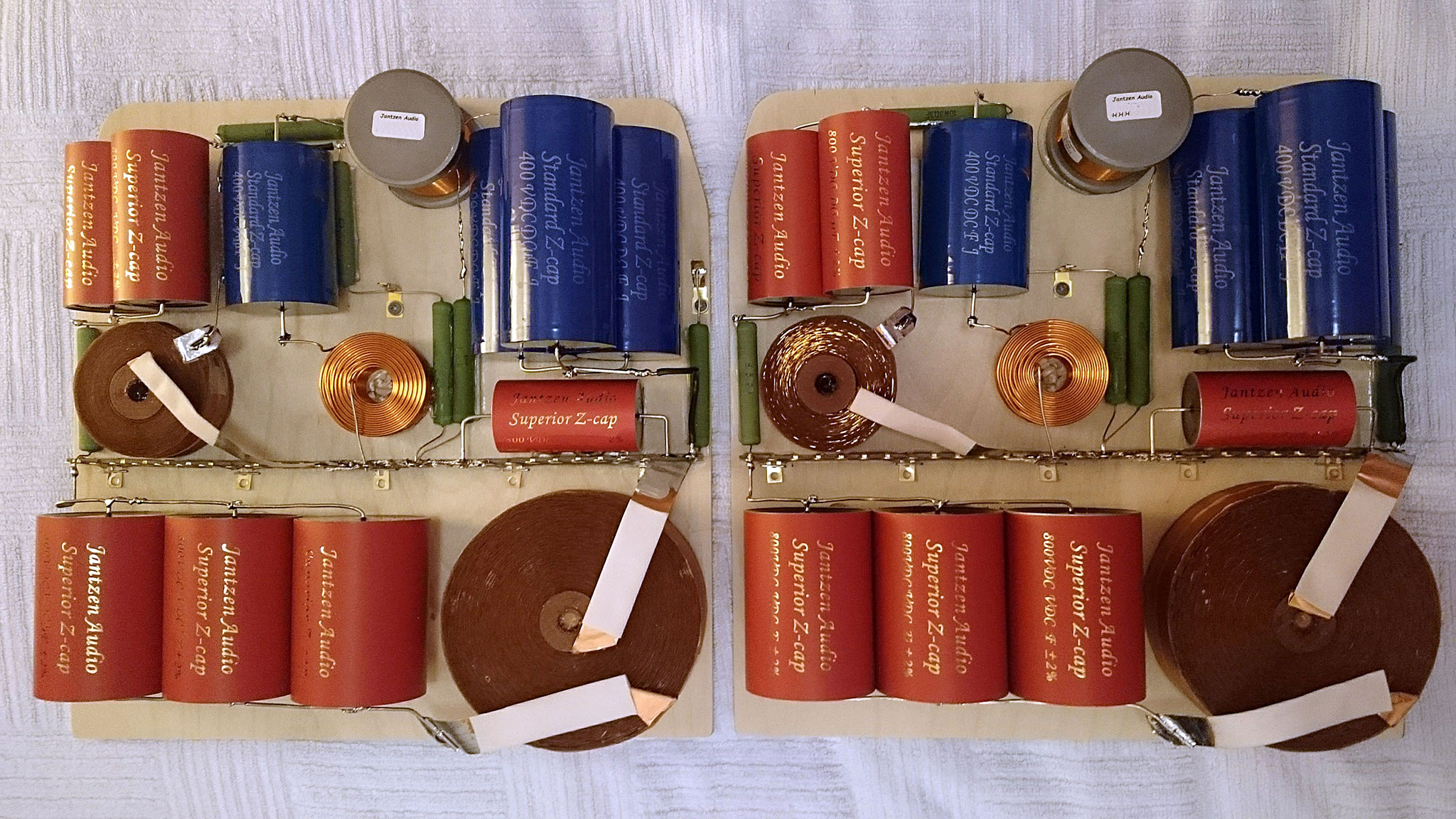

Entrails hanging out (x-overs, served on small tables).
I realised how good the SBA10 is when I dismantled them post-audition so as to complete them. For the moment, I do not feel like listening to my Totem Model One Signature + Totem Storm sub. Honest.
External finishing subsequently completed.
Cabinet damping, bass port installation and cross-over mounting remains, as also fixing the wooden bases.
Rajeev.

WoW Really Cool! I'm hesitating between building these ones or the Ekta MK2
What level option did you choose (1 / 2 / 3)?

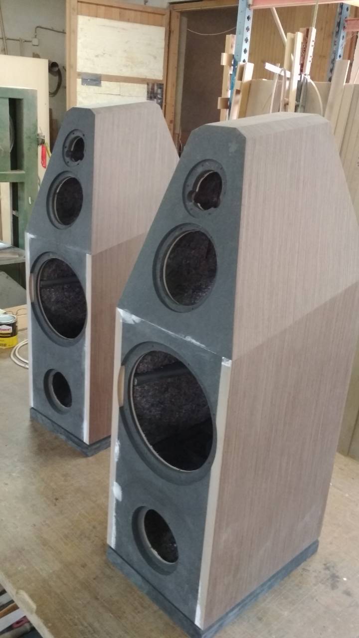

Congrats!!! I'm really excited to read that you are so satisfied with the sound!

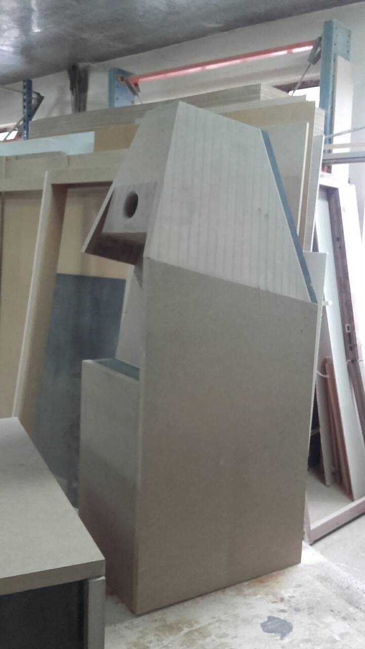

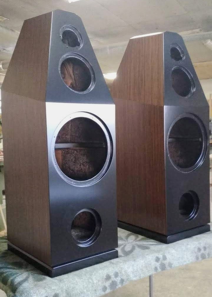

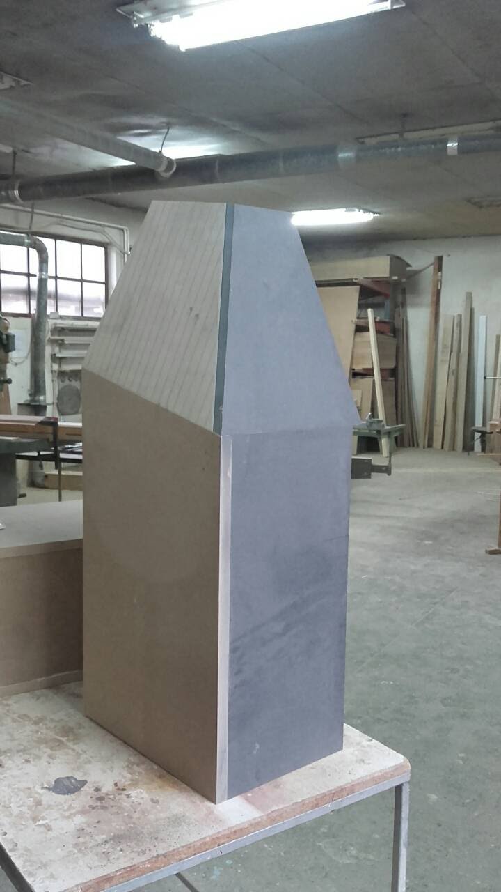

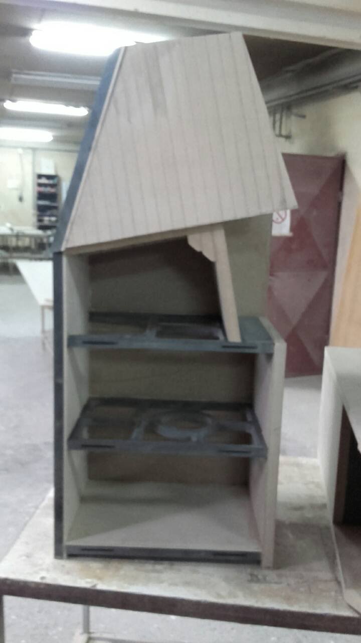

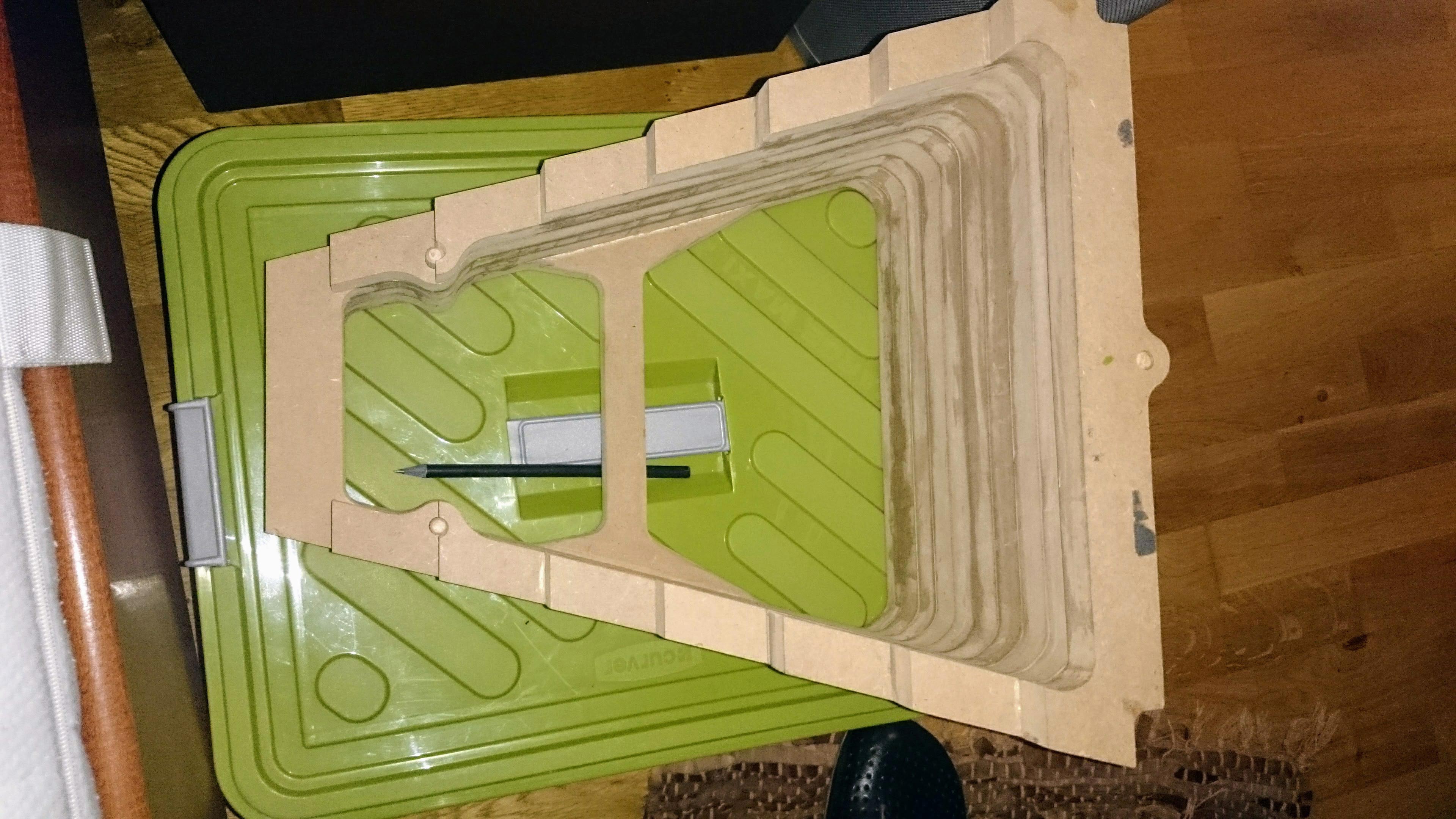

Btw. I'm also showing some progress finally. CNC showed to be quite a challenge...
CNC for pyramid
That looks wonderful to me, how did you/they solve the undercut problem? Did you flip them over or are you going to do that finishing using non-CNC methods?
Also are you using ply, or planking? I imagine finishing ply in this manner may be quite demanding. I’m talking as a person with less than rudimentary carpentry skills.
Regds.
Rajeev.

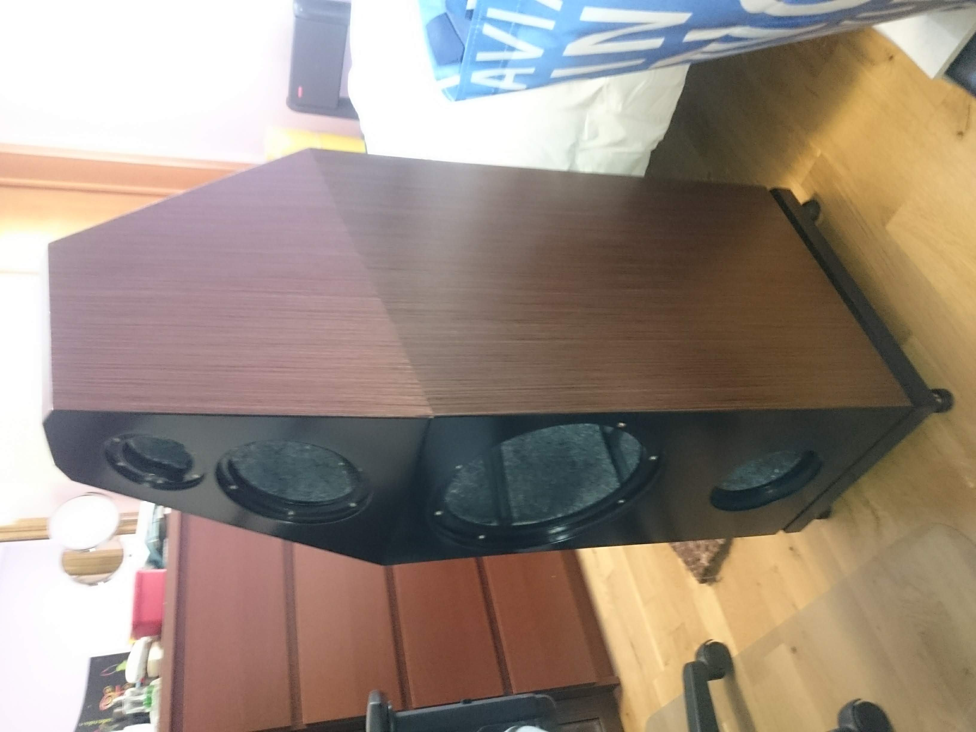

My current progress with SBA 10

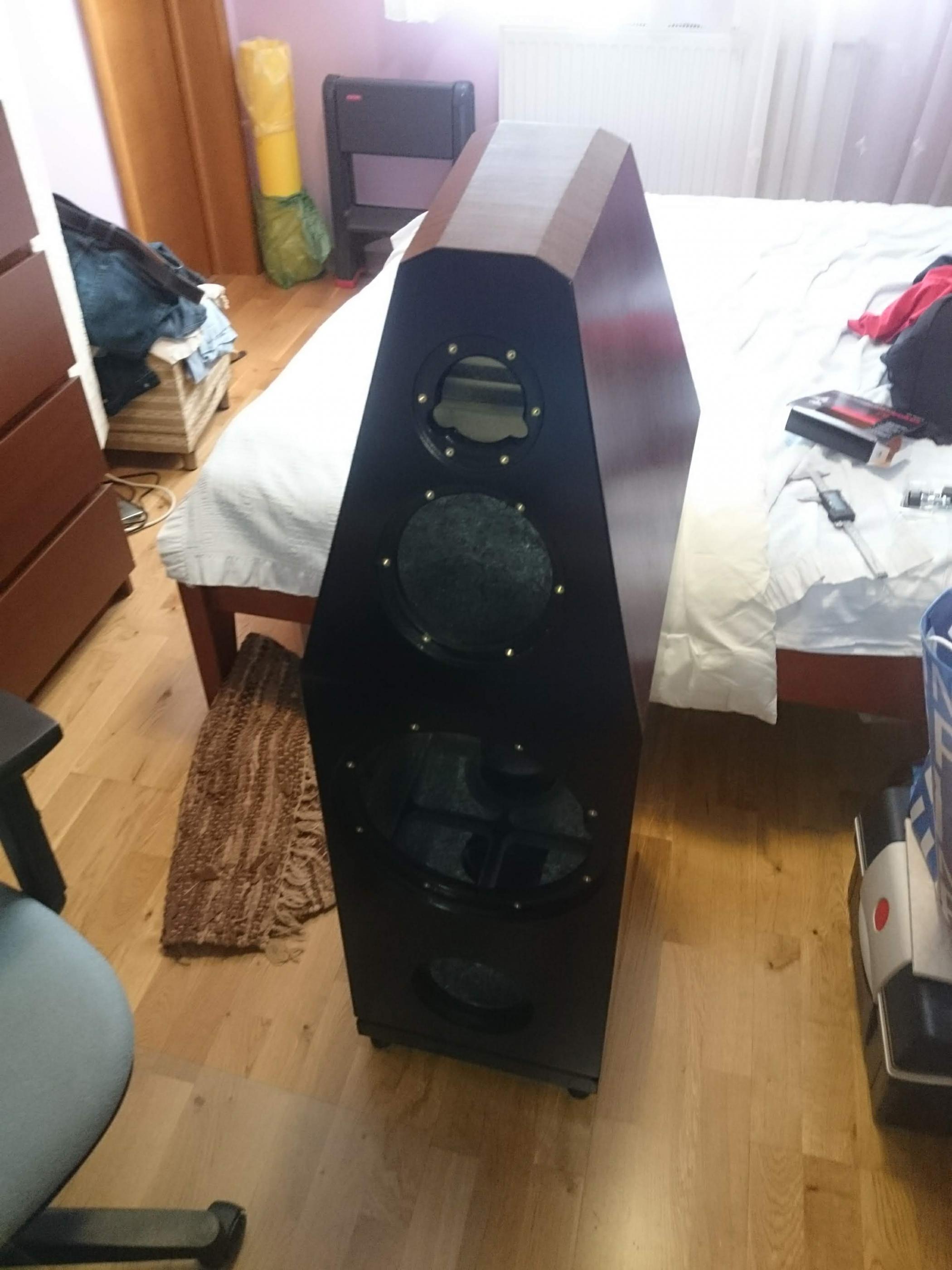

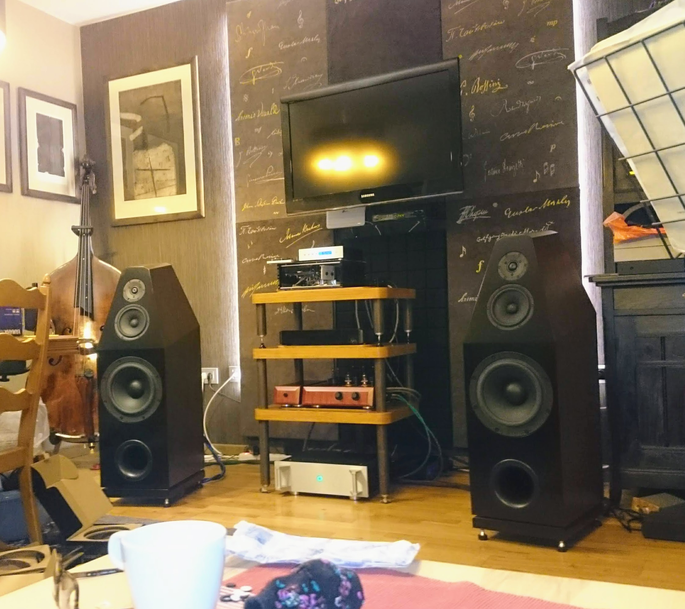

Finally done!!! 😀
