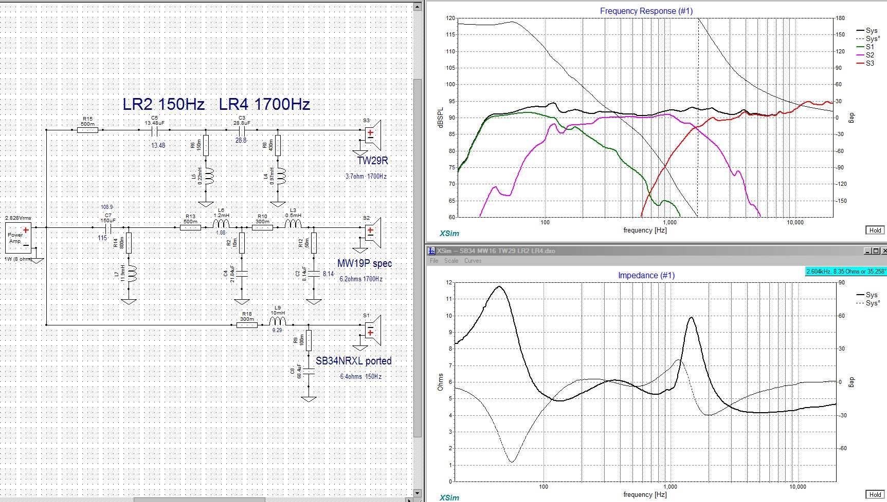

The 7" Satori MW19P-8 looks capable of good performance with the same 1600-1800Hz crossover range as the 6" MW16P-8, but with ~1.5db higher sensitivity. The 91db sensitivity 12” SB34NRXL75-8 provides F3=30Hz bass in 3cuft ported cabinet.
A quick Xsim confirms a good SPL level match for: SB34NRXL75 + MW19P + TW29R. The Zmin dips to 4.2ohms, but just for the low power tweeter.
The MW19P 7" midbass might find a "just a little bigger" niche in diy-designs.
