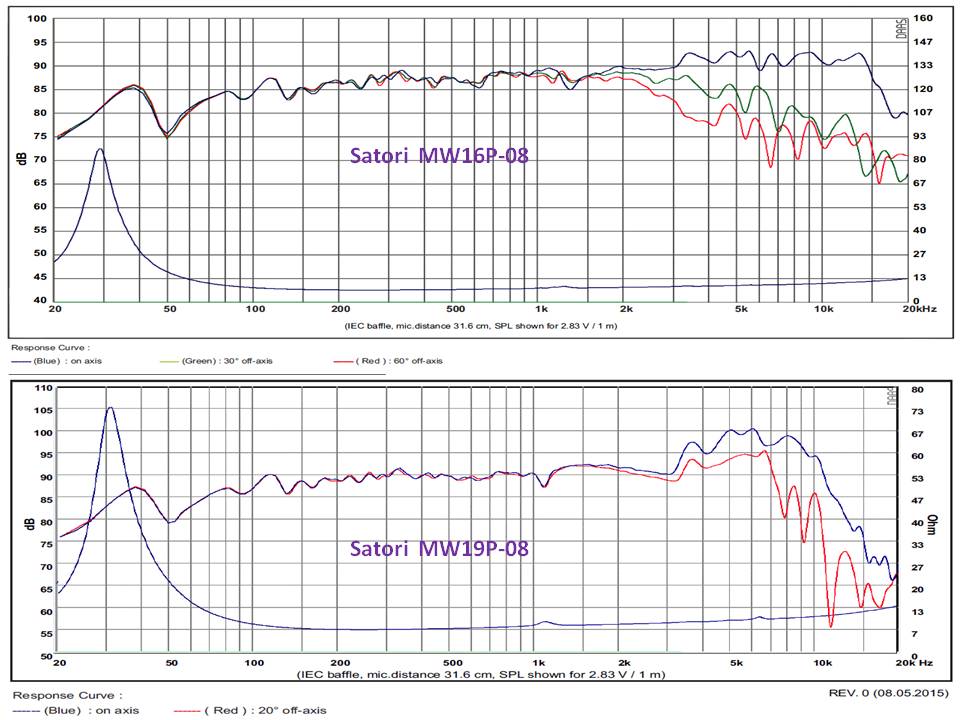

The extended high frequency coverage above 3kHz on the MW16P comes with 5db wiggles and waggles, and normal beaming effects for a 6" cone extending all the way to 10kHz. My normal TM crossover philosophy for a wide bandwidth mid(MW16P) is to use LR4/LR4 to assure at least 20db attenuation of the 3kHz+ MW16P wiggles and waggles. Wide BW midrange often fit the textbook LR4 filter. The MW16P starts to beam at 1600Hz. The TW29R has an Fs of 600Hz and is -3db ~500Hz. With proper baffle size and tweeter positioning, a textbook LR4 often works for Xovers between 1600Hz - 1800Hz. LR4/LR4 at 1700Hz for the TW29R+MW16P looks interesting....flat baffle? 21mm stepped baffle?.

The 7" Satori MW19P-8 looks capable of good performance with the same 1600-1800Hz crossover range as the 6" MW16P-8, but with ~1.5db higher sensitivity. The Satori tweeters can support this efficiency, but the 10" SB29NRX45-8 cannot match the 90db sensitivity of the MW19P . The 91db sensitivity 12” SB34NRXL75-8 provides F3=30Hz bass in 3cuft ported cabinet. A side-side pair of 8" SB23NRX-8 woofers can provide 94db sensitivity, but with a low 3.5 ohm parallel impedance without any series padding resistor.
