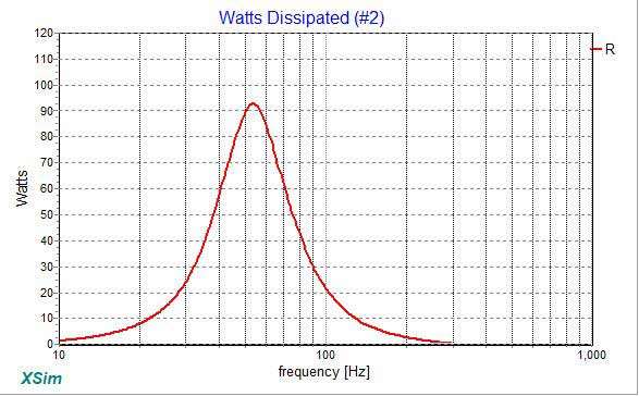

Again I agree 🙂 Bi-amping would be my first choice but its not exactly a cheap solution :cannotbe: And for dissipation on L-pad I was surprised that X sim etc. shows much much less dissipation from existing R11, and again I have planned to make one just as trial to hear where it takes me...

dissipation on 10W resistor @100W
The data XSim is showing for power dissipation is inconclusive in respect to true power dissipation for it shows the apparent power dissipation. Depends on phase angle through that network branch how close or apart these two different power figures will end up being.

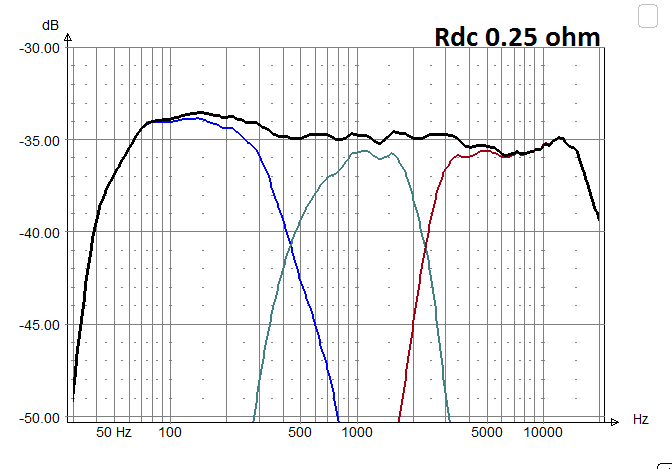

Here's how different Rdc but same inductivity of series woofer coil models on my current loudspeakers:

0.25 ohm - 1 ohm makes for 2.5dB of difference so i think that 2dB of your woofer would be easily compensated with higher Rdc coil.

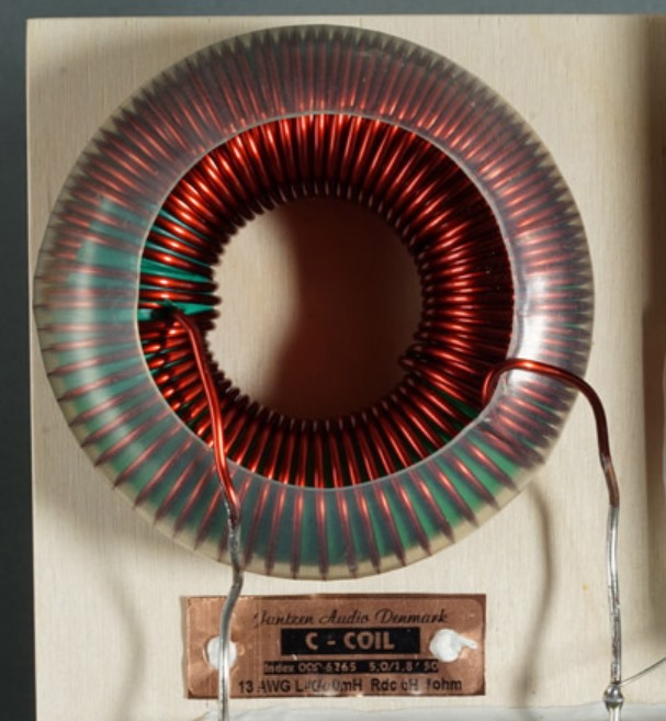

Jantzen C-Coils have very low resistance, 13AWG 22mH is only 0R15
Bass coils must handle high power, they need to be heavy wire and thus low resistance. Air cores have higher R, but how about heat then with higher AWG like 15?
Component values are not public, I used 20-22mH, check links.
This pic is from TG's website

Easily no heat with up to 1 ohm coil Rdc. Voice coil will be fryed much before series woofer inductor with Rdc of 1ohm gets near the problem. The wire is usually 1-1,4mm thick for air coils that has to be slightly higher Rdc. Wire in voice coil hardly ever goes more than 0,3mm. It gets thicker only in car subs that have 4 layer coils or any 4 layer coiled sub for that matter.

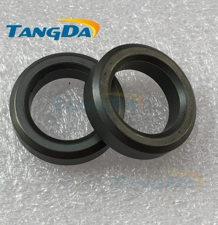

The photo is not from an air core coil, it has a ferrite core.
Impossible to reach such low inductance values without that "help", they are air core would be huge...
