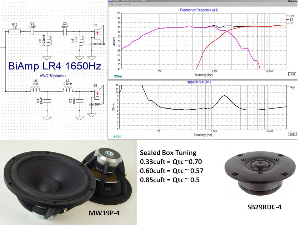

--GIVEN bi-amping: passive Xover sealed unequalized midrange + tweet, and bi-amped sealed equalized woofers. A passive LR4/LR4 crossover for the TM is not very complicated.

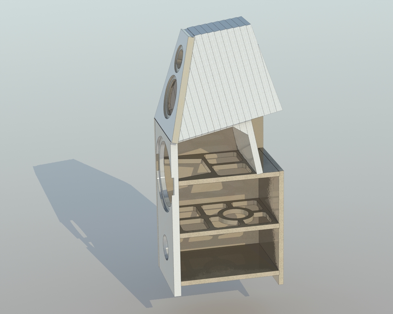

Look over Troels Illuminator Monitor construction as a beveled-top TM cabinet for the Satori MW19P-4 midbass and SB29RDC-04 tweeter. You have a few bottom woofer cabinet options.
For a single cabinet, bottom side-side counter-force woofers are popular for vibration control. There will be no mid-woofer spacing issues when you bi-amp with a woofer crossover around 130Hz.

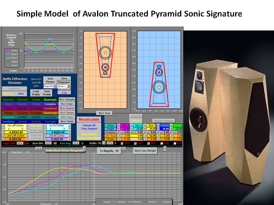

1) Irregular shapes can reduce internal box resonances.
2) The narrowing front baffle of the truncated pyramid shape can create a smoother controlled directivity function. The narrowing pyramid reduces front baffle reflectioned low frequency energy from the midrange and woofer, but maintains short wavelength forward baffle reflected energy from the tweeter. Cabinet edge diffraction creates new delayed phantom sound sources which can obscure detail in the treble. A pyramid shaped MT baffle helps improve high frequency clarity.
3) Looks cool. Avalon corp. also bevels the edges of its truncated TM pyramid in order to further reduce diffraction...and look super-cool.
4) Easier to manufacture than large radius rounded edges (e.g. Vivid), or spheres with rear truncated tubes like B&W.

Avalon's single box Eidolon and two-box ISIS are probably the best technical and artistic truncated pyramid designs. The ISIS aims the tweeter down toward the listener's ears. There are several diy-clones with construction details to study. Avalon's new Tesseract has crazy-complex angled cuts over all panels to reduce diffraction and panel resonances. Thanks to a cabinet shop wth a 3" radius edge cutter, I've joined the large-radius front baffle crowd.

My earlier post #65 has a passive LR4/LR4 for the MW19P-4 and SB29RDC-4 which can be changed for Satori TW29RN. LR4 = easy bi-amp.

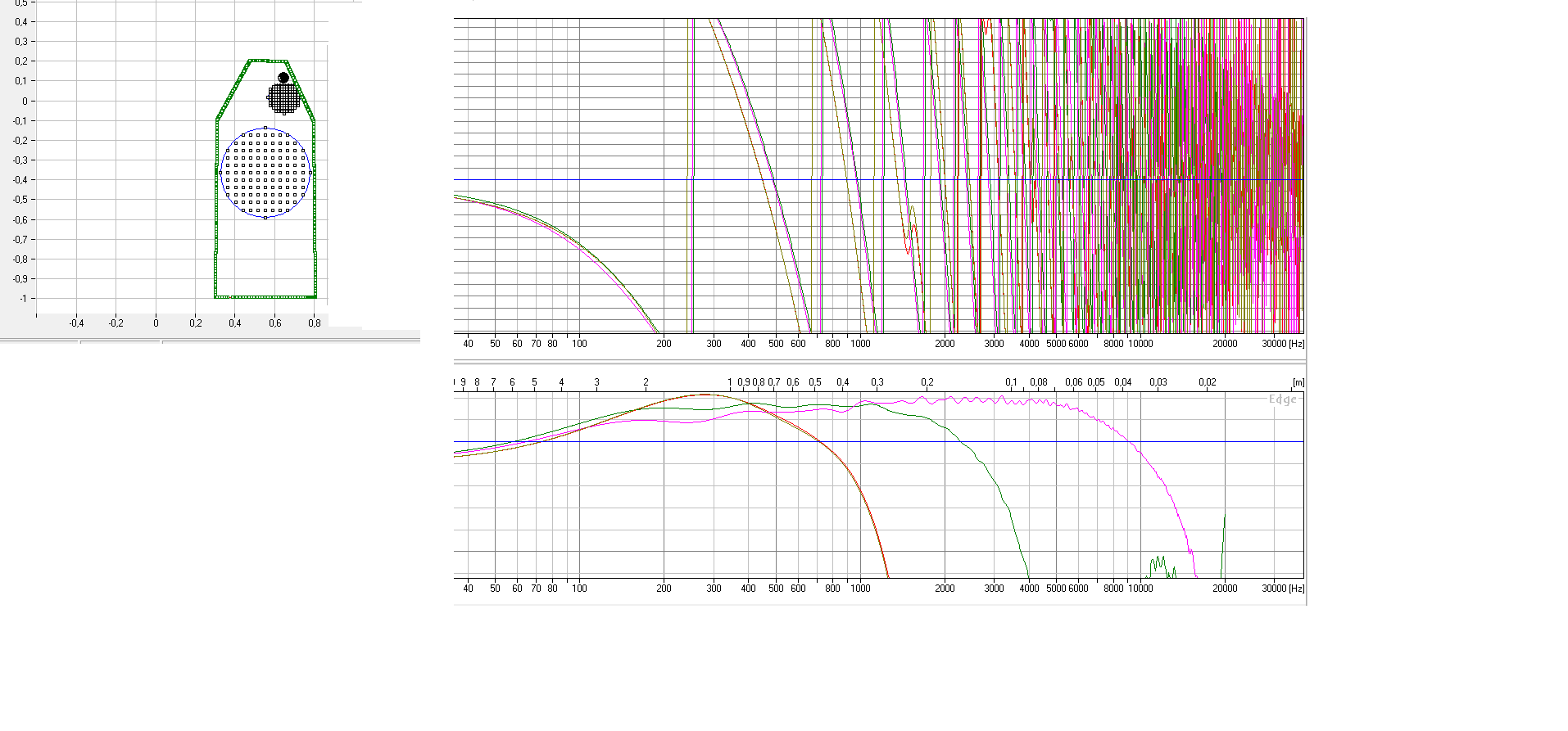

I need to do research on where is the best place to put the woofer on the baffle (height).
"Baffle Edge Diffraction Simulator By Jeff Bagby Version 1.20" combines baffle and basic floor/wall effects. For a 3-way you want to keep the mid-to-woofer C-to-C distance less than the quarter wavelength of the crossover frequency... 200Hz Xover = 17" .... and you want to keep the woofer lower than 1/4 the floor-ceiling height .... 24" for 8' ceiling to avoid resonances and floor effects in the vocal range. The simulator will allow you to tune floor and wall effects within these crude guidelines.
I use this excel sheet but I always have problem with the option : selected baffle mode and baffle diffraction modeled. I upload the analyse tool pak in excel and I still have this problem when I click on those options.

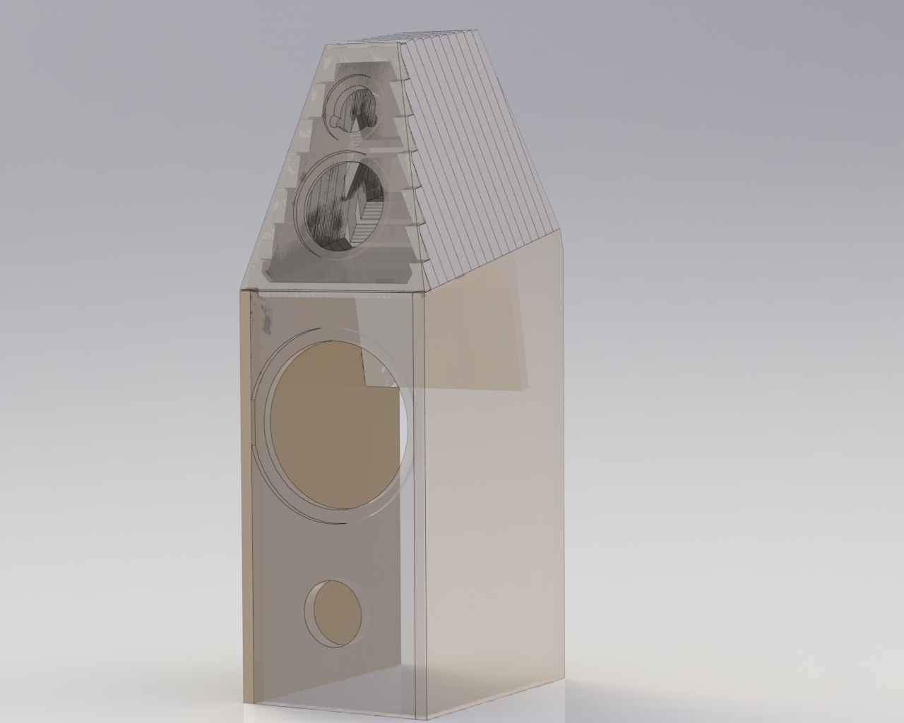

Now there is a idea for a nice big sealed box three way design using the SB42HCL75-6 the MW19P-4 and the Satori TW29RN tweeter
Now to model the bass enclosure 🙂
DM 🙂
This thread is quiet for a while. I can not believe that no one still has built Troels SBA10... At least I couldn't find no ones report online. I guess people find very hard building that pyramid on the slope for mid cab. I have was never really satisfied with the esthetics of Troels build so I tried to make it a bit Wilson Sophia like. Here is my latest drawing board progress.

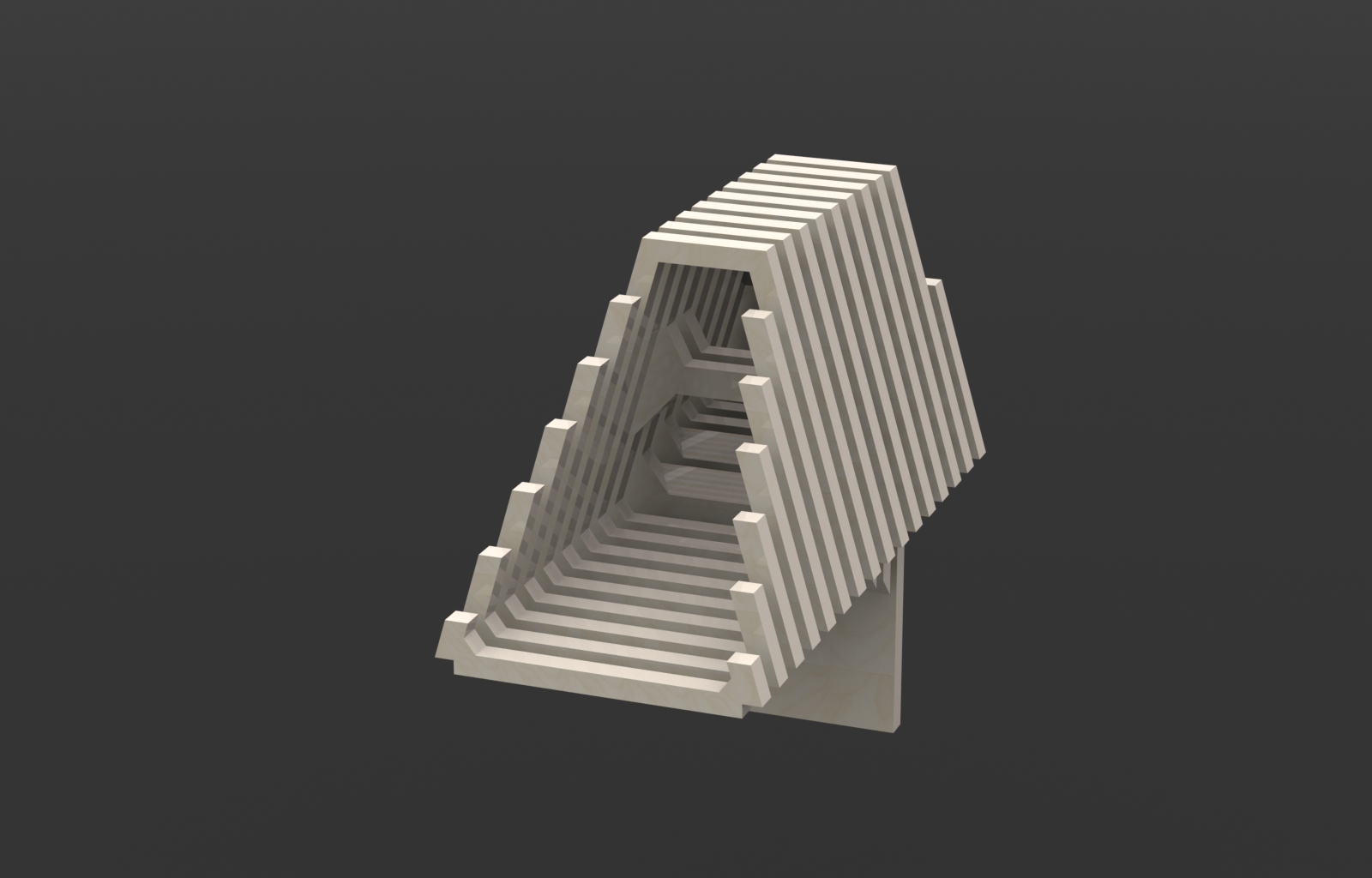

Troels' SBA10

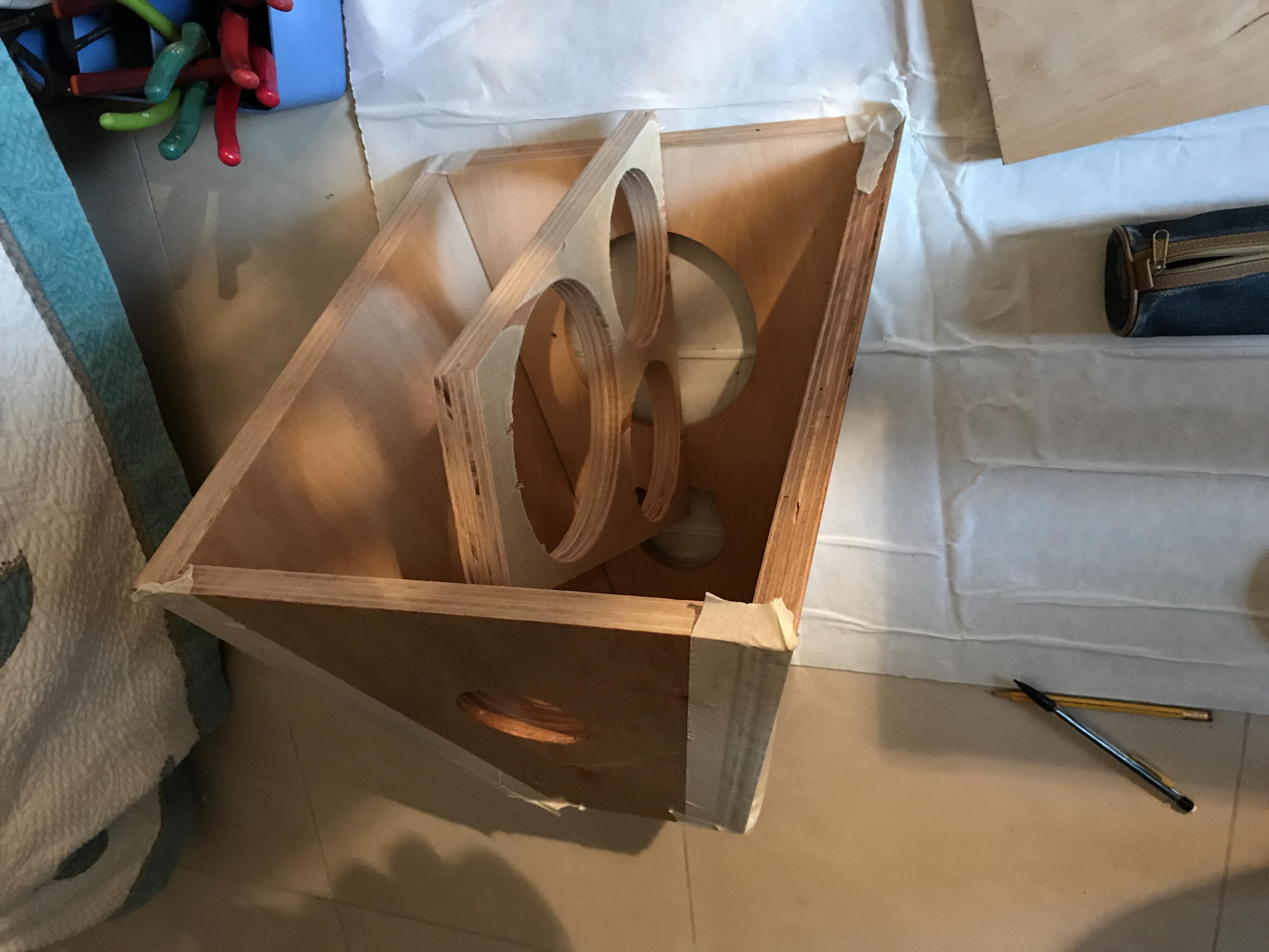

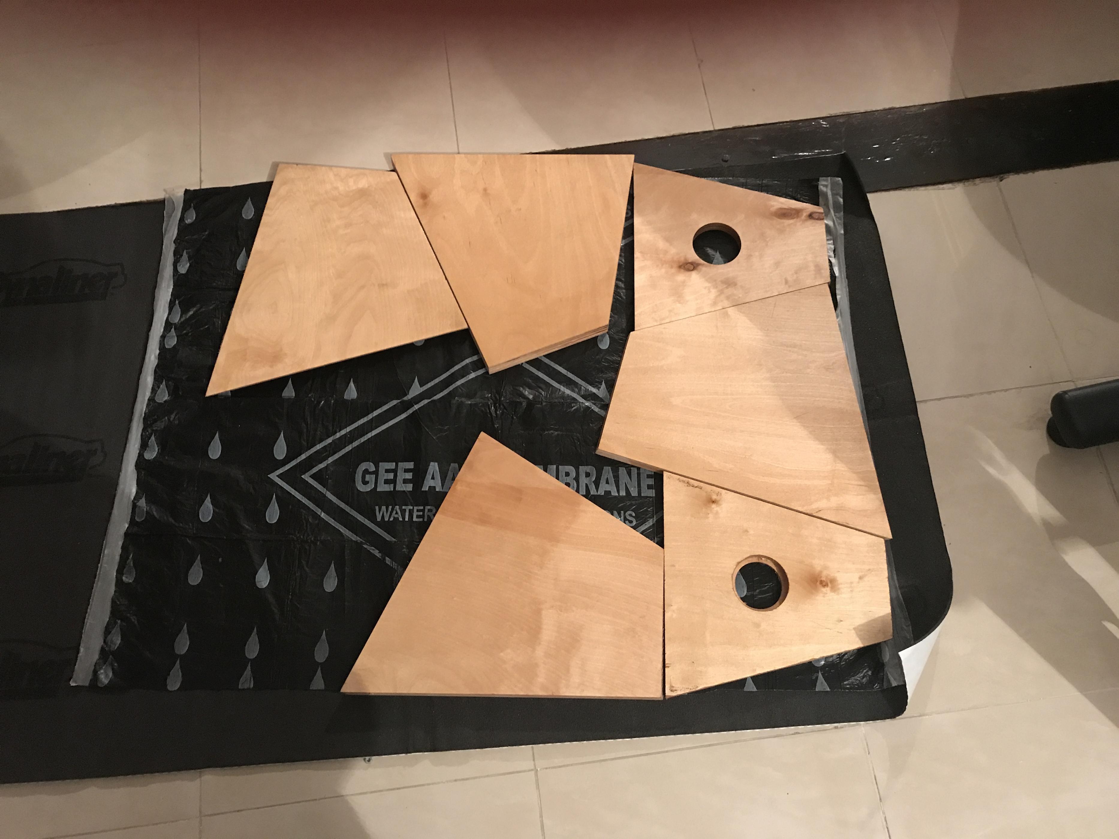

Hello everyone,
Every joint at every edge of the "pyramid" is NOT a 90deg angle. Sussed it out in CAD and finally got something that looks like flesh and blood Troels design (see attachment).
The CNC mill guy did not have the neccessary skills to do 3D milling for the topside relief where the 19mm ply is cut with a slant like a bevel sloping outwards from the top edge, let alone attempt the notorious 'undercuts' where the edge slants inwards from the top edge. Both these requirements exist simultaneously on a single panel!
So the panels have been cut to the size and shape of the smallest possible bounding box (all 90deg angles) and rely on more traditional carpentry like a table saw, chisel and planer to achieve the angles and desired shape and fit.
Mind you, this is not the glue up, yet. Just put together using painter's tape to check if anything's getting in the way of anything, and the drivers fit the cutouts. The black stuff on which some panels are laid out is bitumen waterproofing which is being used for panel damping.
Have been working at this over a year with limited time and facilities but determined to see it through in the next few weeks.
Kind regards to all'
Rajeev.
