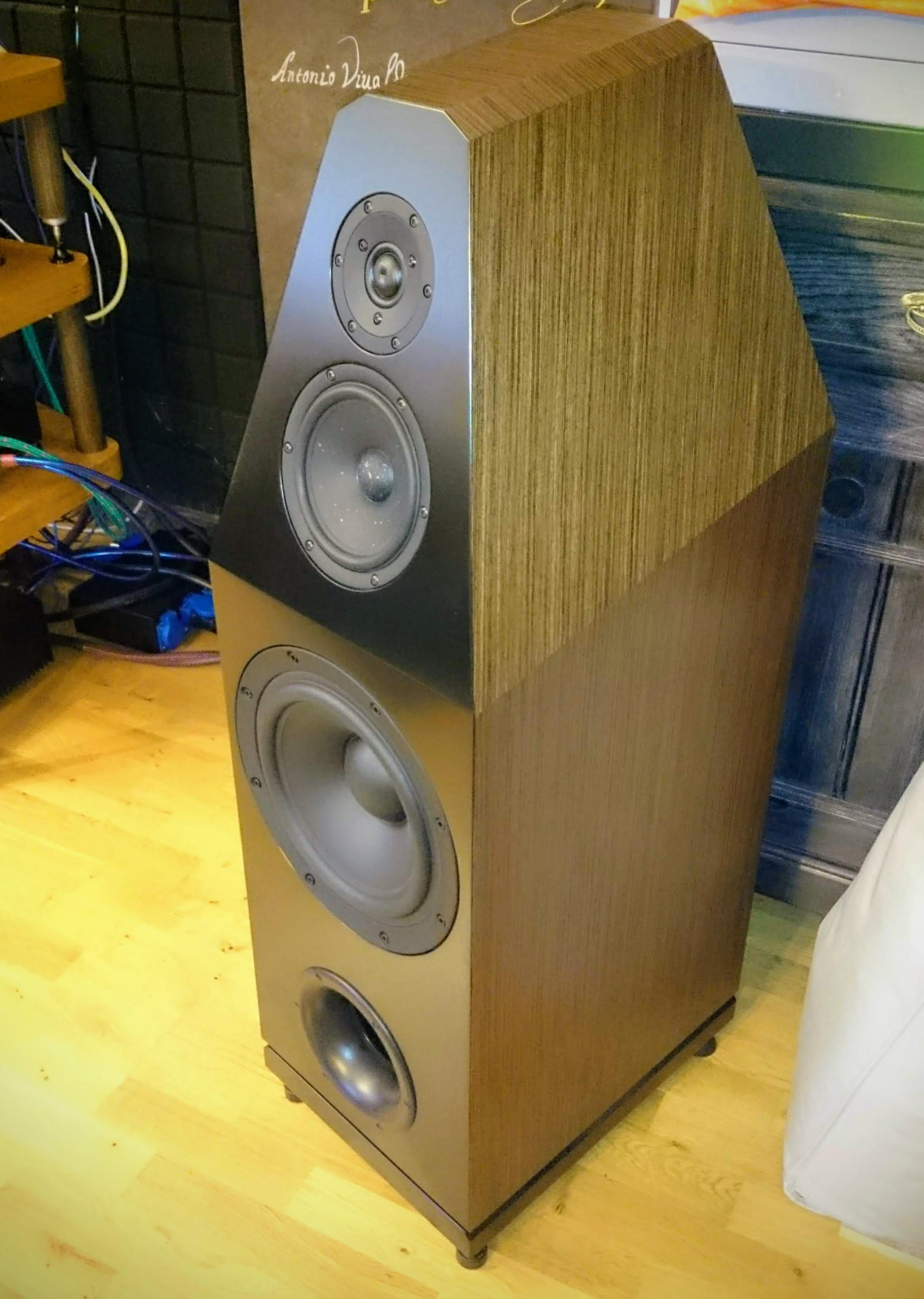

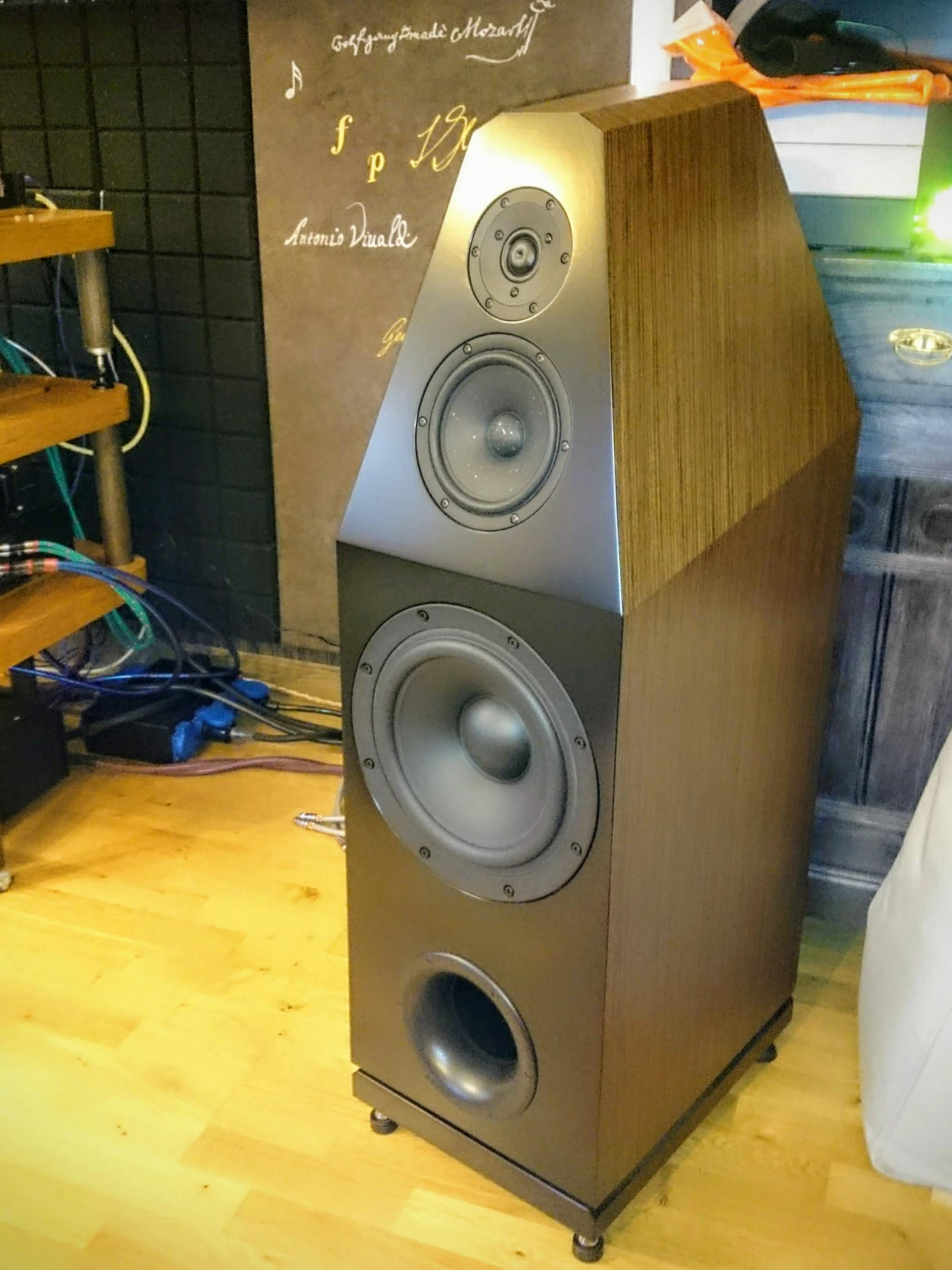

Thanks! But I can not take the credit for the finish since I have had them finished by the professional. I did the redesign of Troels design in 3D and lot of prep work and gluing but had no chance to finish it at home with two kids around. Also I have no fireplace 🙂 You probably think my room treatment panels around TV... And the veneer is walnut and not really so dark in reality

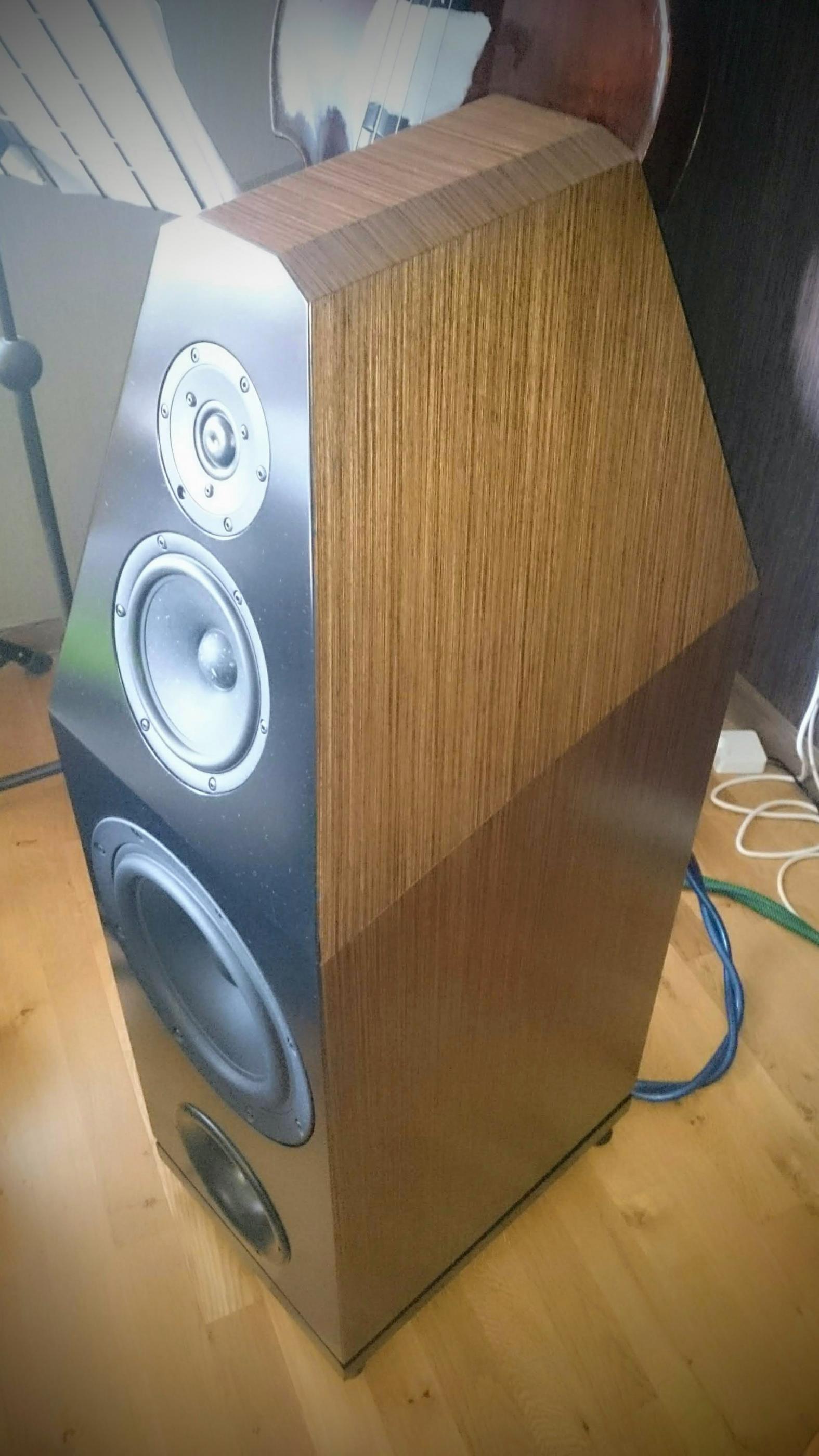

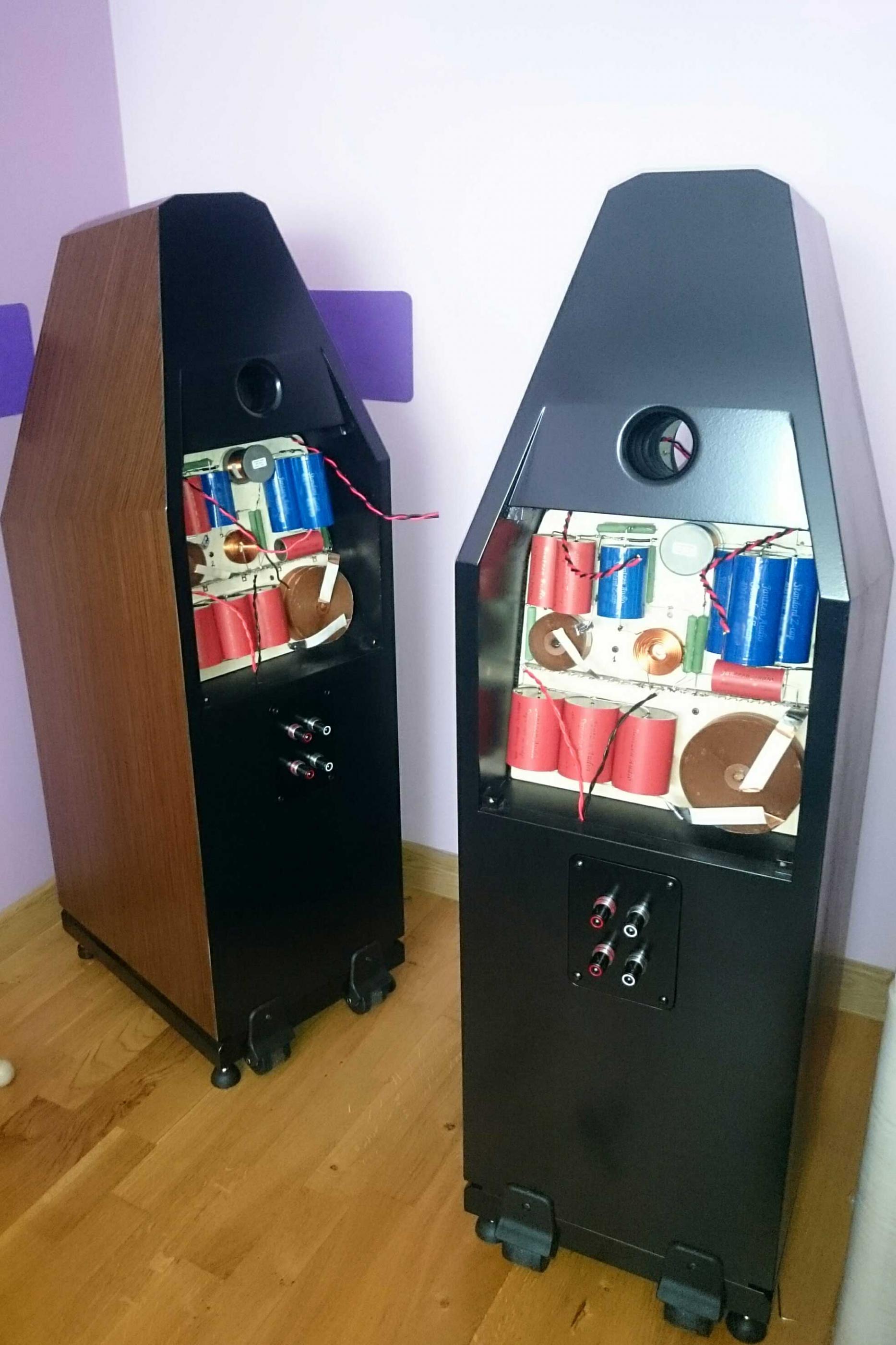

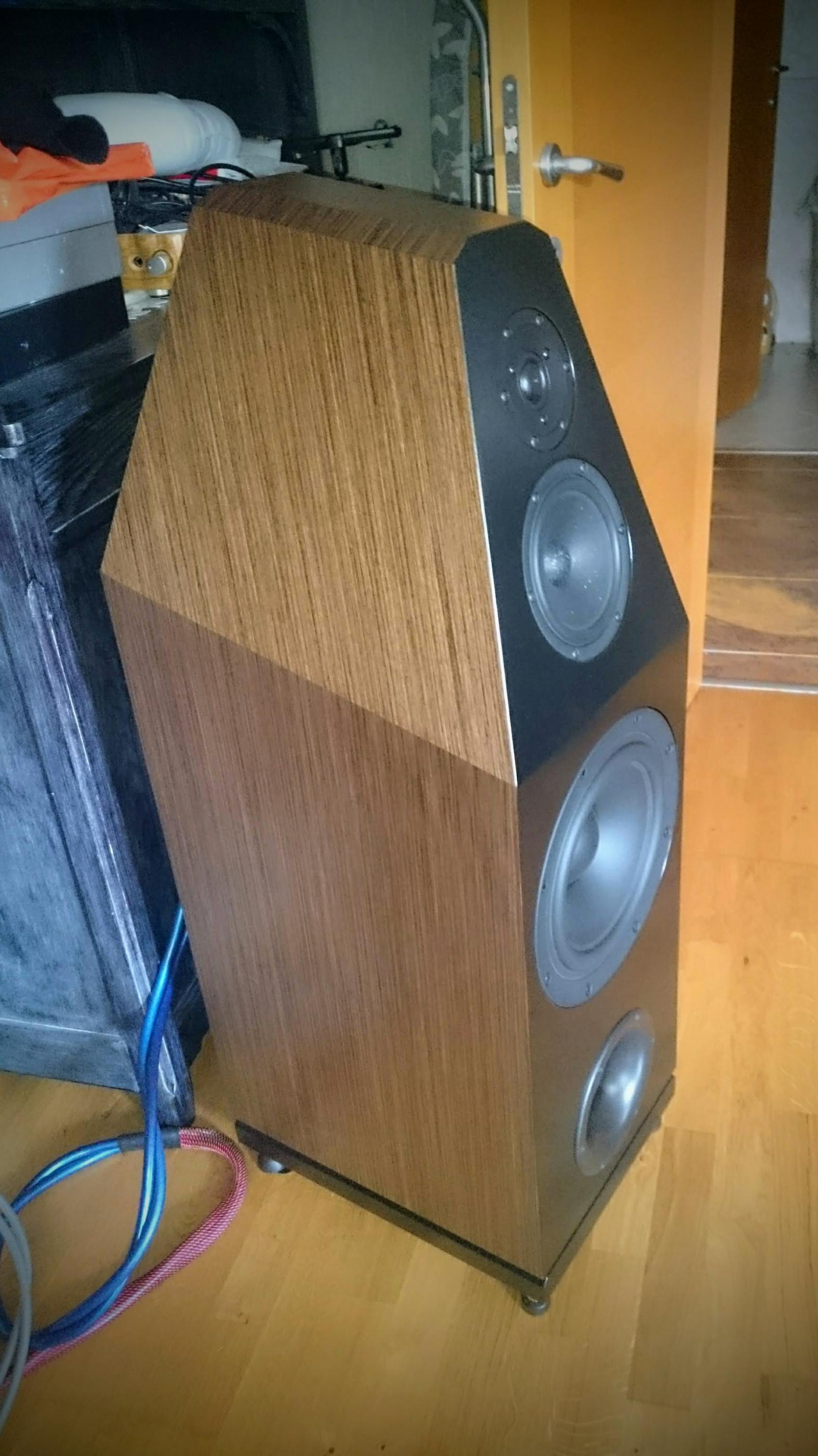

Here are some more pics of my speakers.
Brake in takes much more time than I have expected from those drivers. At the first impression I was disappointed, but after few hours of playing music, sound improved greatly. I did never expect such difference in non pro drivers... it was night and day difference.
Now I'm quite impressed with the sound but it is still improving.
The only downside of the design that I can still notice is a bit lacking of 150-300 HZ region. Of course it can be a lot of things so I'll wait a bit to see how things develop in time before I address it.
Overall I'm VERY happy with my new speakers 🙂

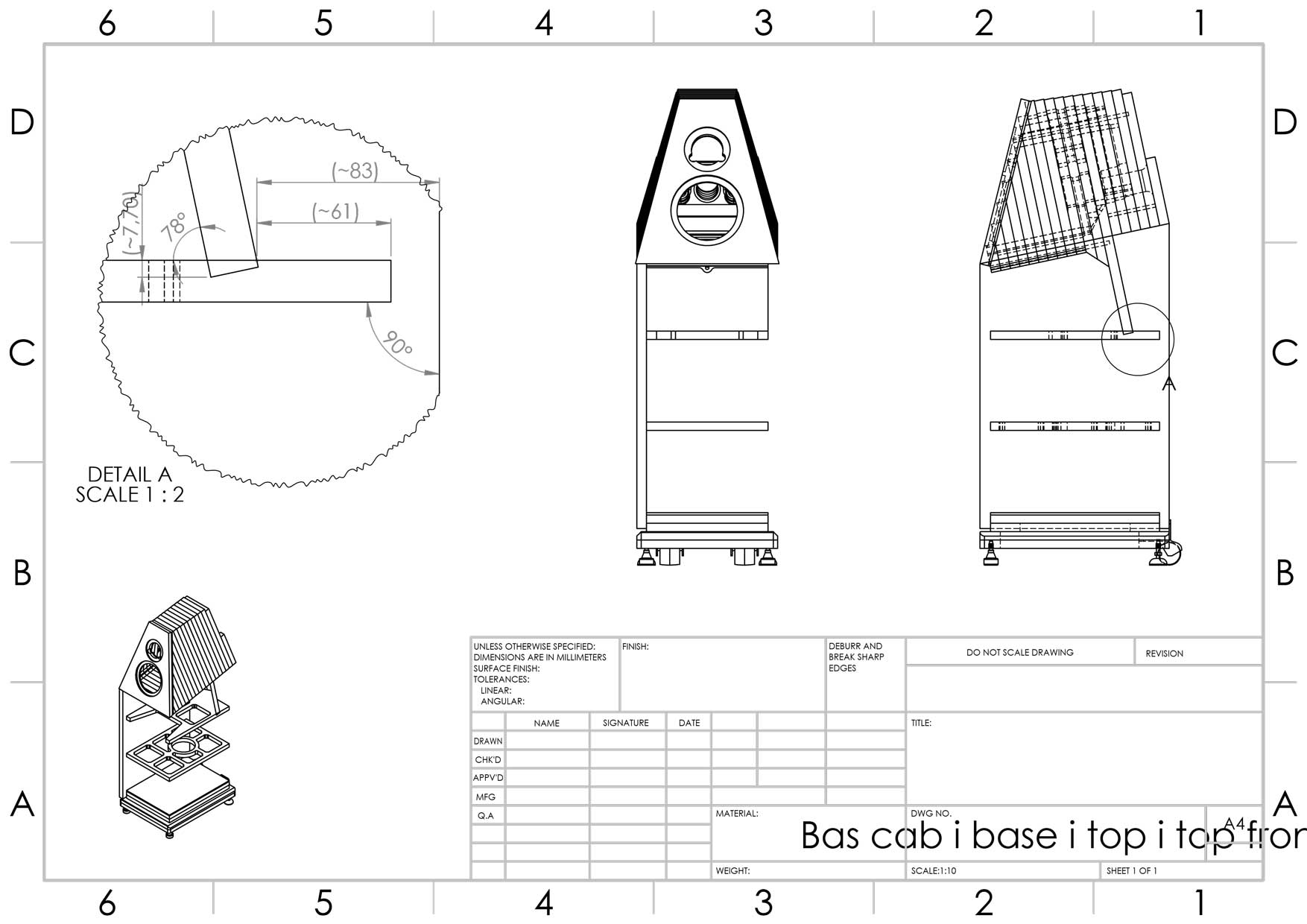

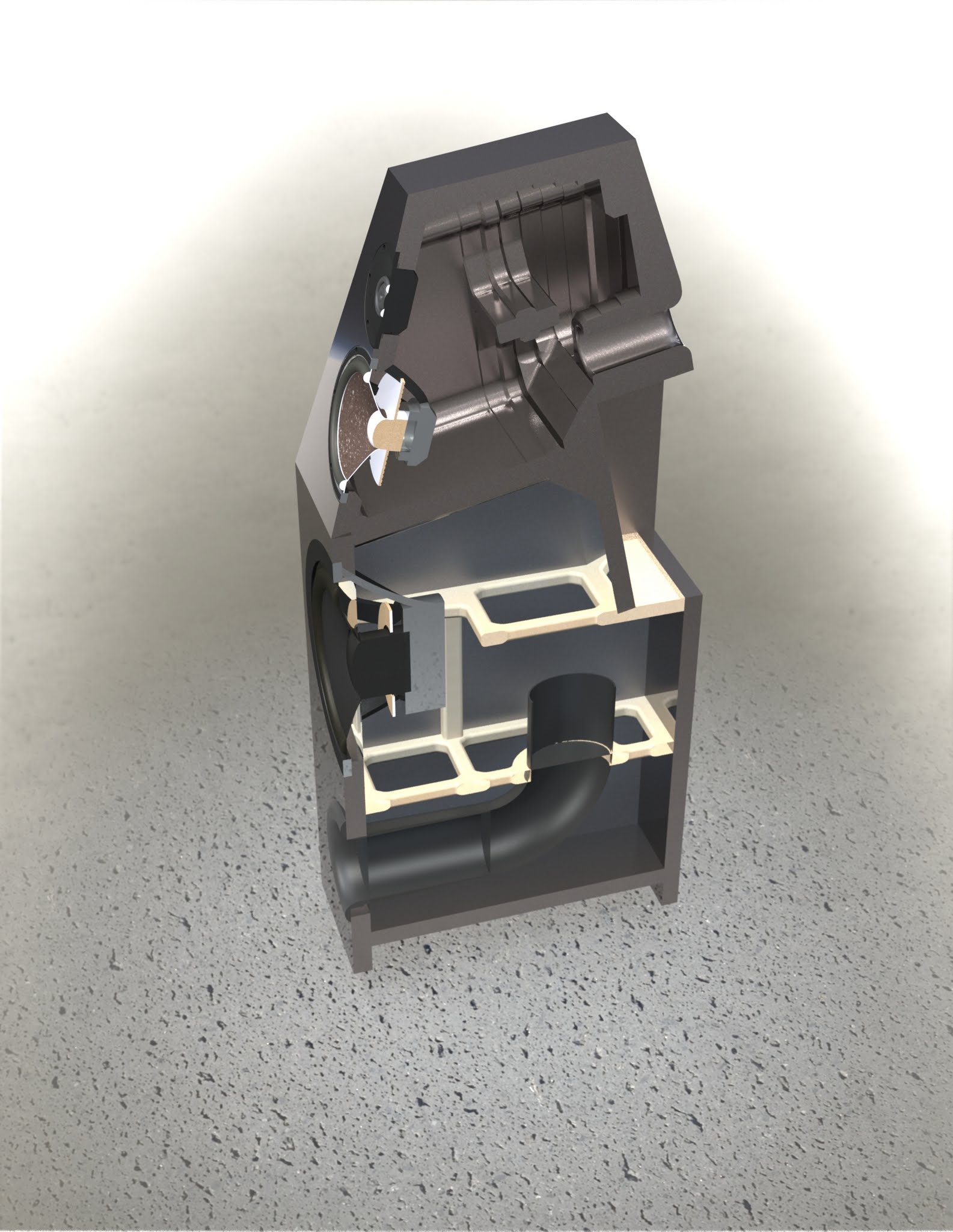

Can you tell us a little more about the cabinet? What changes have you made from Troel's cabinet more than the angle of the top?
Hi!

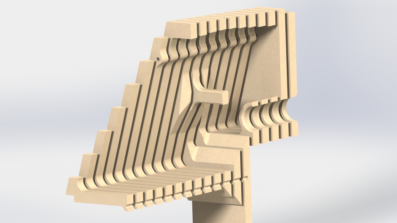

I have retained all what had to be the same. Front baffle, angle, internal volumes and driver positions. Everything else I have changed. Upper cabinet is done in CNC slices glued together and fitted to bass cabinet which is deeper but lower, and featuring also angled wall behind the bass driver. Lower and deeper cabinet helped also moving inner bass tunnel away from driver. Here are some pictures that explain that all in detail.
Hi!
Thanks for the info. Very inspiring!
