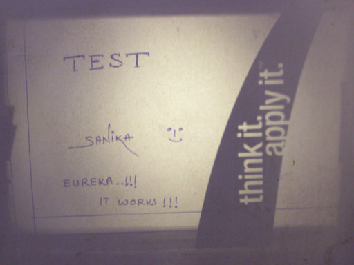

Maks0001 said:Please note that this pic was shot during the day. Though the windows were closed, the curtains were open and the daylight was coming through the glass panes.
