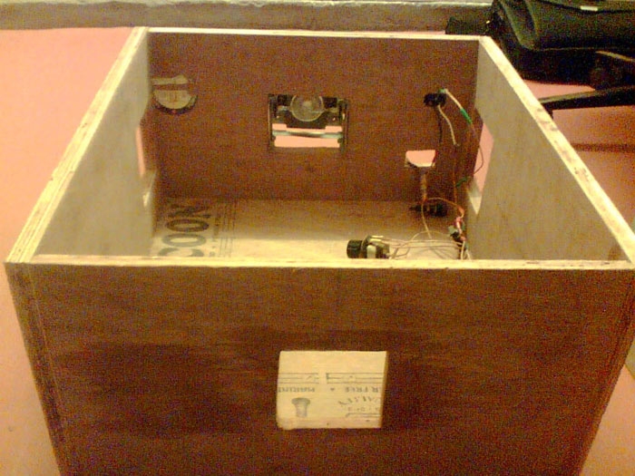

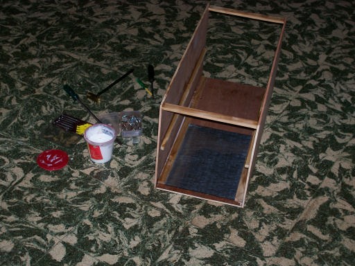

Hey Pollok... sorry for the delayed response... I did not get an email alert about there being a new post. Anyways... about managing to use the original FFC, please wait for a few days, once I finish the enclosure and fit the LCD in it, I will take some pictures and post on the forum. I should take another 3-4 days to complete the box. Here's the incomplete pic of the box.

actually i was stuck with the design, i got the box built from a carpenter for Rs.50

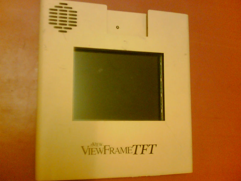

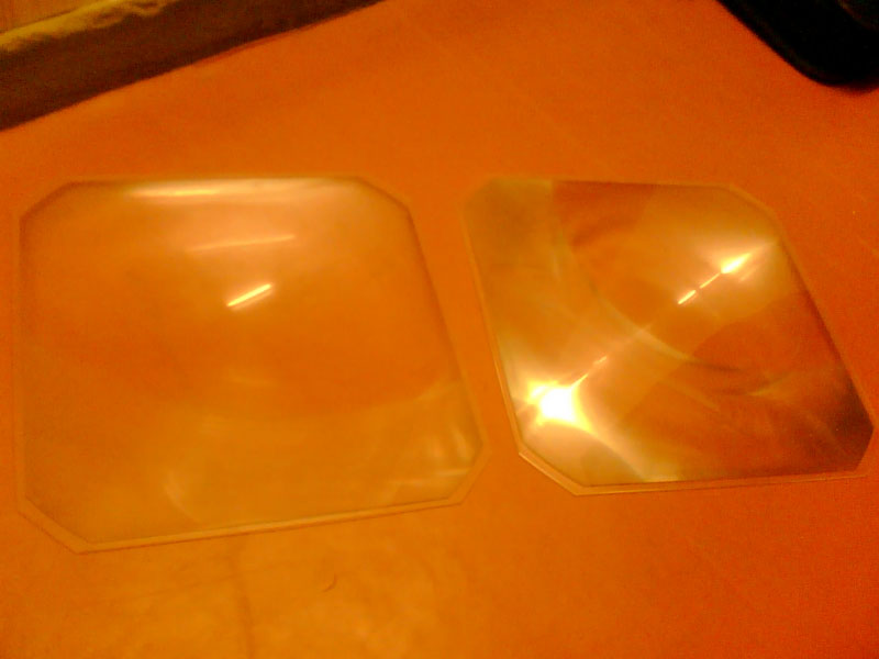

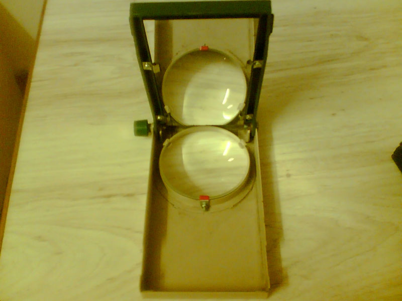

i had a old OHP so used its components , in the process of splitting the Fresnel i broke it, then got already split from Lensel Optics Pune, i have the singlet lens of the OHP , i am first gonna try with that only, i bought a Projection Panel (Viewframe TFT)from Ebay.com, it took 4 months and a bribe of Rs. 200 to a babu at Mumbai Customs to reach here in Nagpur, (the panel costed me Rs 4,500/-)

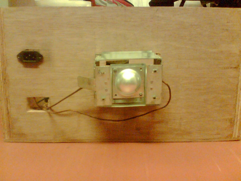

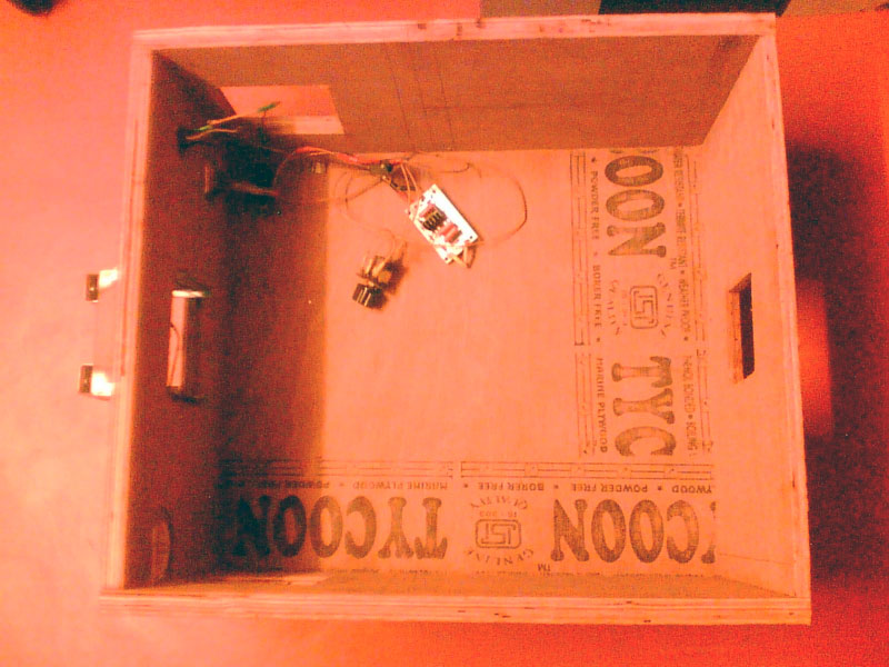

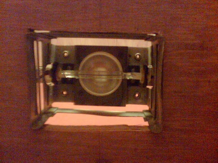

now i am gonna get a glass with VKool film, its a transparent film which block heat/UV and IR Rays used in automobiles , passes 94% light to be used in front of my HALOGEN lamp (yes a halogen), i am short of budget to go for a Metal Halide at this moment, my halogen assembly is out of the main box so most of the heating will be out of the box and gonna use 2 fans (push pull mechanism). but now i am in a fix as how to place these 3 i.e. 2 fresnels and panel in the box, i need some assembly idea , iam working on it, here are some pics of what i have done till now

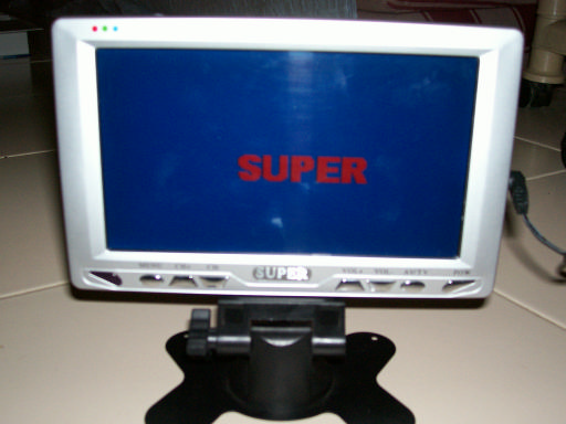

Hi Maks, Thanks for the reply. I'll wait for your photos. Meanwhile I bought a new car LCD and stripped it. Y'know what..? There is no need for a FFC!! The circuit board is connected to the LCD on only one side, so no need for an extension. The monitor's name is KV-MR9005 and the screen is 9 inches. I got it here in HYD for 5000. The only drawback is that it is 16:9 format, and the picture is pulled horizantally. There is no way to adjust it to 4:3 format. I'll start working on it next weekend.
Bingo... Cool..!!! so you had a good escape from extending the FFC, Pollok... 😀
Well, initially even I was planning to buy the car roof mount LCD panel... it was there for 4200/- at Mumbai, but later bought this one for 3750/-... has a built in tuner too.
One other thing, Pollok.... the picture will get pull horizontally in a 16:9 format LCD only if the original video is in 4:3 format. Now-a-days, all new movies are 16:9 format... so those will play without any trouble. Mine too is 16:9 format... I tried playing diff video formats and they all showed diff results.
