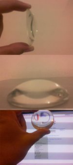

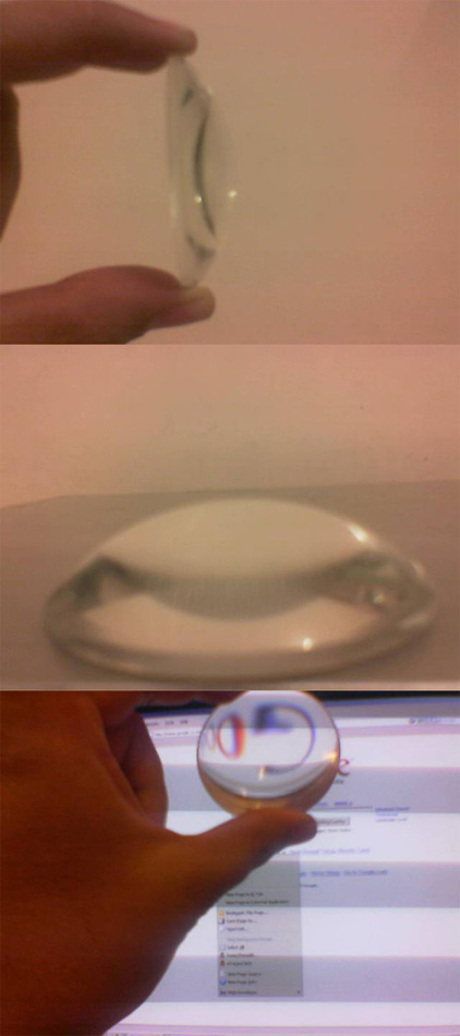

i got this lens from local scrap market
it was attached to a assembly which looked like a part of projector
is it a obj lens? i am attaching the pics
the dia is 5.5cm
can i use it as a triplet (or is it a triplet)
how to measure FL etc.
pls ignore my lack of knowledge

Looks like a singlet to me. You may be able to project images with that but the quality will depend on the lense. Some singlets are much better that badly aligned triplets. Get yout of your room and try to focus the sun to the floor . Try to get the smallest white dot possible and messure the distance from the lence to the spot. That will be the FL of the lens.
