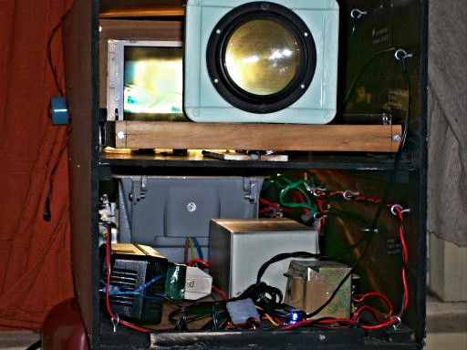

Hi ilango_slk... my PJ is almost done, except one obstacle that I need to overcome. I'm not sure, but I guess the UV rays from the lamp are causing some trouble. The LCD has a big foggy patch on it and starts waving when I put it ON. The colors in the patchy area are also faded and the image looks washed out. If I take off the mirror (i.e. no light on LCD) and put a torch behind the LCD, it's just fine. No patch neither any king of waves. But the moment I put the mirror back and bend the light to project through the LCD, it's the same story again. The heat is definitely not a problem as there's adequate cooling system in place and the LCD remains cool as such. Last weekend I went hunting for UV filter film - the one that is installed on car windows. But there was no vendor who would sell a small piece of it. I managed to get a cheaper one that was available as per the size requirement, but that does no good (and I had expected it). It's a three days holiday starting tomm... will try to fix the problem during this weekend. Any clues from fellow DIYers..???

Thanx a Tonne, Budhi.... I must appreciate your help and the systematic approach. So, let me too reply in the same order.
1. Being from the Electronics background, I have always known the importance of Grounding and sheilding. My projector is does have a three pin plug and is grounded well. Yes, I am using a wooden cabinet and the lamp is fitted inside the metal enclosure (please see the attached pic).
2. As you can make out from the attached snap, my PJ is a folded design. It has lower and upper partitions. I have mounted all the power supplies in the lower partition and all electronics in the upper partition. But yes, I can give it a try by getting a scanner PS as you have suggested.
3. I have used the best available connectors for signal inputs. They are gold plated and has cost me a good amount of money. The cables too are good quality shielded cable and I have taken enough care to cover the solder points.
But anyways, I think I will give it a second shot and emphasize on the points that you have recommended. Thank you once again... will bug you if I need any further help. 😉

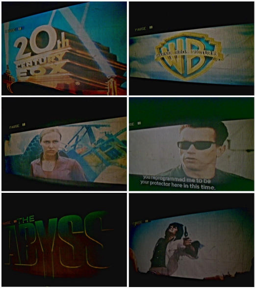

Good show Maks
The screen grabs look promising.I cant make out any disturbance in the screen grabs but somethings dont come out in stills.hope you manage to get rid of the lines. it has to be powersupply issue as you say its all fine when you use just a flashlight.
