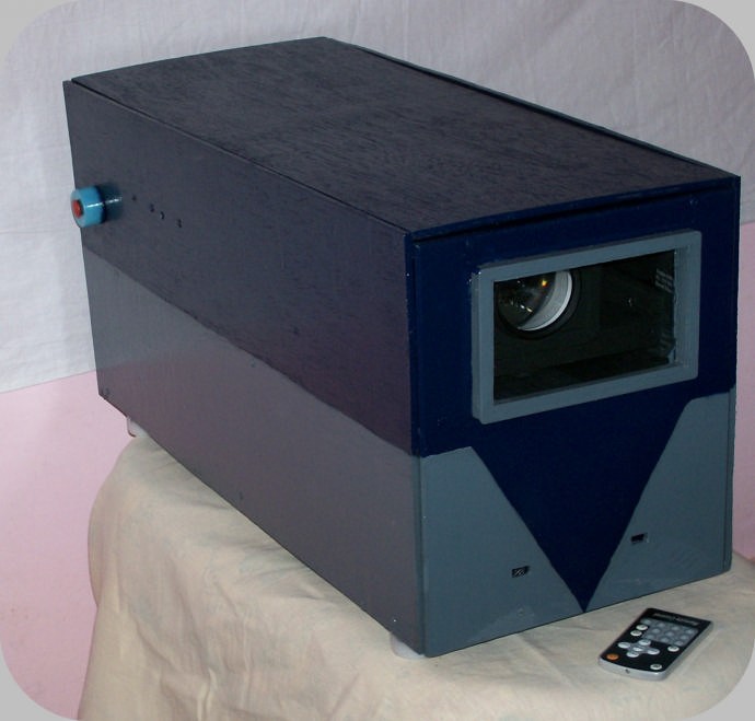

Frens... I am done with my Projector. I managed to fix the foggy patch and waves problem on this weekend. :up:
It took me just half a minute to fix it. Shielded cables, Connectors, Ground connections, LCD power supply... nothing was changed. Just a small addition and voila... it worked wonders. All that I added was a Anti-glare glass - the one that we use for computer monitors. If I slide through the glass at the light source, the patch and the waves go away instantly. The moment I remove it, the problem is there. It also keeps the heat from reaching the fresnels and the LCD. I dunno how I got this idea :idea: but it worked for sure... and we enjoyed watching movies on the BIG screen this weekend.

One suggestion - If you use a plain surface reflector instead of the textured one as seen in the photos, your results should be much better. Is the lamp 150 watts or 250?
- Pollok
Thanks for the suggest pollok... will give it a try. The lamp is currently 150 watts. Will upgrade it to 400 watts (and a plain surface reflector as you suggest) at a later time.
pollok said:
400 watts may be too hot Maks. Without proper heat resistant glass it may damage the lcd and fresnels. Should be very careful.
Yes, Pollok.... am aware of that. I will work out a adequate cooling and heat resistant system for that... the reason why I said in my post that I'll upgrade the lamp at a later time.
