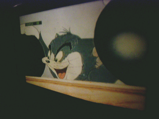

Guys... I am feeling empty now..!!! :bored: I mean, I had been working on this project day & night for over 2 & 1/2 months... and now since it is signed off I have got nothing to do.... except enjoying the movies on BIG screen.

There is a slight hiccup in my project. I did a rough trial yesterday, and found that the triplet lenses I bought in Chennai are not working with this pj. They were taken from old LCD pjs, and so I thought they will work here. But these lenses have to be kept very near the lcd to pick up the image, and since it is very close to the lcd, it is not covering the full lcd screen. Only a part of it gets projected.
I took the condenser lens and tried to project with it (inverted - the curved surface towards the lcd, and flat surface towards the wall. THe other way didn't work), and got a very big projected image of the entire screen, but with blurry edges. So I have moved into pause mode for now till I get the right triplet. I have written to Lensel, and am waiting for their reply.

Your lens seems to be a mismatch , you will need to add another lens to bring the size down or work with a new lens alltogether. "Tgreenwood" has some excellent optics solutions on this site search for them.basically you have to achieve approx 80-100 Inch projection andacross a common room of approx 10 to 12 ft in length a 300 mm lens is usually great for this.
You are right about the curved side to lcd part.
try putting thr lens in afocusing tube as this improves contrast and also play with an aperture disc(a black card with a hole about 2 inch dia in the middle) placed next to the lens improves sharpness but also eats some amount of light.
the following text is from tgreenwood it helped me a lot.
Decide on the final focal length of your projection lens, the focal length you need to get the size projection you want. As an example, lets say you need a 300mm EFL projection lens. To find out what focal length the two individual lens elements have to be, multiply the EFL by 1.71. So, your two lenses have to be 513mm fl lenses. (get reasonably close anyway). To find out how far apart to mount the two lenses in the mounting tube, divide the EFL by 2. So they need to be mounted 150mm apart. Now you have a 300mm EFL symmetrical duplet projection lens.
Using the same calculation, if you need a 6 inch EFL projection lens,
The two lenses inside need to be 10.26 inch focal length
They need to be mounted 3 inches apart.
The field of view on projection lenses made this way is about 30 degrees, so get the biggest diameter lenses you can. Positive meniscus lenses from Rolyn are from about 65mm diameter for the glass ones and about 75mm for the acrylic ones.
Hope this helps you out.

Well, before buying a new Triplets, I feel you should try using a defuser between the cond. lens and the objective. It will correct any light discrepancies that's a result of using a cond. lens, and will spread out the light evenly, thus might fix the blur edges problem. However, it will also eat some amount of light. Just give it a try.

Pollok, EFL or Effective Focal Length is what we term as the focal length of a Lens. It the focal lengths of the two or more lens and the spacing between those elements. You can get EFL calculators freely available on the net.
A defuser is not restricted to a certain material. It is used where the light needs to be spread evenly on a given surface. It is used widely from household lightings to movie sets. A softbox which is used in studios is also a kind of defuser (Budhi the Lensman, please correct me if I am wrong). Lexans used as roof tops also serve as defusers. If you have already stripped your LCD, you can find a thin plastic sheet on the backlight. This is also a defuser. It's not completely transperent but a slightly smoky, yet it passes 94% of light (depending upon the quality).
Thanks, Maks. now I understand. Tell me one thing - Will a OHP projection lens work with this pj? Is it a triplet? Coz it looks like a single, but thick lens. My lcd is a 9 inch one, and I think the diameter of a OHP lens will be the right one for this. Please let me know.
