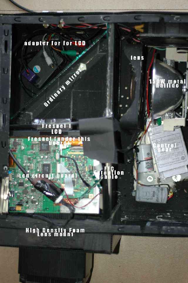

Could you please put a picture of the projector from the inside after u have fully made....
say a step by step making of it... It would clear a lot of doubts when we c it visualy....

Attached pictures of inside but as everything has been painted black therefore its alittle difficult to make out.

Dont get stuck with the single fresnelor no fresnel problemFresnel is required to intensify or collect the lightand send it to the Lcd then stop it from scattering once again and send it to the projection lens,it actually increases the intensity a lot you will have to buy a double power bulb if you dont use a fresnel which means double heat weight powerconsumtion and other problems.
The final image depends on the quality of the main fresnel this is the one in front of the lcd (between lcd and lens) Use your good fresnel for this.use an ordinary fresnel available in stationary shops in A3 size for about Rs 100/-!!!! as the lens required to condense light, these are called Page magnifiers or map magnifiers only problem is they are not very think so you will need to make a simple plastic or wooden frame to support it tight.
And Remember the most important thing-All fresnel grooves have to point away from the lcd (plain side towards the LCD) otherwise you are doing more harm than good ie scattering the light, instead of collecting it.
