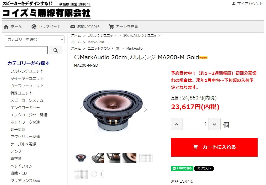

Pre-orders are now available in Japan.
The price is 47,234 Japanese Yen (628 USD) for the pair.
I ordered as soon as possible, but they will be in stock in about 10 days.
