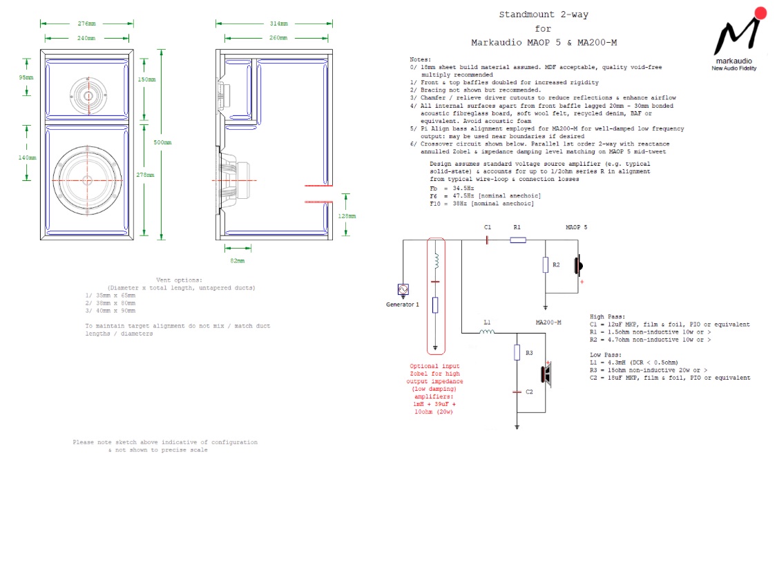

Perhaps the MAOP5 in this one also 😉🙏The box would need to be redesigned to account for the additional sub-chamber for the mid-tweeter, and the crossover would need changing since the drivers and baffle diffraction / bass responses have also changed. Basically, it's a complete new design. Not impossible of course, but unfortunately I haven't got one like that in the works at the moment since I don't have a pair of CHN-50P here.

Can the port be front located instead?
You can, but not recommended, unless the enclosure is within 4in of a solid front wall or loaded into a corner.

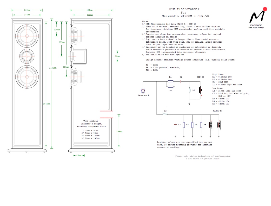

Also, this arrangement presents a nominal 4 ohm load given the two MA200 in parallel. Perhaps an 8 ohm version with just one MA200 like in this one, makes it easier to drive… performance compromise?🙂
Depends how you mean 'easier to drive'. Parallel wiring = +6dB sensitivity gain for a given voltage, with double the current draw of a single unit. Most solid-state and decent PP valve amps won't give two hoots, since by design it's not a very reactive load, and that's typically as important as the nominal impedance itself. Low power SET types may be less happy, although that too is often as much about the quality of their PSUs & output transformers as it is about their power output itself.
Also, the cross-over frequencies? I like the idea of externally connected filters, less interference and gives the option of active filters later on🙂

Designed for passive; you can't fully recreate it with active as it's also serving as some impedance control / damping.Also, the cross-over frequencies? I like the idea of externally connected filters, less interference and gives the option of active filters later on🙂
A little old-fashioned -it's a configuration JBL used to use in the late '60s & '70s which I also quite like.

It seems like a first order crossover, yet the drived are wired with opposite polarities?
For the one with two MA200s there was a second-order crossover, with the drivers in opposite polarities, and that's ok.
The MTM is a 2nd order design -to be precise, it's an offset 2nd order Butterworth with some minor level adjustment & resistive damping, per some classic Altec & JBL designs. Not necessarily the current fashion, but suits what I was aiming to achieve with this design. The single MA200 box is a 1st order electrical with some impedance correction & level padding for both units, but the acoustical slopes are mildly asymmetric. Remember, there's no single electrical polarity that's automatically 'correct' in practice for a given [electrical] filter order -we're manipulating both electrical & acoustical slopes, so what it actually ends up being depends on the on-baffle driver responses & your target alignment.
