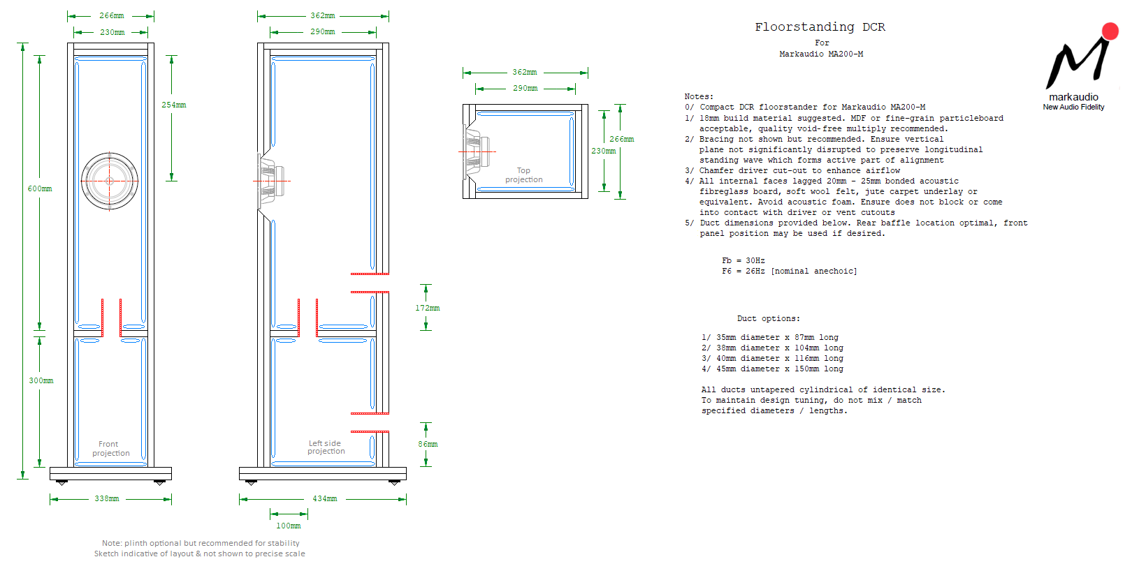

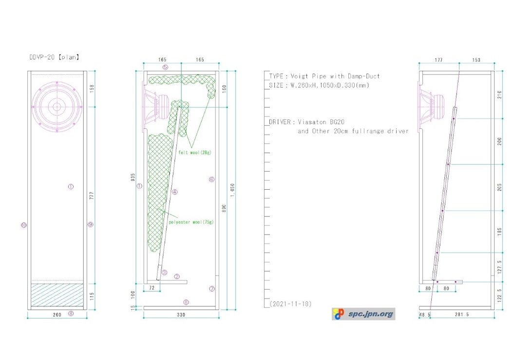

Will the MA200-8 driver work in a Joan FHXL box, also the DDVP-20 plan says for 200mm full range driver. 🤔
As indicated above: yes, it does go in the Joan enclosure -just. I can't comment about anybody else's designs though.
It's to optimise the location on the longitudinal without requiring extra damping and to position the driver at roughly 30in from the floor; it's intended mostly for smaller spaces.Thanks, just had a look at them. This DCR plan looks interesting, is there a reason why the driver is placed so low in the cabinet.
How would a MA200-8 driver in a Joan FHXL compare to Alpair 11MS in a FHXL.As indicated above: yes, it does go in the Joan enclosure -just. I can't comment about anybody else's designs though.
Thanks for the clarification, looking to make a new floorstander after the Fugel-Horn mk3, which was great by the way but with a bit more body to the sound.It's to optimise the location on the longitudinal without requiring extra damping and to position the driver at roughly 30in from the floor; it's intended mostly for smaller spaces.
Not great at speaker design, so just trying to get a feel for the sound balance of a certain box/driver combination. Thanks.
