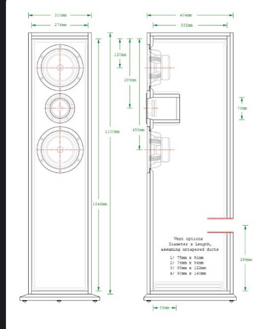

It seems like a first order crossover, yet the drived are wired with opposite polarities?
For the one with two MA200s there was a second-order crossover, with the drivers in opposite polarities, and that's ok.
The MTM is a 2nd order design -to be precise, it's an offset 2nd order Butterworth with some minor level adjustment & resistive damping, per some classic Altec & JBL designs. Not necessarily the current fashion, but suits what I was aiming to achieve with this design. The single MA200 box is a 1st order electrical with some impedance correction & level padding for both units, but the acoustical slopes are mildly asymmetric. Remember, there's no single electrical polarity that's automatically 'correct' in practice for a given [electrical] filter order -we're manipulating both electrical & acoustical slopes, so what it actually ends up being depends on the on-baffle driver responses & your target alignment.

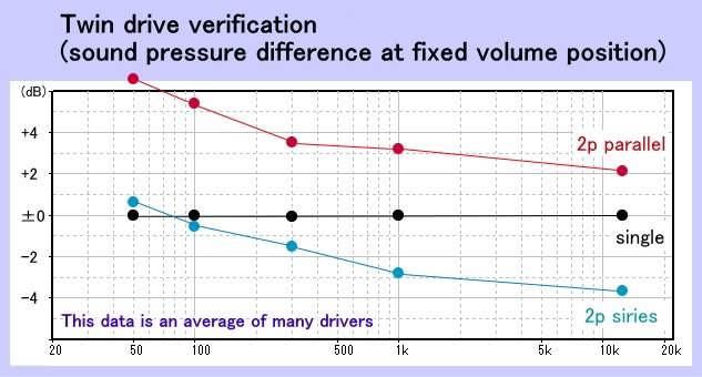

Depends what you call 'sufficient'. Parallel wiring a pair of identical drivers gives +6dB relative to a single example of the driver for a given voltage input: +3dB from the doubled cone area, and +3dB from the doubled current draw, since impedance has been halved. Series wiring = no change in sensitivity relative to a single unit: you get +3dB from the doubled cone area but this is cancelled out by -3dB from the doubled impedance (halved current draw).and possibly the MTM enclosure with dual MA200s will increase the SPL sufficiently?
As an aside, this is why driver SPLs should be measured under 2.83v conditions rather than 1w, since the actual SPL sensitivity results are comparable across different coil impedances.

RE: MTM, With the drivers close together, this will be like point source performance, very interesting 🤔
It would -but would also require a complete redesign, with much larger components to lower the nominal crossover frequency, additional LF impedance compensation to kill the upper box impedance peak for the filter to actually work, and then extra EQ components to recreate the target response around the original filter frequency. A pure point source operation wasn't the object with this design; it's designed & voiced to incorporating the standard MTM target of decent horizontal dispersion with more in the way of vertical directionality / contrained polars.
800Hz -one of the favoured traditional Altec filter frequencies & works nicely with this configuration. However, remember the slopes are slightly asymmetric, and significantly offset, and to actually get the target response you need the padding & damping in place as they're serving as mild EQ (amongst other things).

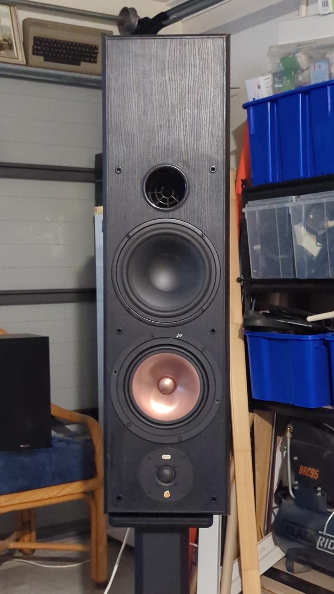

Finally got a pair of MA200's, Retro fit them into an old floor-stander 8" box while i build the correct boxes for them. So far they sound amazing, I'm sure they will need a while to "break in" but very impressive so far
- Full Range
- New Markaudio MA200 8" Driver
