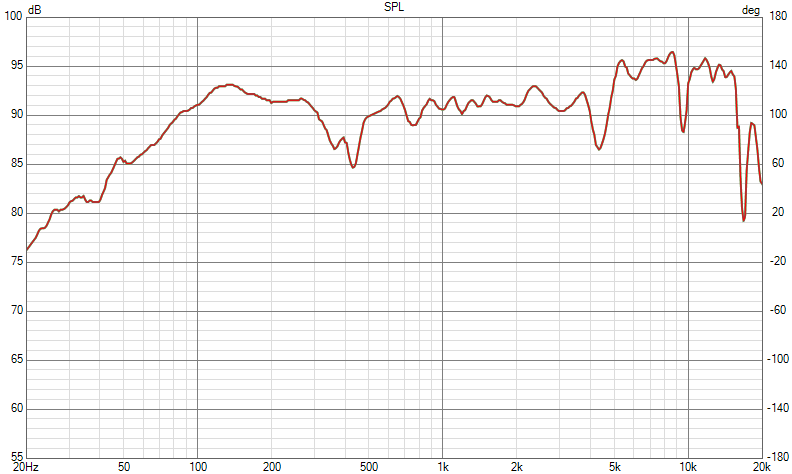

Not bad for a 45dB vertical window & mildly compressed 1K - 20K.

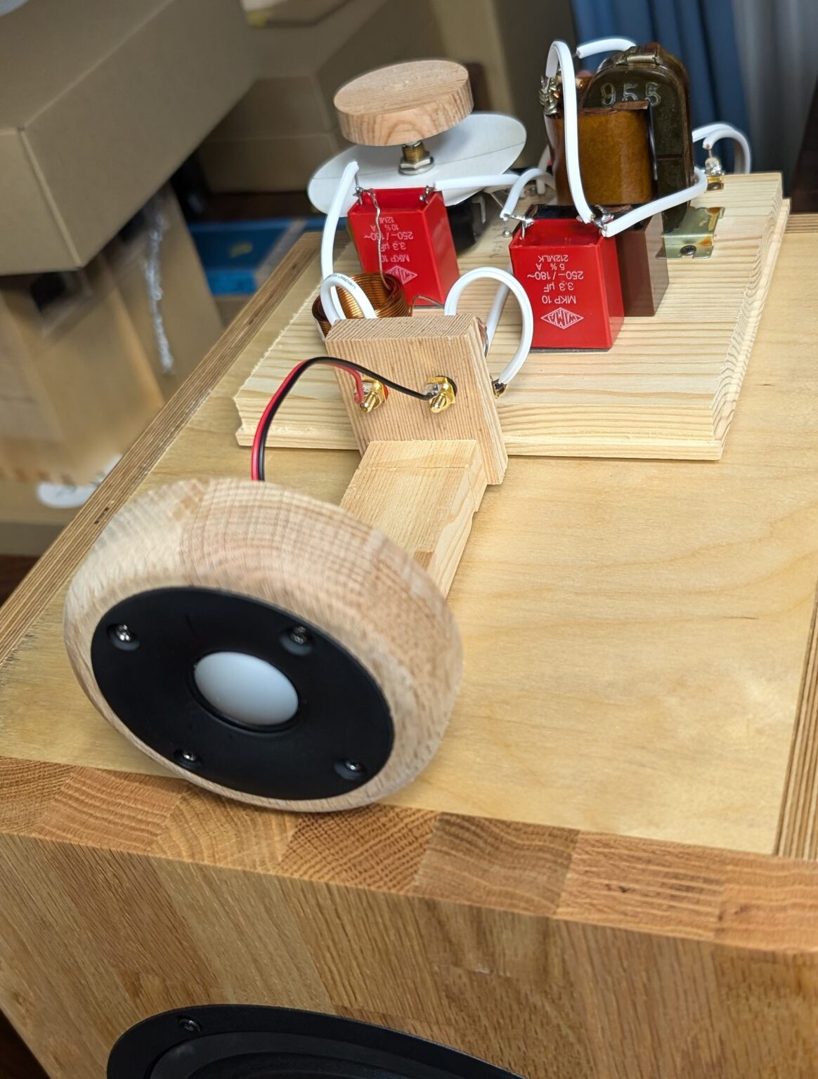

Slid back for better phase ?
I wonder if non 6db time/phase crossovers "sound" better if their acoustic centers are lined up....................
Typically you have to account for any shift in position on the Z-axis (relative to the reference plane) whatever filter order you're using. In some senses higher order filters are less sensitive to variation -in others they're arguably more so, since the higher the order, the more precise you typically need to be. That's why most of the time with passive filters we have some asymmetry in the slopes in order to line the phase up, or some kind of mechanical offset. You can also (although many don't want to go there) use a delay network. Digital active gives the opportunity of lining phase up with symmetrical circuits that way if its felt important.
Troels has spent the last few years promoting LR2, or at least 2nd order slopes, with physical offsets to the HF (& if relevant midrange) drivers, although he's backed off on some of the measurements, and, presumably, consistency of phase alignment since he first started down that road about a decade ago. He also did one, now discontinued, design with physcially offset HF driver, with the option of symmetric LR2 or symmetric LR4 slopes. I've never been convinced by the phase argument myself (within reason) -there's a boat-load of evidence from properly conducted trials by Toole & others that within very broad limits its inaudible with loudspeakers in ordinary rooms on ordinary music. The differences in the power-response, distortion behaviour etc. OTOH, are another matter.
