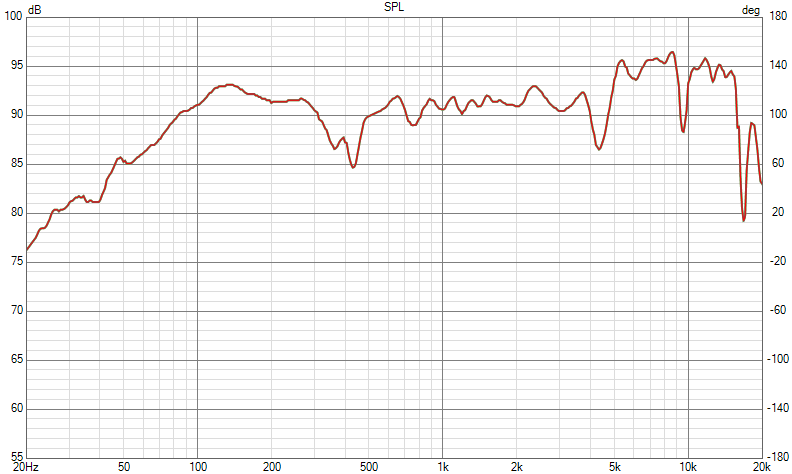

did anyone find out any tweak for full metal cones to tame the last remaining resonances?
If its only above 10khz I know that these are not quite audible any more as long not peaking in a single high peak but only decaying longer time.

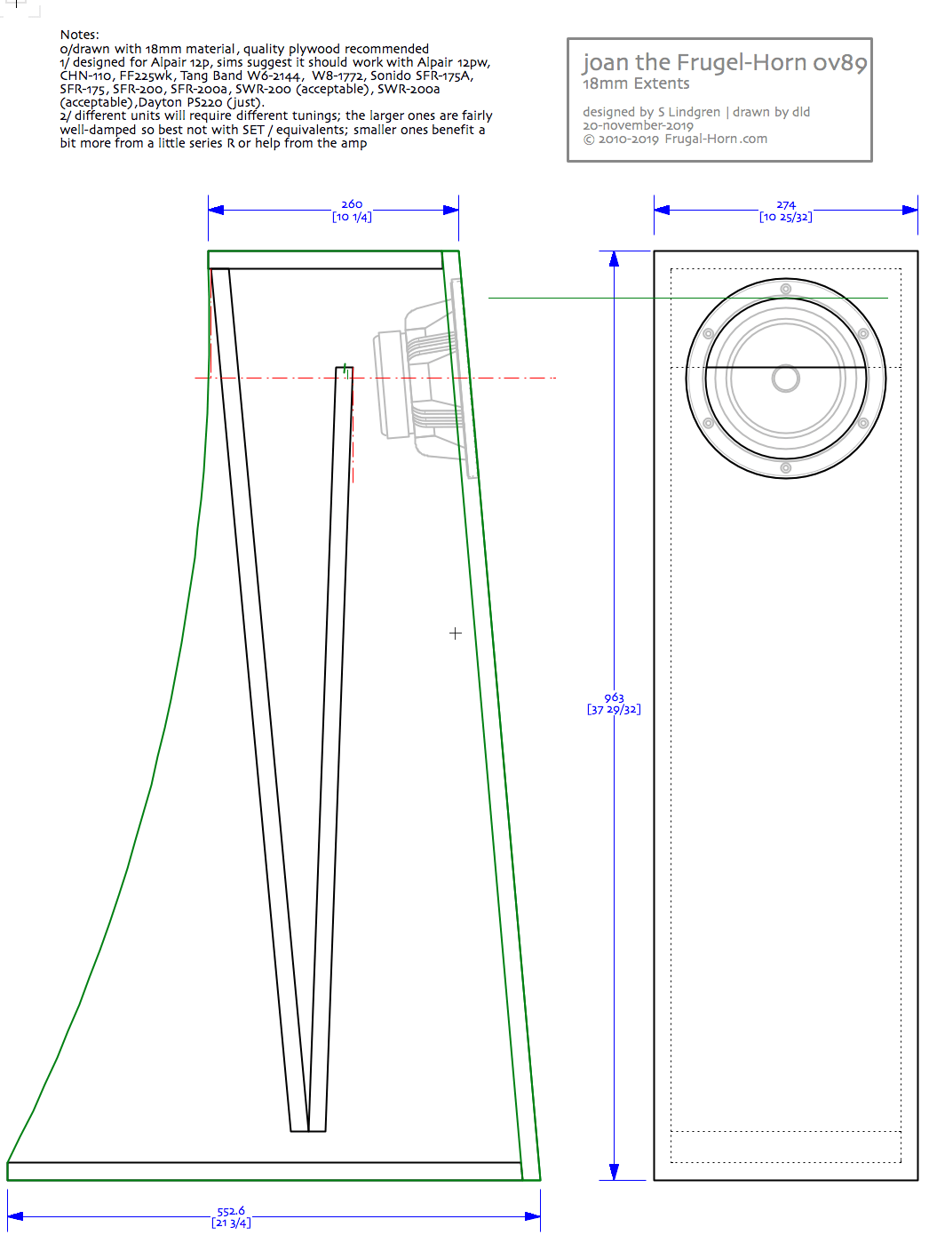

For floor-standers for the Alpair 12P, you can consider 3 enclosures:
- Joan Horn (Frugel Horn design for the Alpair 12P)
- Avebury (Scott Lindgren's double mouth horn)
- Super Pensil 12 (easiest to build among the 3 cabinets)
Thanks! Was planning Joan with 12P until this new MA200 came along. Now I’m not certain. Hoping the experts can chime in with which of these two drivers might be a better match for a low powered SET—specifically a 45 type. I currently own FHXLs with MAOP 10 drivers. My 45 monos sound glorious with these speakers but occasionally they run out of steam.For floor-standers for the Alpair 12P, you can consider 3 enclosures:

What type of musical genres do you mainly listen to? What is your listening distance and listening volume levels?
The MA 200MT sensitivity is slightly higher than the MAOP 10, but unlikely that will alleviate your situation with "running out of steam" with the 45 tube SET. The Alpair 12P again has a little higher sensitivity vs the MA 200MT...

Respectfully disagree re: above 10khz resonance plateau, Alpair 10.3 in particular 7-14khz. Even though I could only hear up to 12khz or so sine wave, I had to keep raising notch filter frequency (by ear) until 10khz the geometric center of the entire plateau (according to company's published response chart, which I examined after finalizing the notch).did anyone find out any tweak for full metal cones to tame the last remaining resonances?
Dave's gloss coat tweak worked miracles on another AlMg driver, I reported in that thread.

specifically, hoping for a comparison of the 200M vs 12P (Likely in a Joan) for low powered SET use.
I think I’m gonna go with a 12p in a Joan (unless anybody advises otherwise) Thanks all!
Is there any complete informations available somewhere about this model of enclosure now ? I mean : more developed than the principle drawing below ?
