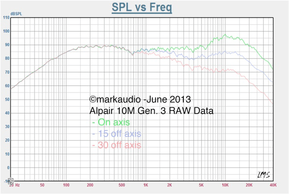

You could have asked me you know. 😉 The driver is actually no different to any of the other MA units in its broad LF response characteristics; no LP shelving circuit needed for these. If it was, I would have provided it. Slapping shelving circuits on these things without reference to the power response causes an LF heavy balance (and not in a good way). Been there, done that; I've been working with the prototype driver here for a couple of months.
Can you clarify what you're asking, or saying? Sorry, it's 0310 here. The two drivers are measured under slightly different conditions, with the new unit also having a slightly different data presentation from Clio rather than the long-gone LMS, but as you can see, they share the same general axial characteristic, with the larger unit's power response being slightly narrower, as you'd expect.

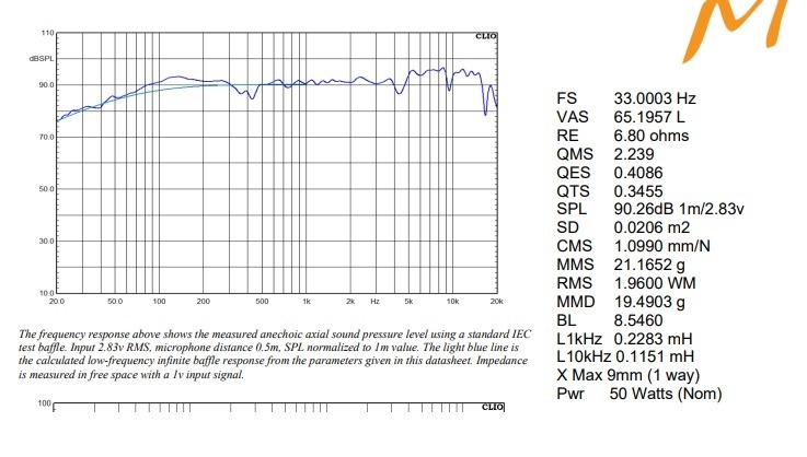

In the 10.3 in the graph above, I see +3 to+5db @ 200-500hz compared to 800hz, then the response sneaks up then takes off past 6khz.

I don't see any driver bass bump in the frequency response.
If you look at the MA200 FR graph, there is a significant bump in the LF. Look at how the measured response compares to the calculated response - there's proababy about 6dB difference around 120 Hz. Mind you, I'm not sure of the full measurement conditions. (Also, it's tricky to read the graph because the vertical scale is quite compressed, nowhere near the IEC recommended 25dB per decade aspect ratio.)

Sorry for the slow response -still fighting the dreaded lurgy so been out of it since about 0330. Oh well, lots a whole lot (and then some) worse off, so can't complain.In the 10.3 in the graph above, I see +3 to+5db @ 200-500hz compared to 800hz, then the response sneaks up then takes off past 6khz.
Right, that's more or less the 'standard' MA axial response characteristic; to varying degrees most of the drivers have it, or a variation thereof, including MA200-M.
You can -pretty much every enclosure I've done for the MA units does, to different extents depending on what it's designed for / how it's intended to be used. The pensils & various horns are the 'obvious' examples, but I build it into all of themI think you could use this as an advantage.

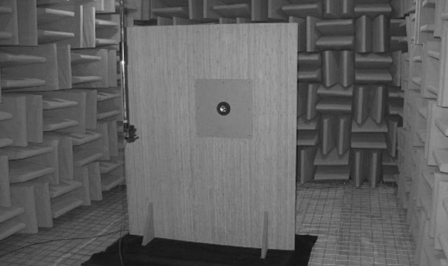

MA drivers are measured on an IEC 268-5 equivalent baffle with the driver offset on a hybrid of golden and industrial acoustic ratios. Starting with MA200-M, 'we' (I say 'we' because the change was my doing, so in this case shooting the messenger is entirely fair 😉 ) have made a few tweaks to the protocol to better represent real world use: we've added in the mathematical IB curve derived from the published T/S data set, and the mic. position is shifted to 0.5m, with the levels normalised to the 1m/2.83v value to allow comparison across different coil impedances. That last was also something I've been requesting for some time. The closer mic. position reduces a little of the unwanted baffle artifacts -there are various ways & means around this, but this one was the most practical for the available facilities & staff time. FWIW, this is more or less the old measurement protocol Seas used to do up to about '03, when they shifted to small test boxes, albeit with that nearer mic. location & levels normalised. Further out, the LF response inherent to the driver can get a little exaggerated by the baffle load unless you tweak things a bit, so reducing this is useful.Or the response above is not measured on an infinite baffle ? like a wall ?

That's good to know. Measurements are anechoic/quasi-anechoic? Valid how far down?MA drivers are measured on an IEC 268-5 equivalent baffle with the driver offset on a hybrid of golden and industrial acoustic ratios. Starting with MA200-M, 'we' (I say 'we' because the change was my doing, so in this case shooting the messenger is entirely fair 😉 ) have made a few tweaks to the protocol to better represent real world use: we've added in the mathematical IB curve derived from the published T/S data set, and the mic. position is shifted to 0.5m, with the levels normalised to the 1m/2.83v value to allow comparison across different coil impedances. That last was also something I've been requesting for some time. The closer mic. position reduces a little of the unwanted baffle artifacts -there are various ways & means around this, but this one was the most practical for the available facilities & staff time. FWIW, this is more or less the old measurement protocol Seas used to do up to about '03, when they shifted to small test boxes, albeit with that nearer mic. location & levels normalised. Further out, the LF response inherent to the driver can get a little exaggerated by the baffle load unless you tweak things a bit, so reducing this is useful.
Anechoic -just to confirm, they always have been. Apologies, I should have mentioned it, I'd just assumed it was known. FWIW, you can see part of the chamber & baffle in a photograph in the 5.3 datasheet.

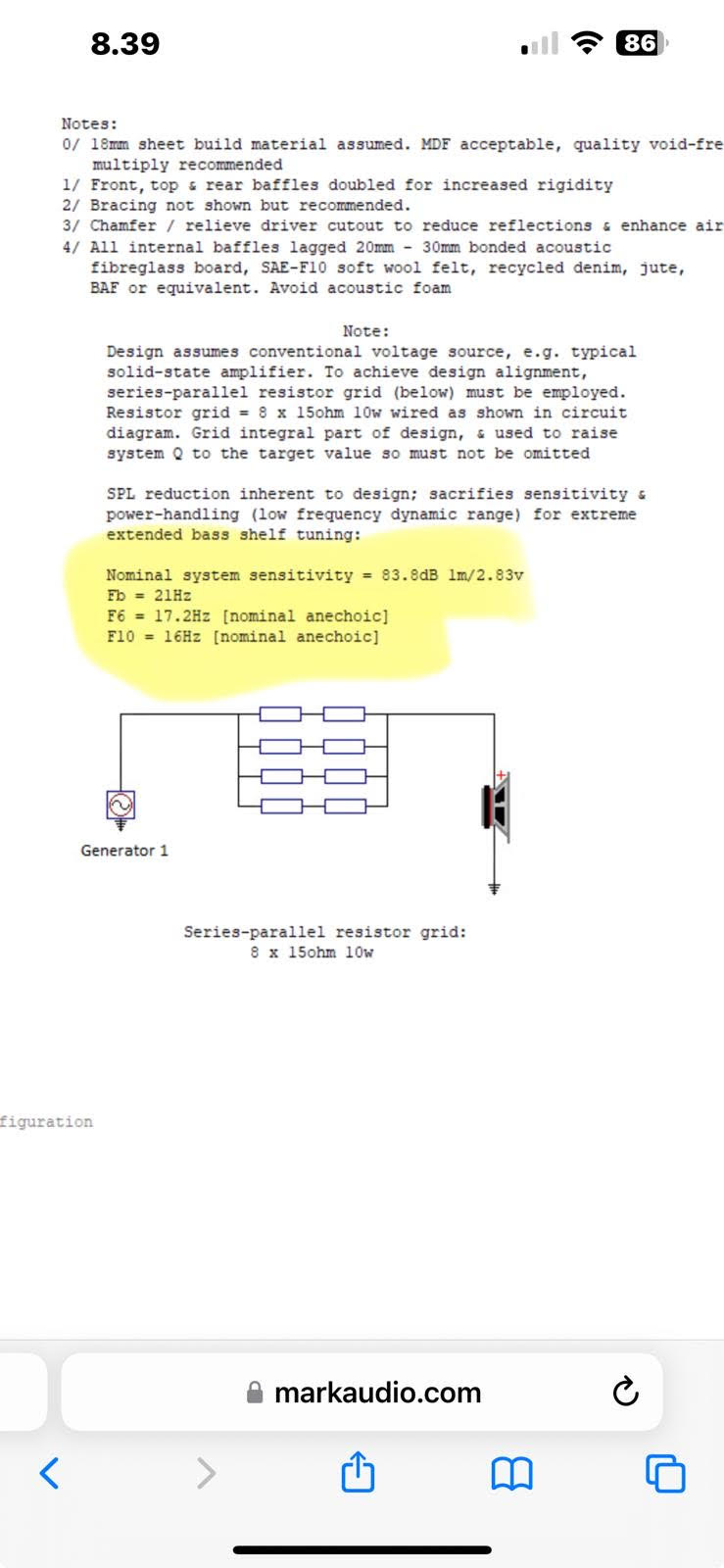

Take a look of this enclosure design for MA200-M:
https://www.markaudio.com/wp-content/uploads/2024/07/MA200-M-Keele-aligned-EBS-vented-box.png

Scott: Is this EBS alignment designed to be used near or in room corners?

so, you put a 7.5ohm resistor in front of it to push the qts high.........................
I have dabbled in subs, some ebs designs (extended bass shelf) would tune to the speaker / box F9.
