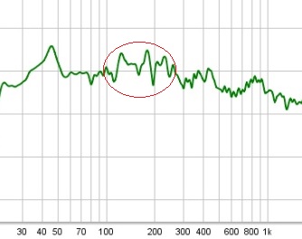

This is the frequency range where airborne resonances appear in an enclosure sized like yours, 440 litres. One would put the right amount of fibers until these disappear from the plots, especially impedance plots where they can be spotted easily.

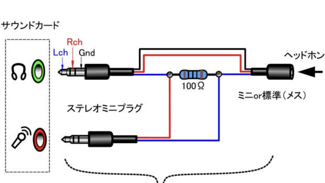

Would this setup work for the impedance?
Seems correct ( don't know how you're going to get signal onto the driver's terminals with that setup ? ), but what you really need to do is check all that against the REW Help File.
If you run into questions or need help with REW, ask those questions at the Official REW Help Forum .
I cross referenced that setup with the one in the rew manual, and seems the same. Will just connect speaker binding posts on the one side instead of that jack, and plug my speaker cables straight in.

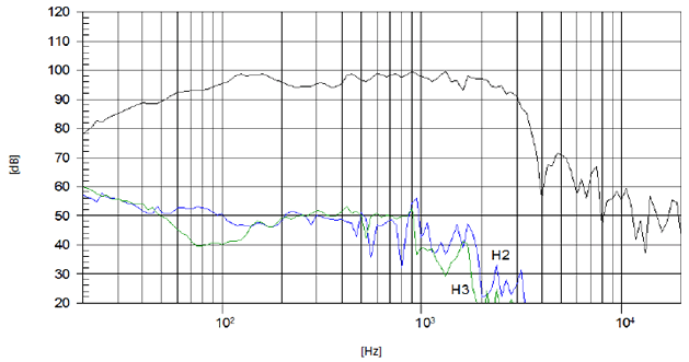

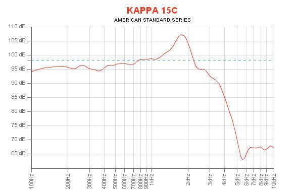

This is important to consider if you are using a cheap / bad woofer, less important in this case. The Beyma woofers are reported to be good, and measure well, with FR plots suggesting they suit a simple crossover. Money well spent.
I've attached a Beyma FR plot (extended and smooth) versus a driver with a pronounced breakup (big spike) to illustrate the difference.

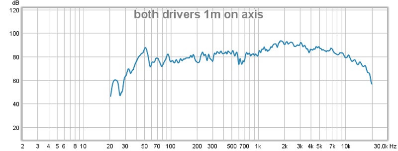

Thanks for all that. I have rigged up for measurements and will do as soon as wife leaves for work. A will do a couple, as suggested. I will do a few of the jbl only, and then 3 with the whole system is. Both drivers, with adjustment on attenuation. Will post in the next few hours. Will also post the measurement file will all the measurements on it. Hope that’s ok

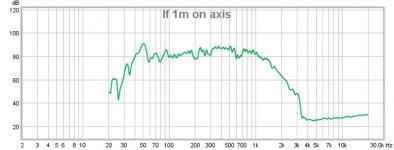

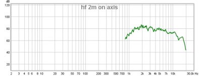

Hi Brendan, I'd like posted following:
- impedance of tweeter (in enclosure)
- impedance of woofers wired in parallel (in enclosure)
- FR of tweeter, mic in the centre of the tweeter, 2 m away
- FR of both woofers wired in parallel, mic in the centre of the tweeter, 2 m away
- FR of upper woofer, mic in the centre of the tweeter, 2 m away
- FR of upper woofer and tweeter wired in parallel, mic in the centre of the tweeter, 2 m away
- FR of lower woofer, mic in the centre of the tweeter, 2 m away
- voltage setting the same for all measurements, perhaps 1Vrms
- exact locations of drivers in a baffle, distance from enclosure edges, horizontally and vertically
- gating (time window) for woofer measurement 20 ms, 5ms for the tweeter
- phase setting for FR measurements = minimum phase

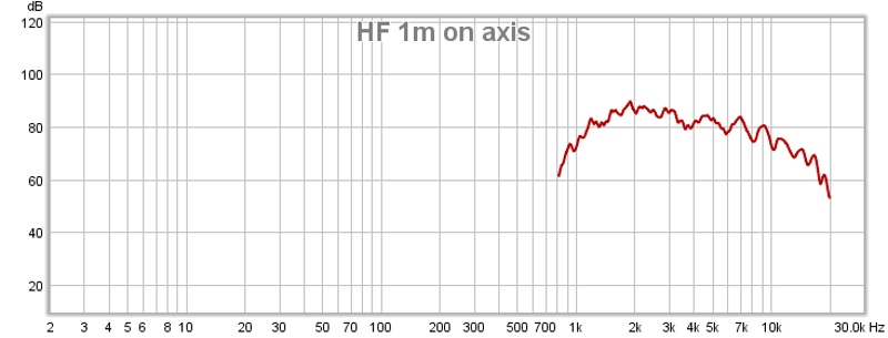

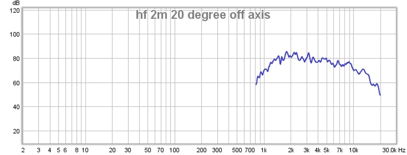

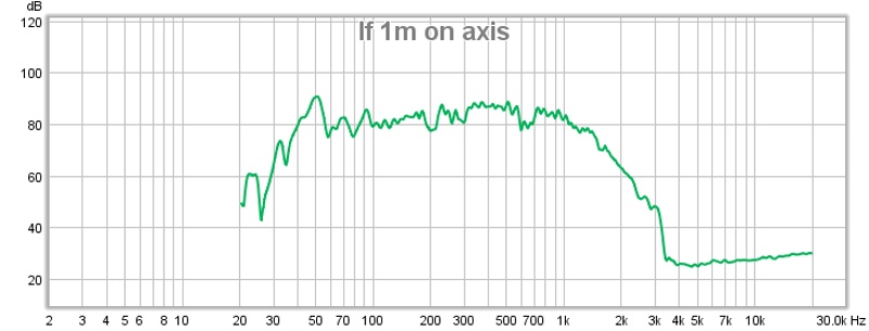

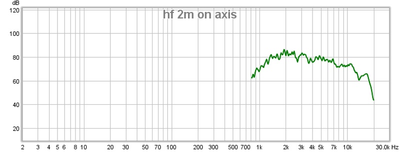

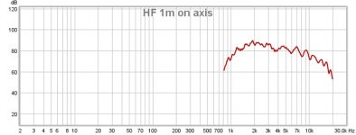

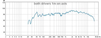

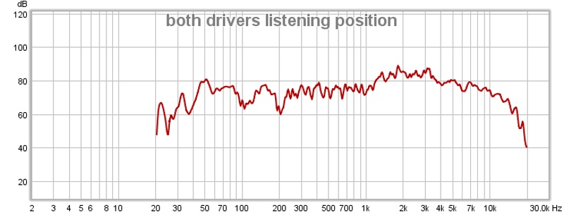

I have taken the following measurements and labelled them, as well as saved the file. They are namely:
*FR of HF 1m away on axis
*FR of HF 2m away on axis
*FR of HF 2m away 20 degree off axis
*FR of HF at listening position
*FR of Woofer 1m on axis
*FR all drivers at listening position.
This was done with the specs that I posted yesterday ie. new crossover points. Unfortunately, I could not match the levels exactly, but you will see in the graph. I am running separate amplifiers for HF and LF.

The measurement of all drivers, is with the LF wired in parralel, and the HF, measurement taken from centre of the HF. Hope this helps. Thanks for your trouble Lojzek
