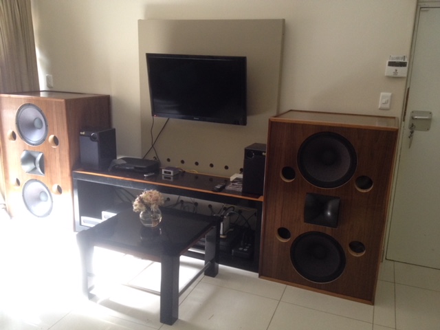

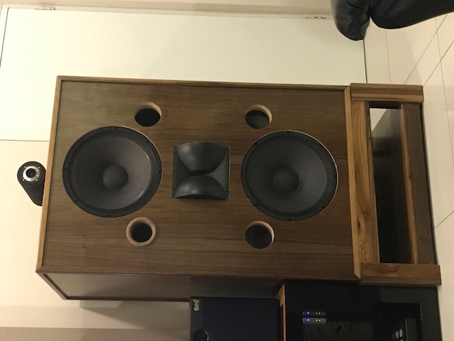

Hi guys. After a very long time, and many upgrades, I have finally managed to do impedance measurements. I am still running the beymas in parallel, but have fitted a larger horn, and am running jbl be435 berrylium compression drivers, crossing at 700hz with 24db LR slopes. Please check the impedance graph. Comments would be most welcome

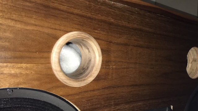

Just increased length of port to 125mm. Check the difference
The longer port length has moved your box tuning downwards from ( approx. ) 35hz to 30hz .I suspect you need to re-calibrate your impedance jig ( due to seeing a really low impedance load of about 2 ohms ).
