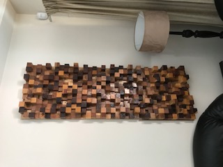

:The speakers are straight forward facing. On the one side, the room is open plan, and on the other, I have a 2mx1m diffuser panel, also built by me😀

Have other goods up as well. Still constructing more. Have a total of 10 square meters for my back wall. Thick velvet drapes, with acoustic backing on the one side wall, and 2 ceiling panels to handle points of first reflection. Not much for bass treatment though
The photo was just to show what I had made ��

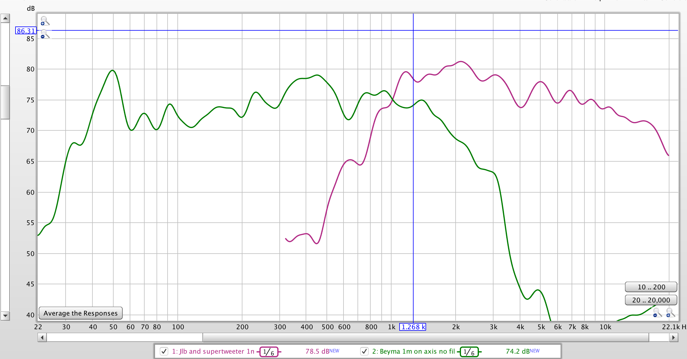

Hi Guys

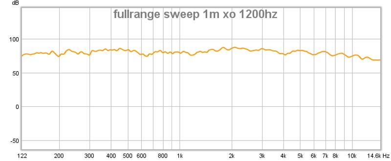

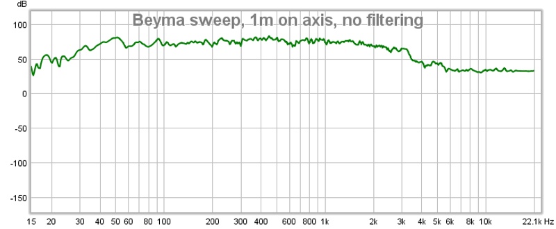

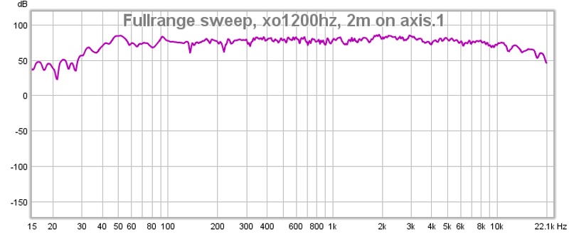

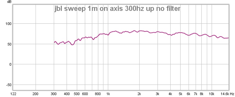

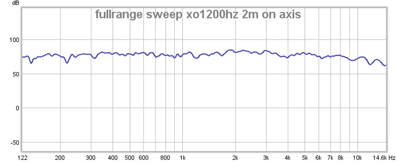

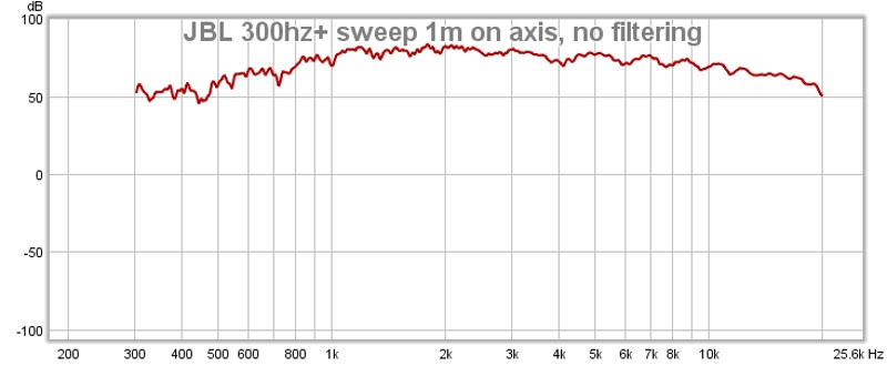

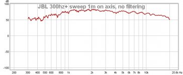

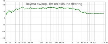

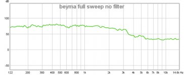

so I have been busy trying to get the measurements done more accurately.
The levels for all drivers were matched, and individual driver measurements were done with no filtering, as requested by a few. I made up the impedance measuring jig, but am battling with it. Can't seem so get it right yet. I will continue trying over the next week, but making me mad at the moment.
I see that portion of the measurements were cut off, try again, see attached
Brendan,
I would suggest NOT POSTING any more pics ( jpgs ) and only posting exported .txt files ( of each measurement made ).
Those pics are really quite useless.
You might as well let others post pics with meaningful vertical scales.
In REW, hoover to the left over the y-axis. 2 small magnifying glasses appear. Set the range for the "dB" to be 50 dB top-down.
You are just trying to make the curves nice by using 200 dB range 😉
As instructed, the measurements as text files
